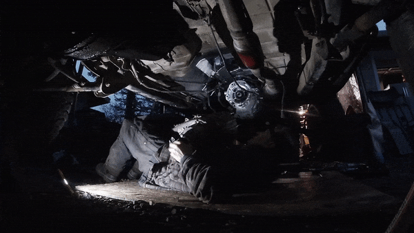

Well, I will say we trusted the shop here locally in Virginia Beach. I think he meant well, but didn’t do a good job of diagnosing. After replacing the transfer case and hearing the noise within 30 feet of driving,we put the rear end up on jackstands went underneath the Jeep put it in gear held the brake pedal and with my ear I am 99.9% sure it is the DC of the driveshaft

My guess is the pinion nut worked loose, tone ring has shifted and is now eating up the tail shaft housing.
I think this is what you were referring to. Everything seemed good there and we now know the case was not the issue. Bottom line is the real problem is using a “mechanic”. I’m afraid most are just parts replacers like myself and not good at diagnosis.

If it was working before, then the sensor died which is unlikely, you didn't plug it in, again unlikely, or the tone ring isn't turning. Did you remove the balancer and output shaft nut for any reason?
Ok. Missed this response but just found it. We did not remove the nut and or output shaft from either case.

A bit more than that. The tone ring has a slot in it that fits over a pin that sticks into a hole in the shaft on the front side of the ring. When it moves back, the pin falls out or gets misaligned, the nut gets tightened and it mangles the pin, mangles the tone ring, or the pin falls out completely and the tone ring doesn't turn. Some of them will tighten against the tone ring and turn it without the pin. I've seen several reports of it not turning even with the nut tight which is a dumb design.
If the tone ring is loose in the tail housing, you can't stop it from turning in 4 hi so it can possibly eat through the tail housing which can start pumping fluid out. Unless we know one way or another, I don't think I would risk it.
Pretty much exactly what happened to me a few years ago. I replaced the balancer on the t-case output shaft with a DC flange and in the process the tone ring moved enough to let the pin fall out. Everything was fine for a day or two then without warning it dumped fluid everywhere. Turned out the pin had managed to bind between the tone ring and housing and caused a bunch of cracks in the output housing.
