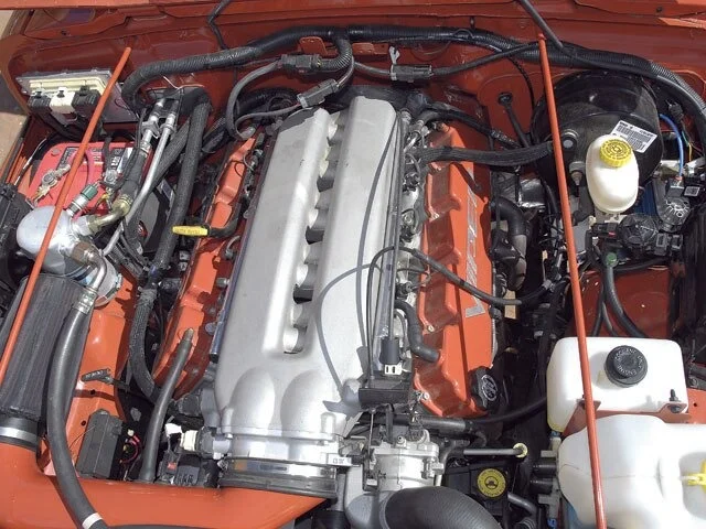

Or a Viper V10.
That is wild, with big engine swaps like this you gotta watch out for the drivers side exhaust manifold/header being in the way of the steering shafts/ rag joints.
Aren't 4BTs 300 pounds heavier than a 4.0? I would consider a diesel, but trying to tote that much added weight on a steep, difficult climb doesn't sound too appealing.

Unsure why a GM V6 would be considered. All that time and money to get the same power as a 4.0. While costing (again time and money) what a GM V8 would.
Cummins stated their 2.8 is smog legal up to 06. That was the point of their development. Designed for the TJ.
But to be honest if I was considering a new engine type under the hood I would get a YJ to start with. Basically eliminating all computer headaches and emissions concerns.
Money no object? The VW TDI is probably the best diesel choice. LS for a gas job.
The TDI seems to put out better than the Cummins with less weight and better mpg while still allowing parts availability at the local NAPA. Same with the LS. And getting parts should be considered when doing this.
Getting a CJ and either a Ford or Chevy small block would be high on the list. The classics belong together. It's too weird when I see an 80 year old man with his 20 year old wife!
