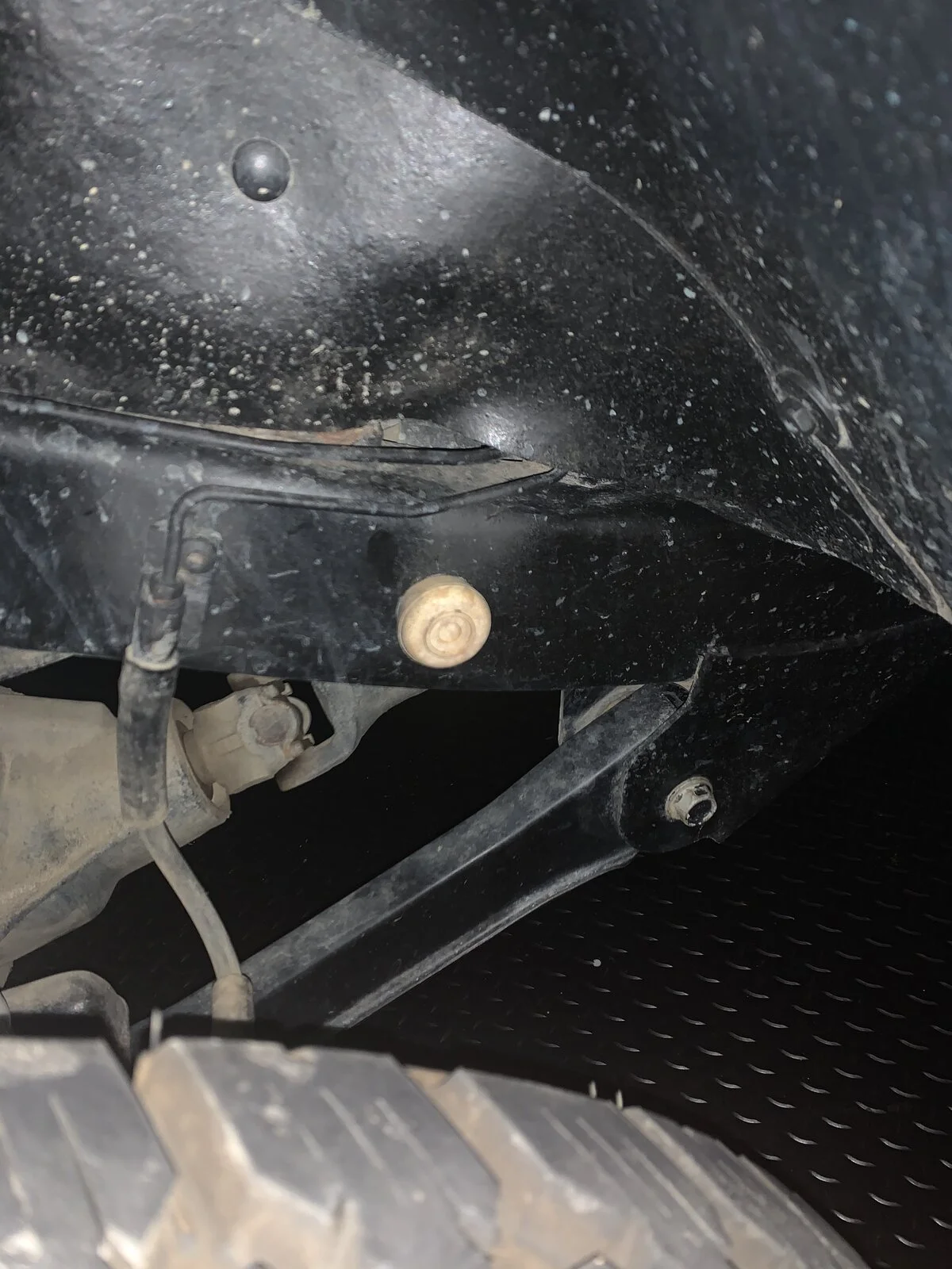

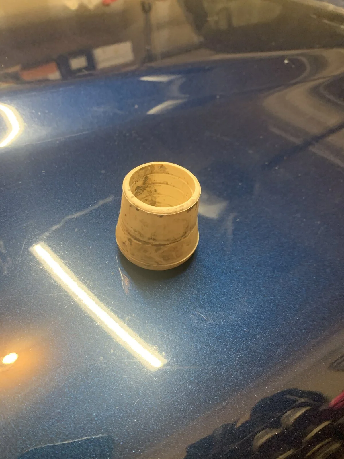

Buy a 4 pack of these rubber table feet things from Home Depot. They fit perfectly in the holes by the wheel wells. Can’t recall if they are the 1” or 1.25” ones
View attachment 197305View attachment 197306
I don't know what size that needs to be or what size I bought but I used a set of black ones to fill the holes above my front bump stops I think it took me about a week to get rid of all the water, mud and whatever plugged up the drains on those.

I rinse out my frame 2-3x a year. Those caps in the wheel wells can cut down the amount of mud and sand that my tires sling into the frame when I go off-road.
