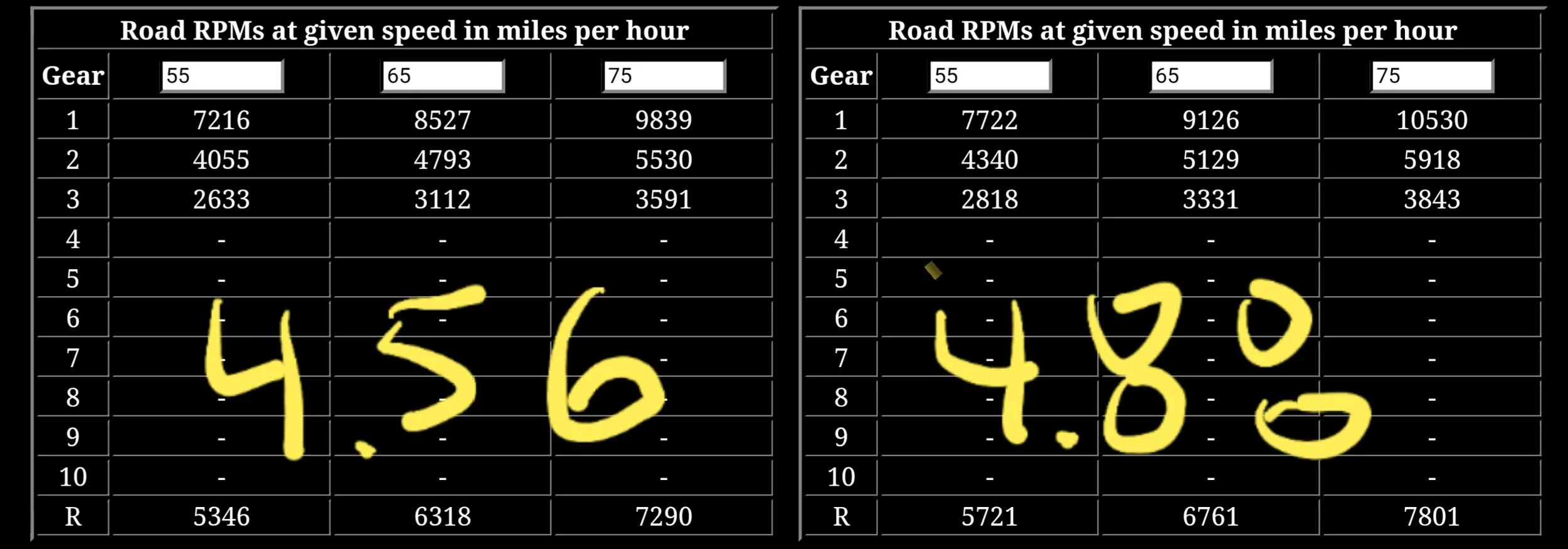

Ok. So after my acts in futility to squeeze all the ponies I can out of the 2.5L I finally concede defeat. I’ll say it. You were all right !!! Ok now that we have that behind us. I’m going to re gear. I’m seeing lots of conflicting posts so forgive my ignorance. I have the 1997 TJ with the 2.5L and 3 speed auto transmission with OD. I’m running 32” tires and will never go over 33’s. It rides the struggle bus hard on the highway. It barely maintains 60 mph and if I allow it to drop into OD it will scarcely maintain 50 mph. The burning question is do I go with 4.56’s or 4.88’s ? I only wanna do this once obviously. I’d like to be able to comfortably run 65 mph on the highway and be able to get out of my own way on the highway. I don’t give a damn about gas mileage. It’s not my daily. Any advice from seasoned guys here would be greatly appreciated!!!

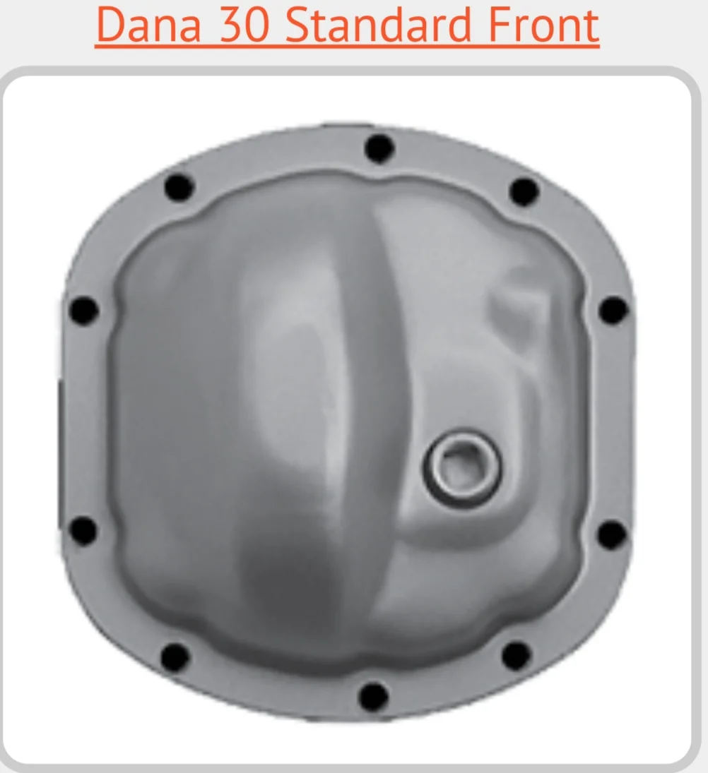

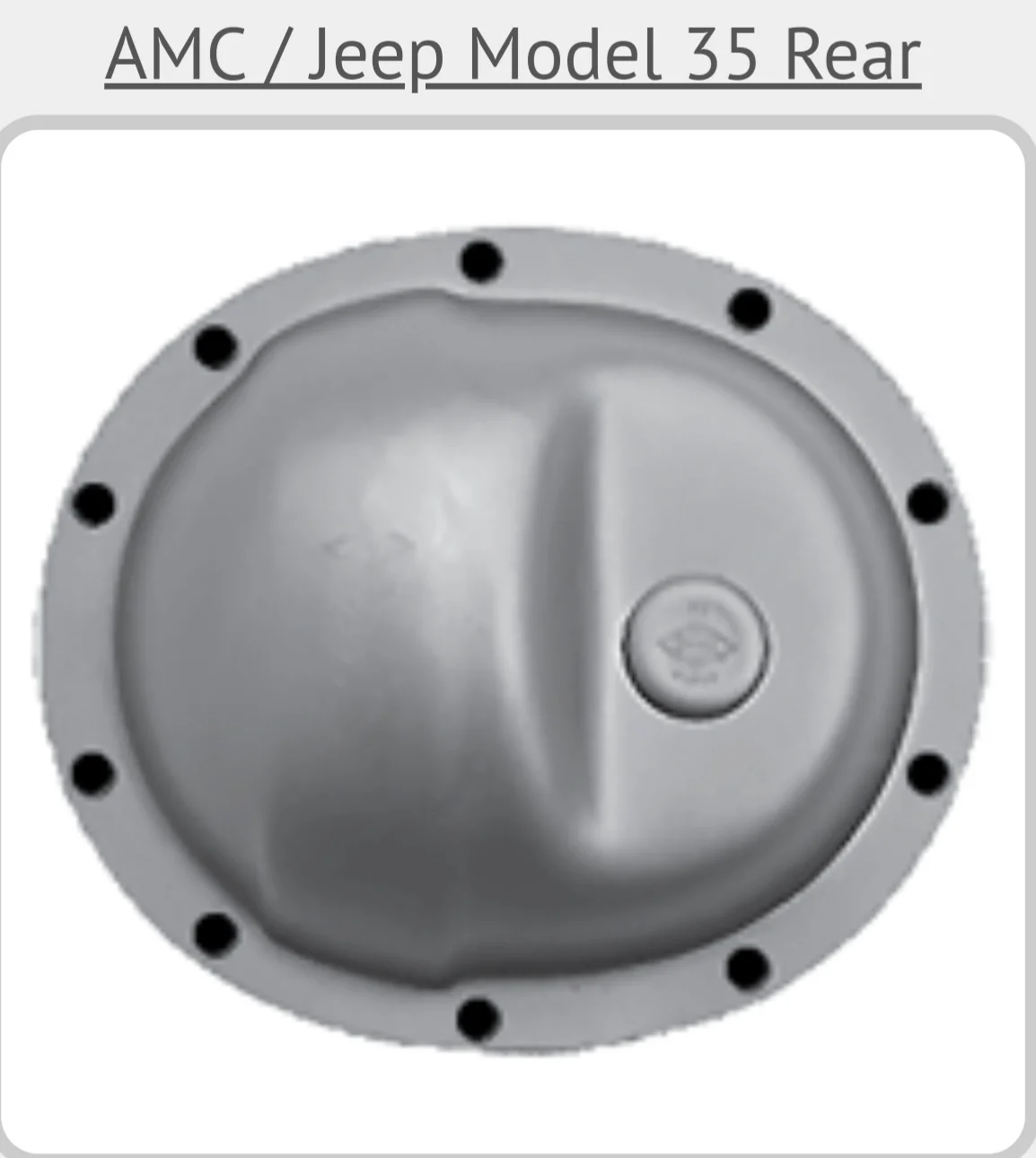

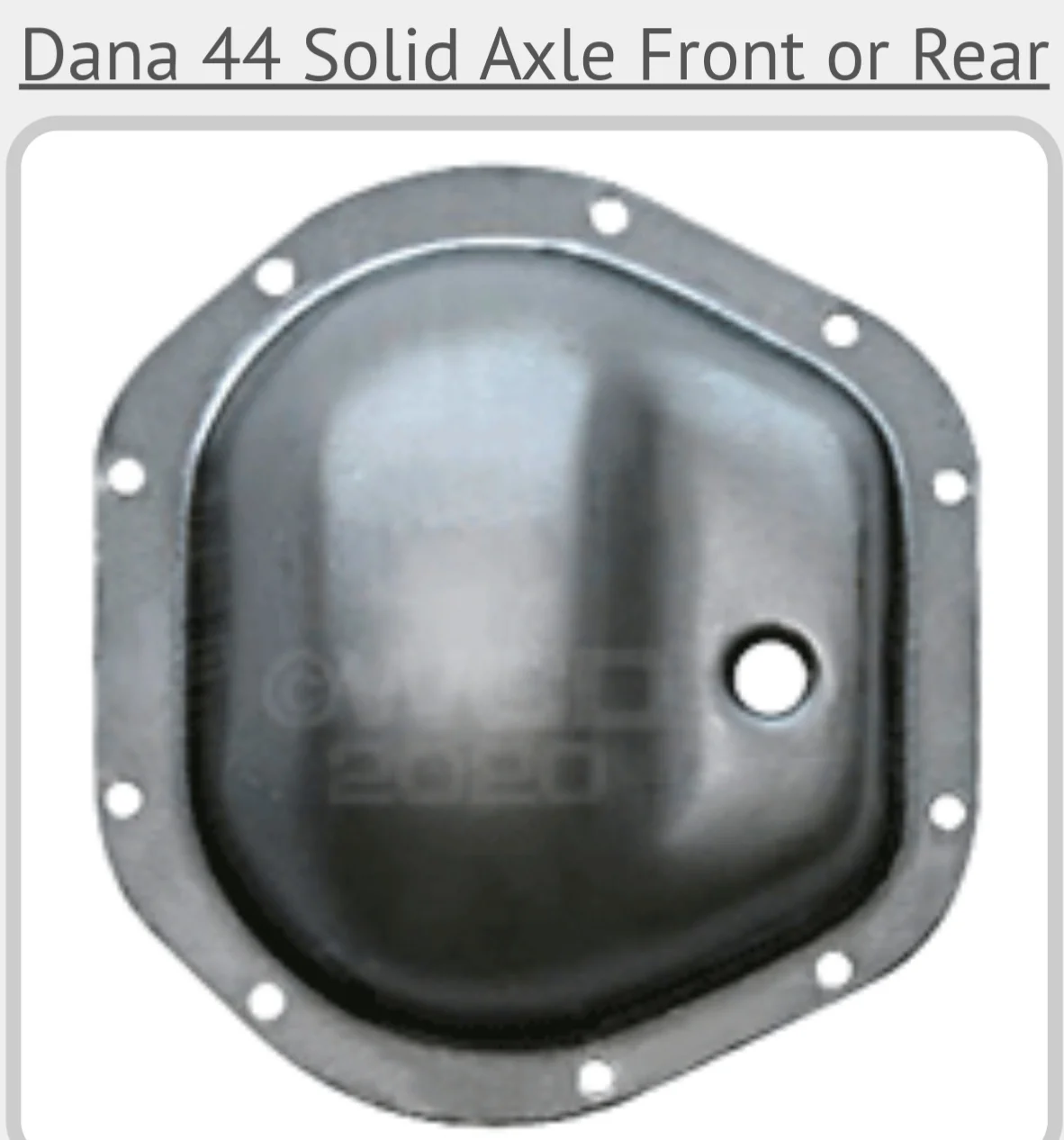

Also ! Do I have the Dana 30 and 35 front and rear diffs ? There are no tags at all on either diff. I’m assuming it’s the Dana 30/35 with 3.73 gears.
I'd go with 4.56 for your auto, even with a 4 cylinder. I had a 4.0, 32rh trans, 32s, with 4.56 gears and the rpms were too high IMO for highway cruising speeds. It's your choice.

My brother had 4.88 gears with the 2.5l/30rh on 33s. It wasn't a freeway cruiser but was just right for 2 lane 55mph rides.
It barely had enough power for 33s with that combo. If you are ever going to run 33s go with 4.88.

I ordered 4.56’s in Youkon brand. Went ahead and got the whole kit so I can do all the bearings and seals while I’m in there. I like the look and stance with the 32” tires so I think I’ll be happy since that’s the largest tire I will ever run. Today on the highway I was turning 2800ish at 60 mph but when the torque converter locked up and the RPMs dropped to 2200ish it immediately started to lose speed. So I think this gear set will be the answer to my prayers. I just want to be able to run and maintain 65 mph.
