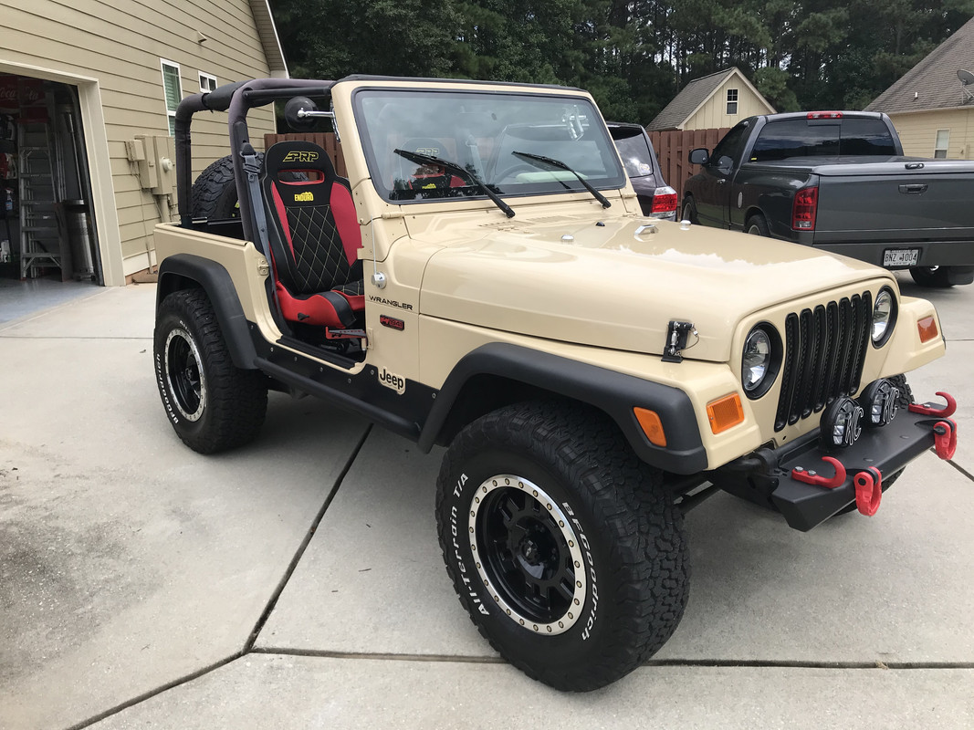

I ordered 4.56’s in Youkon brand. Went ahead and got the whole kit so I can do all the bearings and seals while I’m in there. I like the look and stance with the 32” tires so I think I’ll be happy since that’s the largest tire I will ever run. Today on the highway I was turning 2800ish at 60 mph but when the torque converter locked up and the RPMs dropped to 2200ish it immediately started to lose speed. So I think this gear set will be the answer to my prayers. I just want to be able to run and maintain 65 mph.
