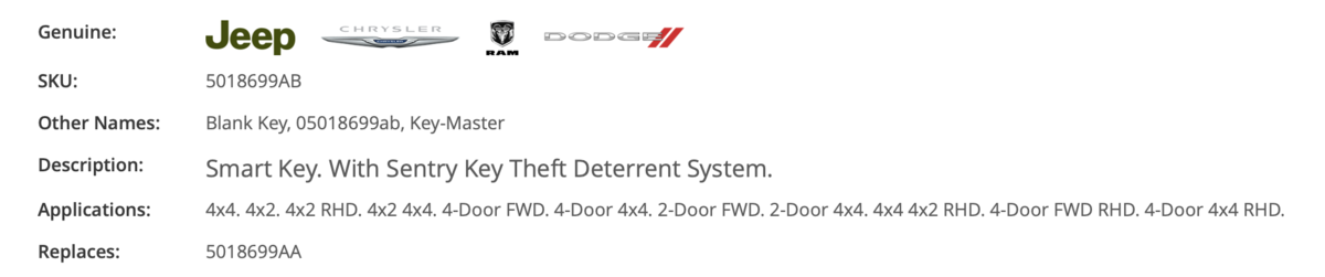

The part number you provided, 5018699AA, was supposably superseded by 5018699AB. (unverified)
So either:
a) the info that I got is incorrect and 5018699AB does NOT supersede 5018699AA...
or
b) Chrysler screwed up in packaging the keys that I ordered.
A better locksmith? The local locksmith provided me with a proper generic master key that works great.
So either:
or

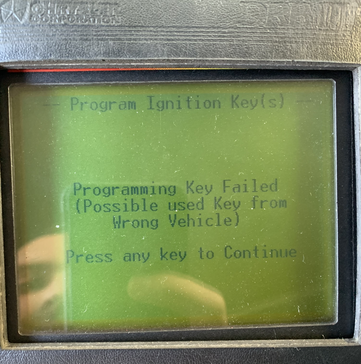

This crossed my mind too. I provided the blank keys in their sealed MOPAR bag, ordered from:
https://www.bamwholesaleparts.com/oem-parts/mopar-master-key-5018699ab
I was there the entire time the bag was opened, keys cut to my VIN code, and during the programming attempt. The keys never left my sight.
Maybe the keys are defective??? but all the keys of this type that I tried failed.
So, for anyone reading, don't buy the 5018699AB unless another member can confirm this part number works.
