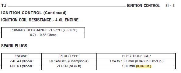

Page 8I-3 of the Factory Service Manual lists the acceptable spark plug gap range for the NGK ZFR5N spark plugs in the 4.0 engine as 0.30-0.35".
This is from the 2004 Jeep Factory Service Manual ...
