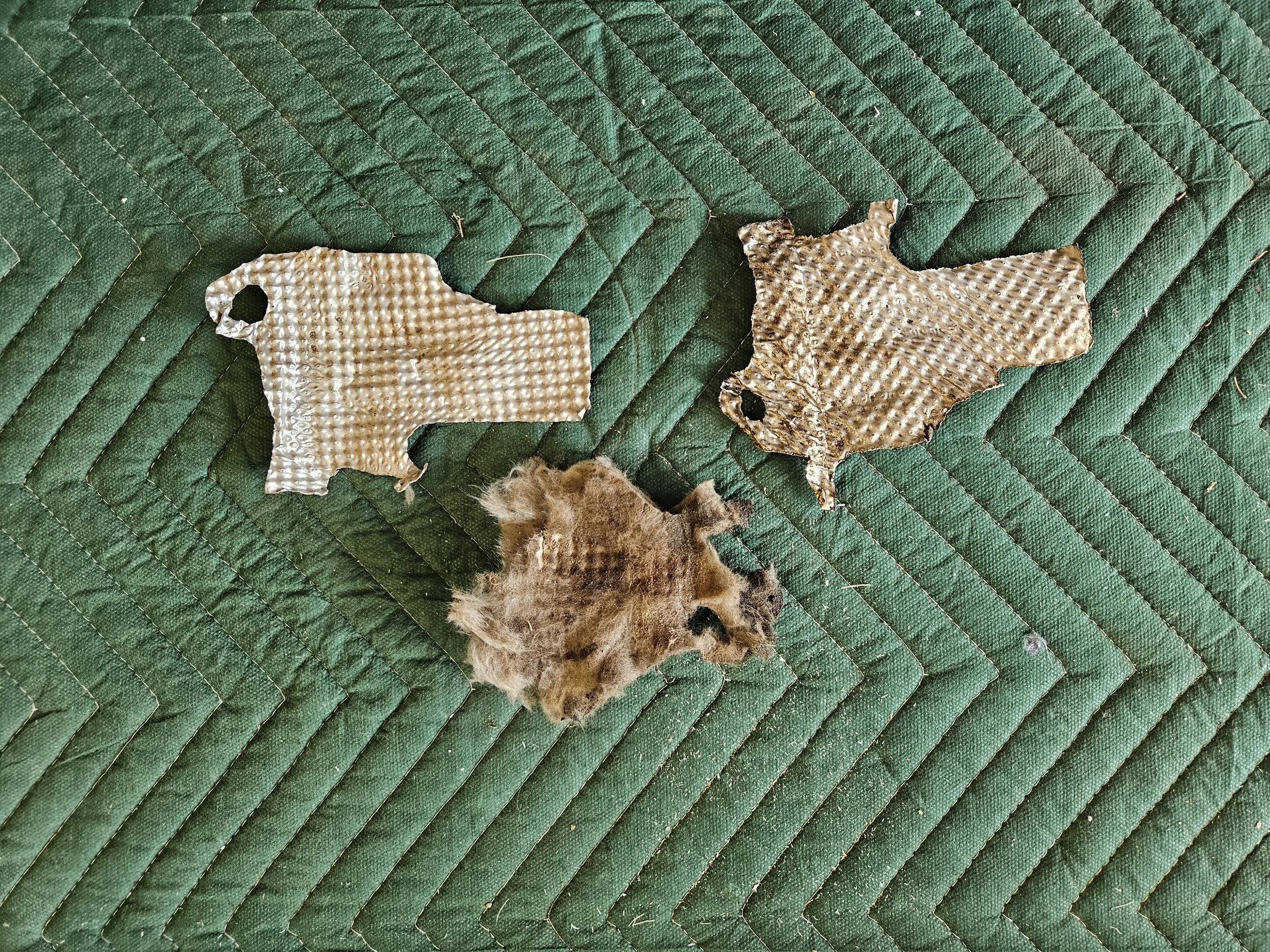

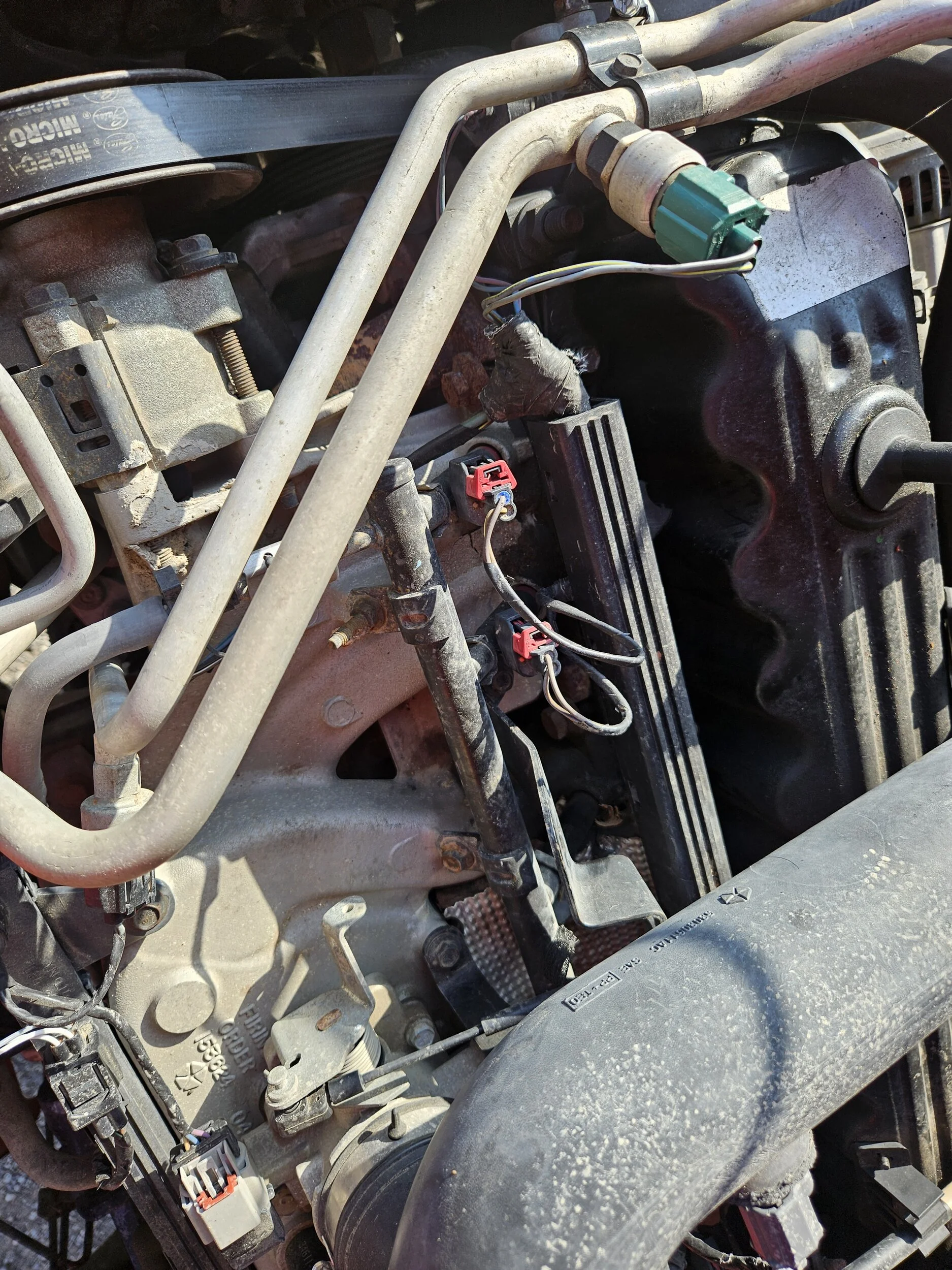

diggerwolf TJ Enthusiast Original poster Supporting Member Joined Oct 26, 2021 Messages 580 Location Van Alstyne, TX Mar 5, 2024 #1 A squirrel nested in my engine compartment. I cleaned it all out, and this, what appears to be thermal insulation, was separated. Is it something I should replace?
macleanflood I break sh!t Supporting Member Ride of the Month Winner Joined Jul 24, 2021 Messages 11,888 Location Fall Creek, OR Mar 5, 2024 #3 Part of your heat shield between the intake/exhaust and your injectiors. -Mac
JeepingNet TJ Enthusiast Lifetime Supporting Member Joined Sep 17, 2018 Messages 345 Location Saint John, NB, CA Mar 5, 2024 #4 It was put in to help with vapour lock in the later model Tjs. Not a bad idea to have it. I oddly just replaced mine yesterday. Its not a very pricey piece and while I had the intake off I decided to replace mine which had turned into mush. Reactions: Daryl
CharlesHS TJ Guru Supporting Member Lifetime Supporting Member Joined Mar 10, 2020 Messages 6,538 Location Jacksonville FL, Quezon Philippines Mar 5, 2024 #5 There are kits available online to replace that fuel injector shield. This is the one I found with a quick search. https://www.amazon.com/Design-Engineering-010378-Injector-1997-2004/dp/B015NOKWQY?tag=wranglerorg-20
JeepingNet TJ Enthusiast Lifetime Supporting Member Joined Sep 17, 2018 Messages 345 Location Saint John, NB, CA Mar 5, 2024 #6 Part number — 53013669AA https://www.rockauto.com/en/parts/mopar,53013669AA,heat+shield,914 Reactions: CharlesHS
jjvw AI Moderator Staff Member Supporting Member Ride of the Month Winner Joined Feb 17, 2018 Messages 31,039 Location Colorado, USA Mar 5, 2024 #7 That's the factory oil sponge. Reactions: RMETeeJay
CharlesHS TJ Guru Supporting Member Lifetime Supporting Member Joined Mar 10, 2020 Messages 6,538 Location Jacksonville FL, Quezon Philippines Mar 5, 2024 #8 JeepingNet said: Part number — 53013669AA https://www.rockauto.com/en/parts/mopar,53013669AA,heat+shield,914 Click to expand... If Rock Auto does not have that part available; check with Parts Geek who has that same part listed for $29.99 Www.partsgeek.com
bucky E CLAMPUS VITUS Supporting Member Joined Dec 25, 2020 Messages 2,789 Location SoCal/North Dakota/ N Az Mar 5, 2024 #9 You’re in high temp country. I replaced mine and put shields on the injectors also when I installed new injectors. Like others said it’s a cheap easy fix.
