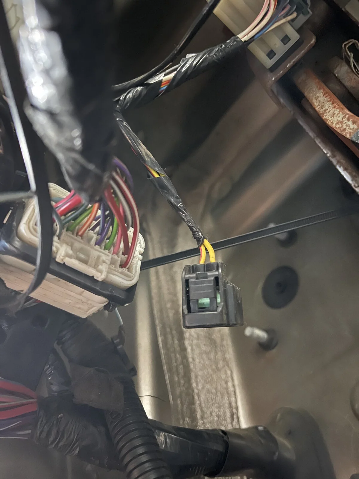

imactj2004 TJ Enthusiast Supporting Member Joined Nov 7, 2020 Messages 318 Location SF Bay Area May 1, 2023 #1 was chasing rattles beneath steering wheel and found this loose connector. Any ideas? OEM or aftermarket? This is near the back of the OBD harness.
0 03coloradowrangler TJ Addict Supporting Member Joined Jun 25, 2019 Messages 1,139 Location Mid Michigan May 1, 2023 #2 clutch pedal switch pigtail? Reactions: imactj2004
A AjRagno TJ Enthusiast Supporting Member Joined Dec 27, 2019 Messages 638 Location US May 1, 2023 #3 When you find unused connectors like this, it usually indicates an option or feature you do not have. This is the clutch pedal position switch connector. Reactions: imactj2004
