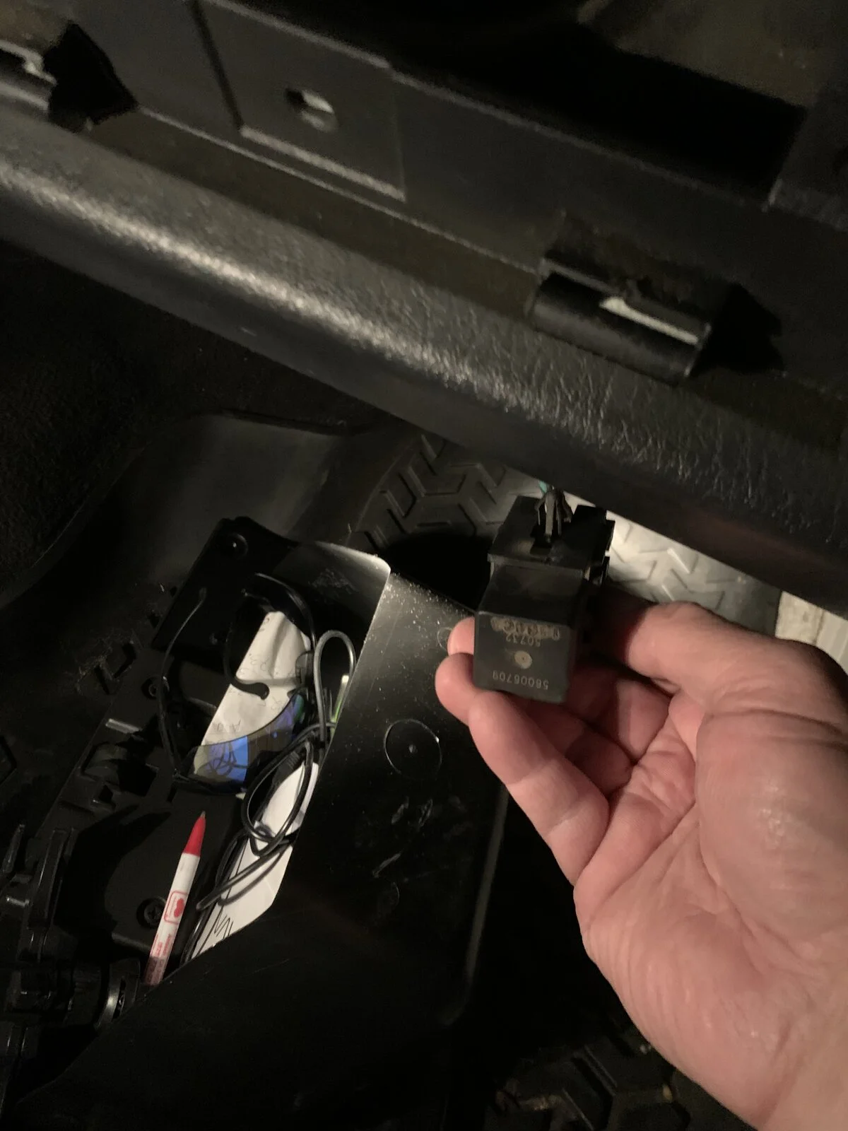

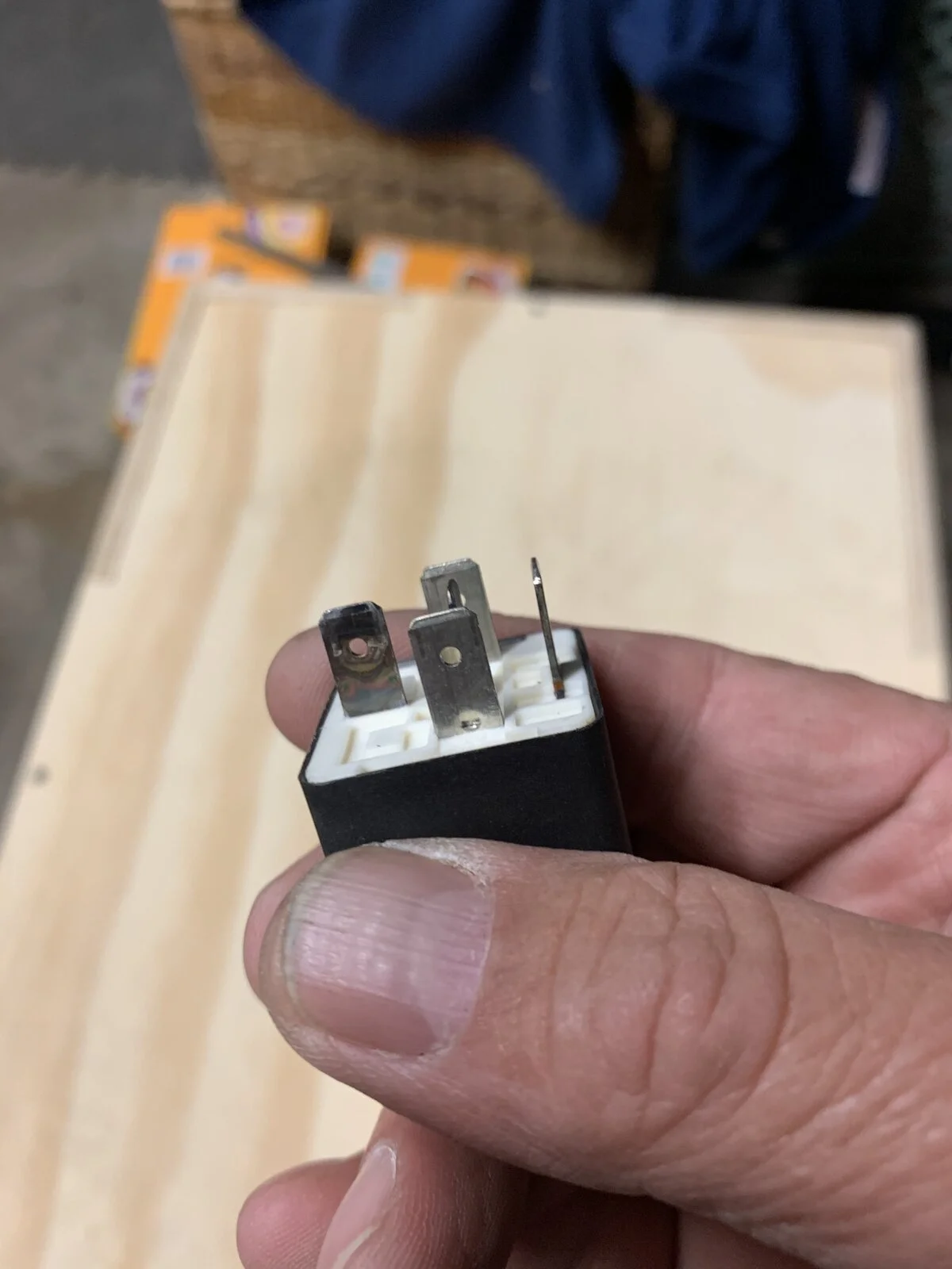

What’s this relay for directly under the glove box? It has 5 prongs and they look burnt. Is it any good ?

Someone added something that needed power. You need to follow the wires from pin 30 and pin 87 and see where they go. One will go to a power source (normally 30) and the other will go to whatever they are powering.

Well I know what that relay is for, it’s for the AC/Heater. I couldn’t follow the wires so I removed it and checked everything that could be operated electrically.
And lo and behold the AC & heater wouldn’t work. I replaced that relay back on then the AC/ Heater came back on.

I was able to figure out what that odd relay was for and it’s for the AC/Heater to work.

As for the relay terminal in the picture....
Was the female wiring connector in the relay harness loose ?
Loose connectors will cause heat build up OR if the load is drawing too many amps.
Do the harness wires show signs of overheating ?
I would check the condition of the fan motor speed resistor block elements and if the fan motor spins freely.
