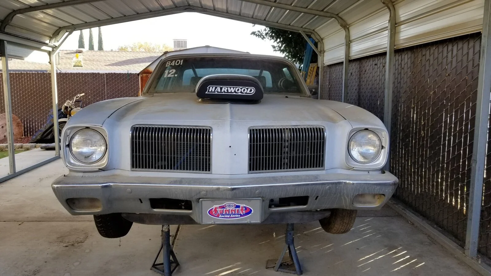

It's been a while since I've been around here much as I've gotten pretty involved in a past interest. A while back I did some figuring (poorly) and came to the conclusion that it was going to cost too much money to take the TJ to the next level, and that I should just leave well enough alone. I figured instead it would be cheaper to get the Oldsmobile back out with my dad and get it back on the road again. I think I could have the Jeep on tons and 40's at this point and we're not even back on the road yet. The nice thing though is my dad and I have both been buying parts for the car so progress is going a lot faster than I would have been able to do on the Jeep alone.

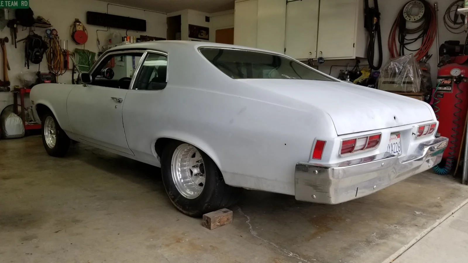

A little history of the car:

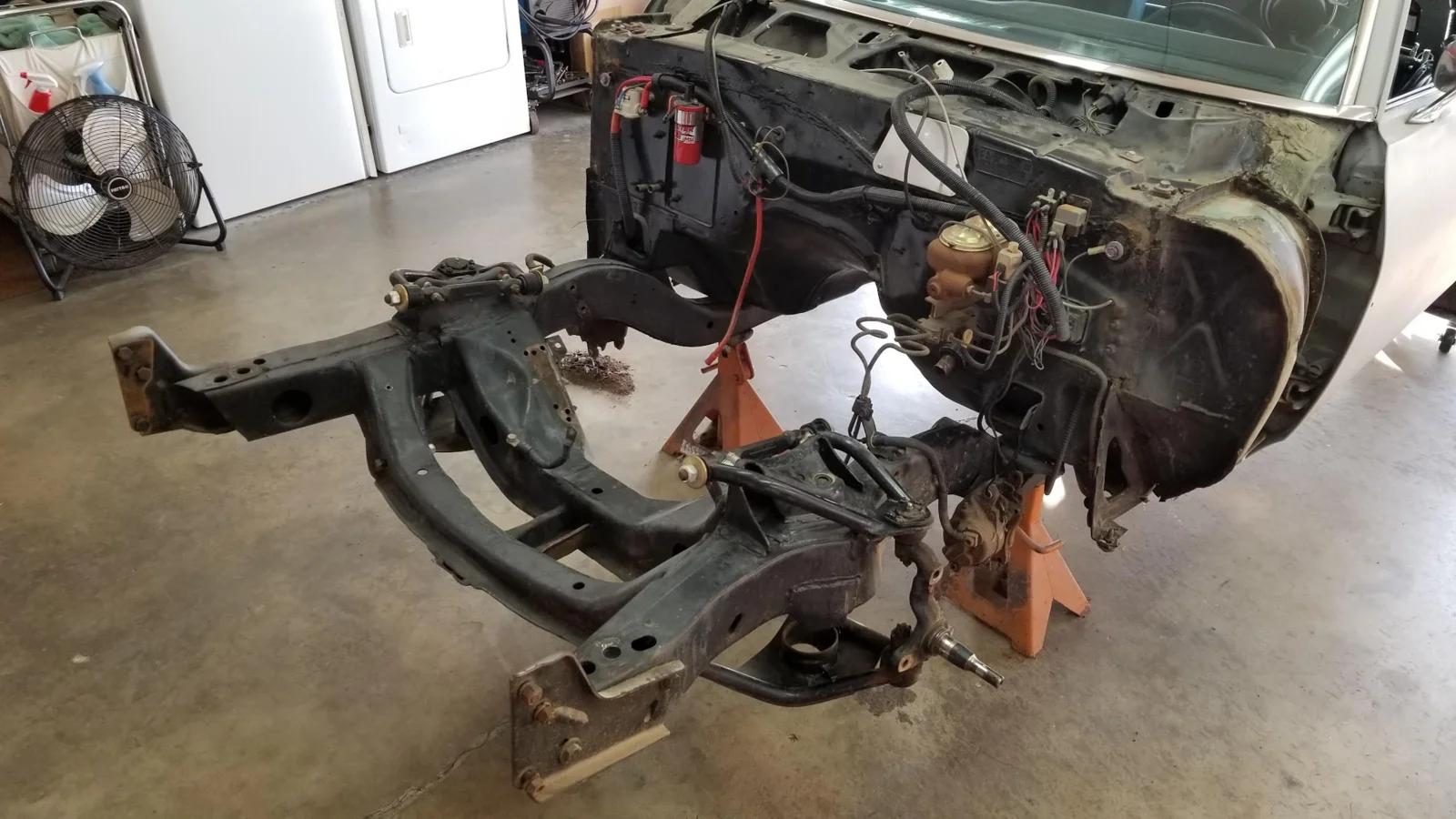

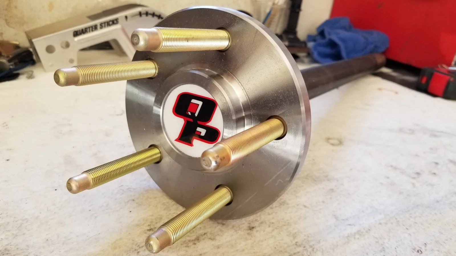

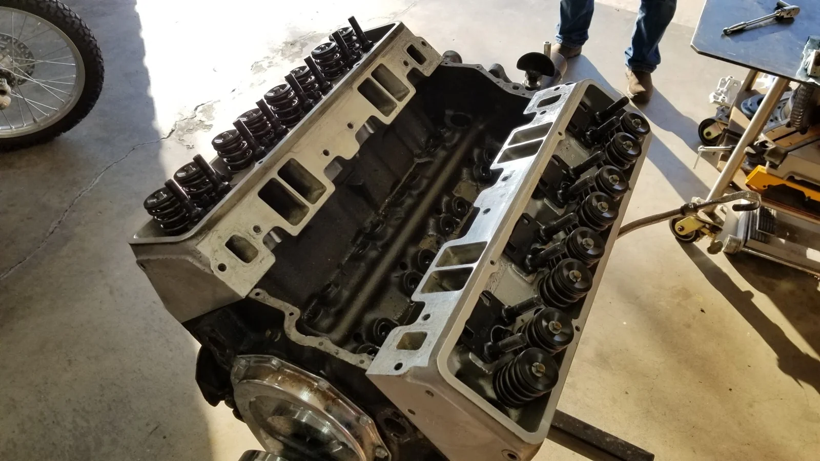

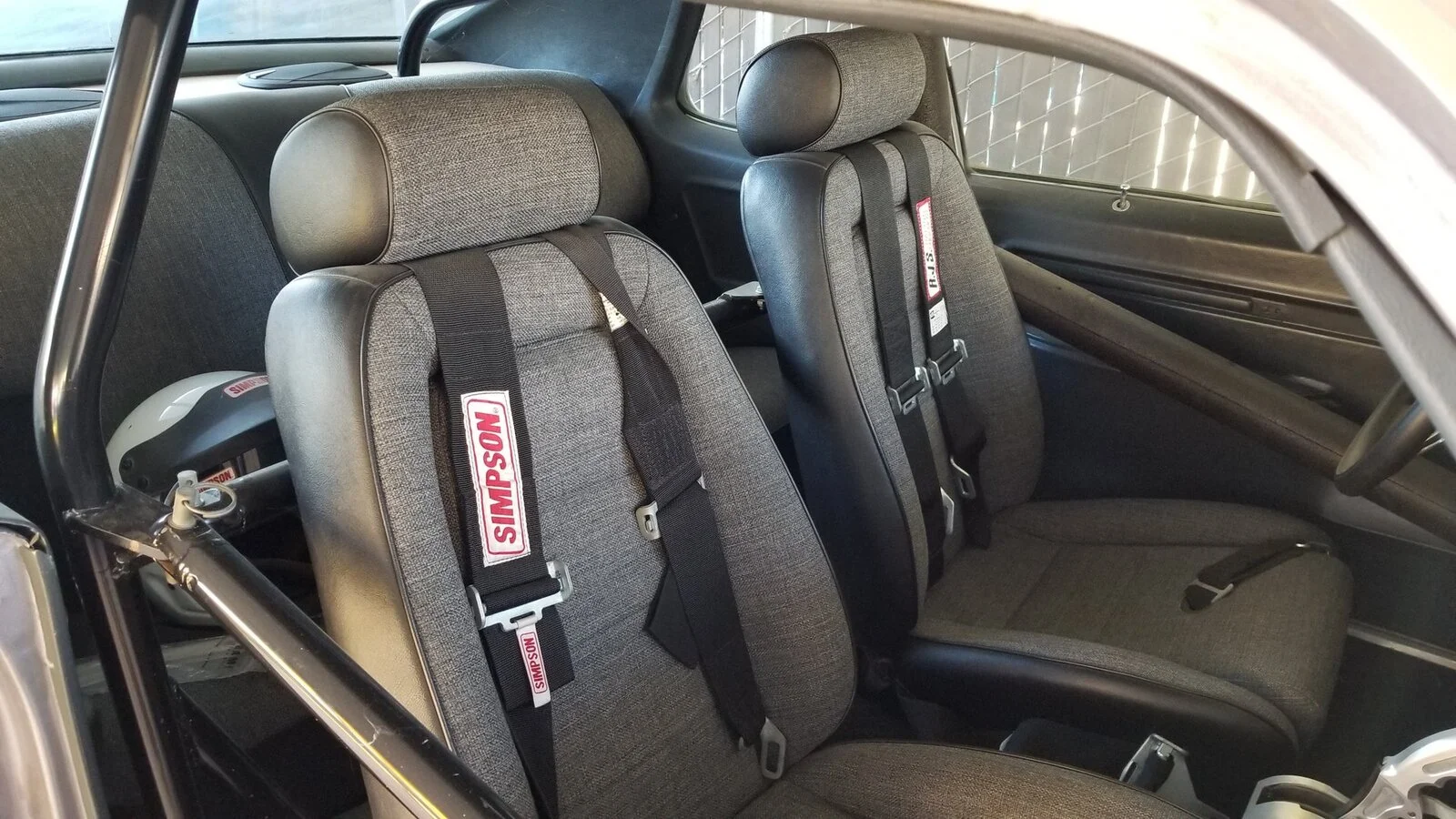

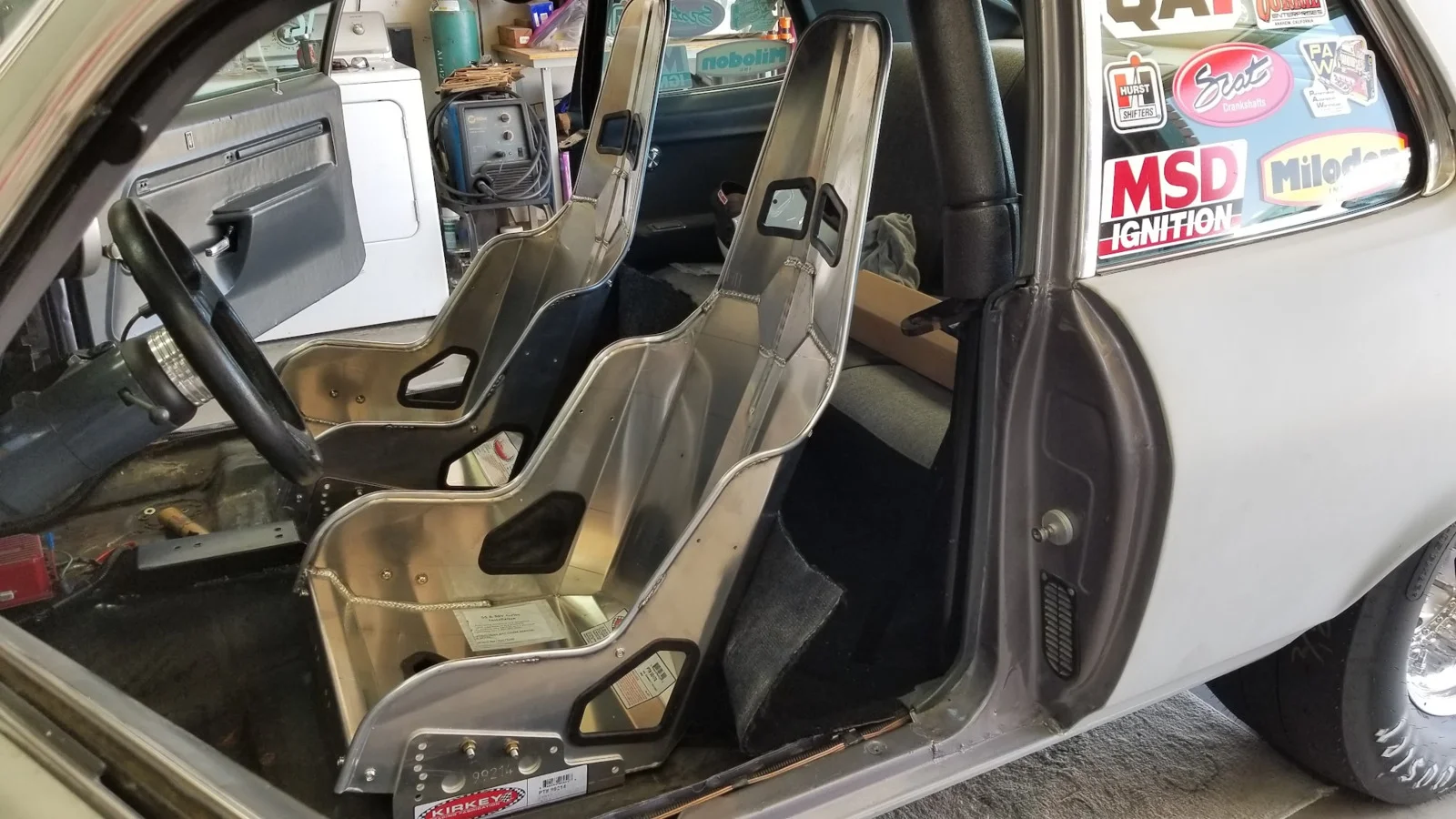

My dad and I started building the car around '99 to be my high school car. We bought it as a roller for $600 IIRC, sadly I don't have any pictures from back then other than a couple of it at the track after we got it running. After we brought the car home we stripped the interior, cleaned out all the mouse droppings and nests, repainted all the interior panels. We found some bucket seats in a ford car of some sort, they looked a lot like mustang buckets and got them reupholstered along with the rear seat. We cut the entire trunk floor out not because it was rusted but to mini-tub it and install subframe connectors and rear frame rails. My dad welded in a 6 pt roll bar and and bought a Currie narrowed 9" for the rear. We had a TH350 rebuilt and got a torque converter from a friend. We rebuilt a 4 bolt main SBC with flat top pistons, moderate flat tappet circle track cam, Edelbrock Victor Jr heads and super victor intake along with Holley 750. The carb didn't fit under the hood so we put a harwood scoop on it to make some room. After we got it on the ground my dad was unhappy with how wide the front wheels sat and bought a set of fat man fab narrow tube control arms. We were able to stuff a 13.50 tire in the back with skinny fronts on a Centerline Convo Pro wheels. We got the car running and ran the Summit series races for a couple seasons at our Local track (Famoso raceway). After I went off to college the car mostly sat around my dad driving it from time to time and we got it out for the March Meets at Famoso one more time while I was in college. After that it spent a lot more time in the garage until I took it for its final cruise that killed the poor little TH350, second gear died in some manner and it got parked in the back yard. That brings us to a while back when we pulled the disintegrating car cover off of it.
