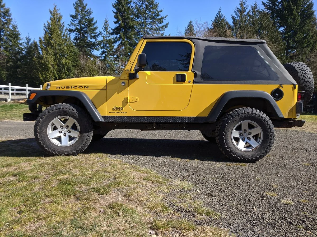

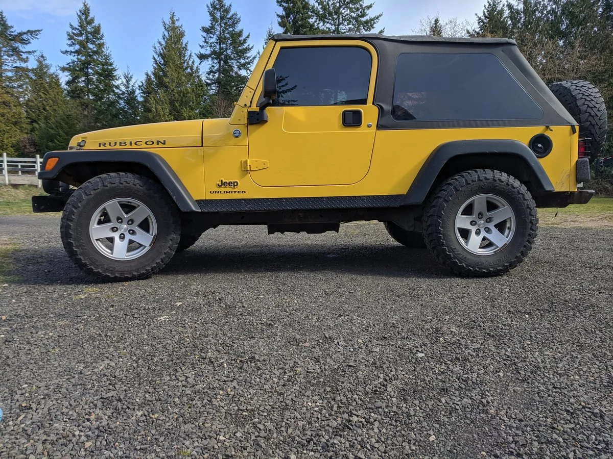

Attached are my before and after photos of the tummy tuck
1. I ran around like this for a few weeks, it’s way nicer being regraded but you will be able to still have fun until you are able to get it done.

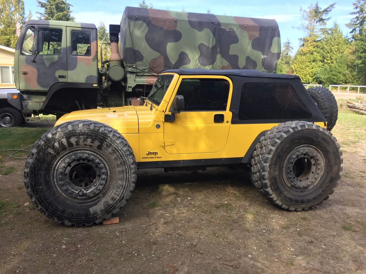

yes I messed up big there, and take full responsability for my actions. Currently locked up in quarantine as a result. I call this my little truck as it's one inch shorter than my Ram 3500 crew cab long bed. And so i parked it in compact car parking here.
Also i can't tell for sure but I think these tires should go on without rubbing. they are dual beadlocks, and have run flats. Should be a simple bolt on i'm sure.
