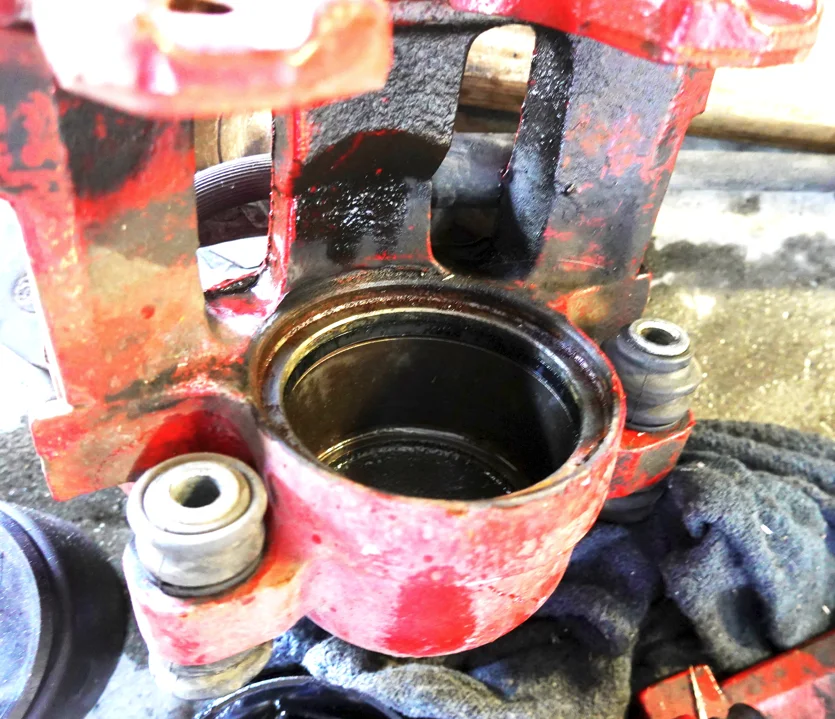

Ya'll really need to quit using powder coated calipers. They can't coat around where the dust boot seats so they start rusting in that groove, the rust pushes the dust boot into the piston and causes it to stick. Always just get plated stuff, not powder coated.
