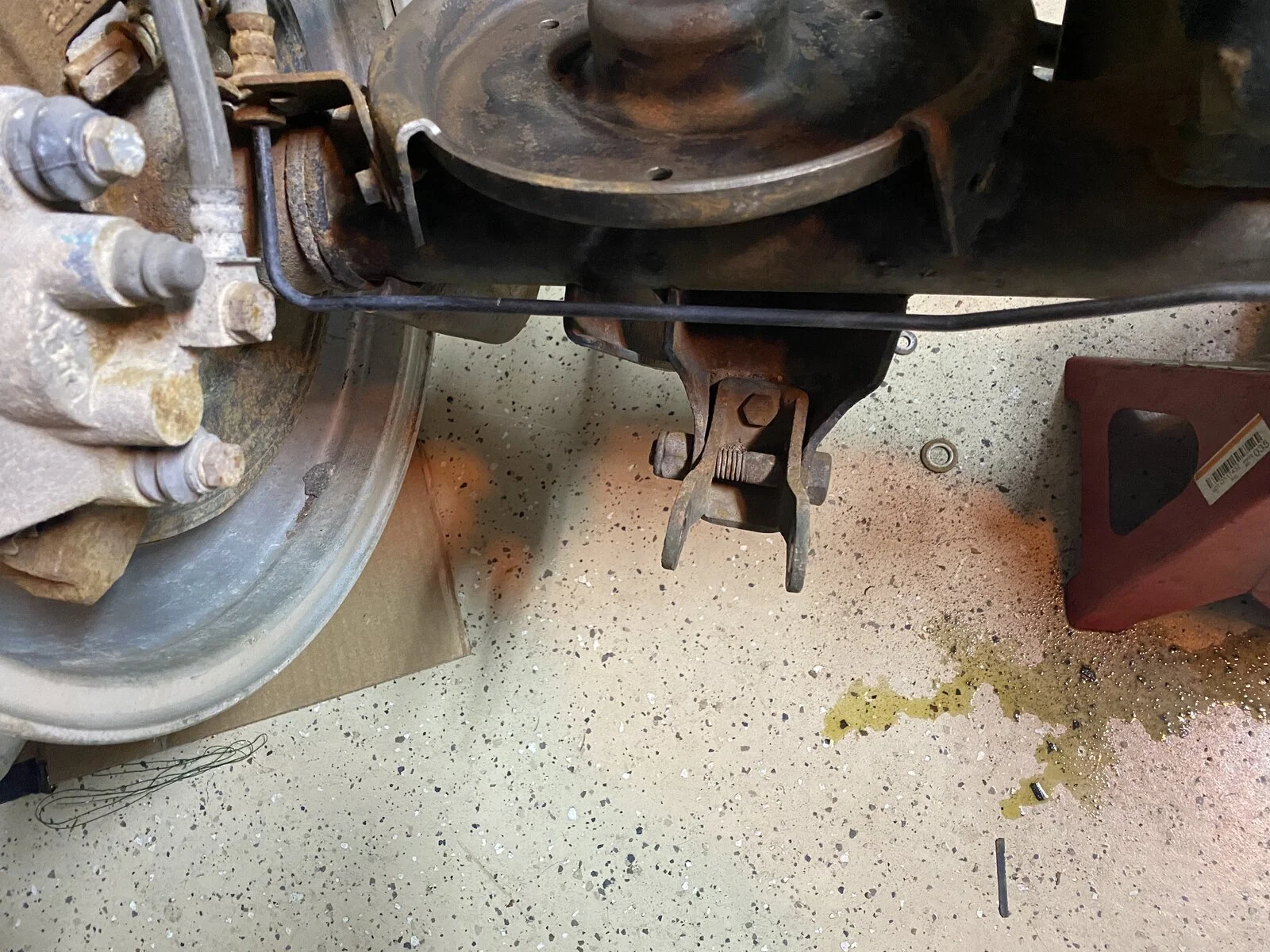

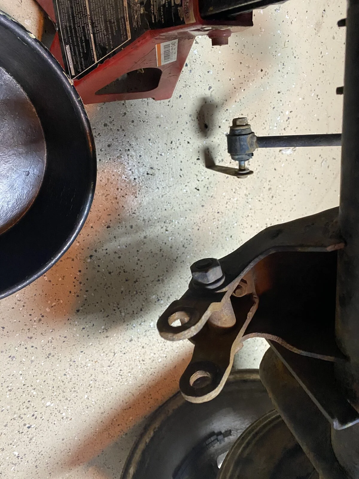

Another question - the 44 I’m prepping to go looks like it already has brackets for the lower rear shock. Are these factory? Look like they’ve been there awhile.
No those are aftermarket, used to keep the shock from hitting the lower spring perch.
Thanks, I wasn't sure because they have the same patina as the rest of the axle & I didn't see the Jeep this thing came out of.
