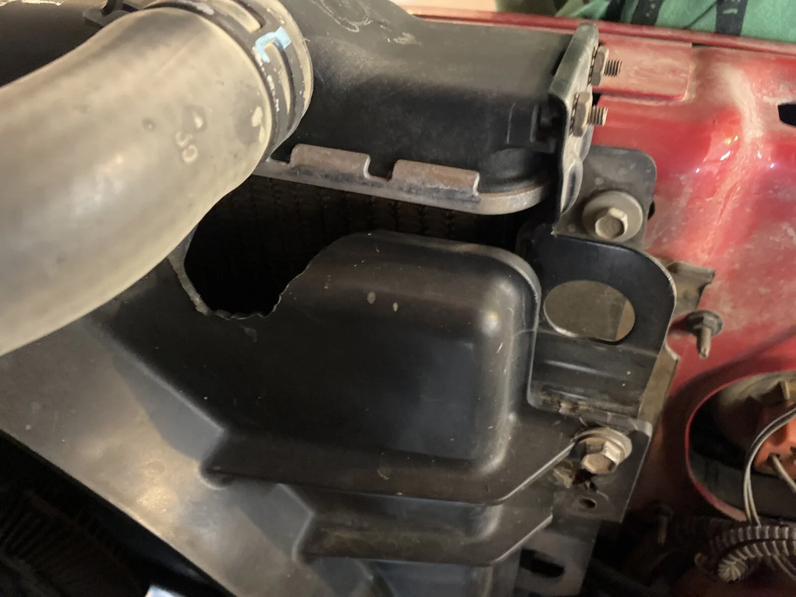

seems like after the lift, MML is the way to go rather than xfer case drop? only thing i have to worry about is the fan shrouD?
Yeah, you can see where I had to trim mine to raise it 1”.
Do a BL at the same time or buy the fan shroud relocation brackets.
i see, i'll prolly drill new hole since its free mod haha ty all kindly for chiming in to get me set up.

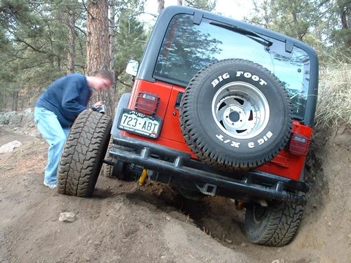

I see the opposite, with Dana 35 axles crapping out making U-turns in a Walmart parking lot. NOBODY wants you in front of them on a tight trail when you explode your turdy5. I would just flip you off for being a dumbass and keep
going. If I couldn't get around you I would drag you off the trail, even if you didn't ask me too.
View attachment 193807.
You sound like a guy that nobody needs to go wheeling with. Not everyone that bought a Jeep and goes offroad with it knows the weaknesses of the Dana 35 until it explodes. I'm pretty sure/hoping you were being hyperbolic when you say you'd flip them off and drag them off the trail wanted or not. The guys I go on trails with would stop to try to help.
