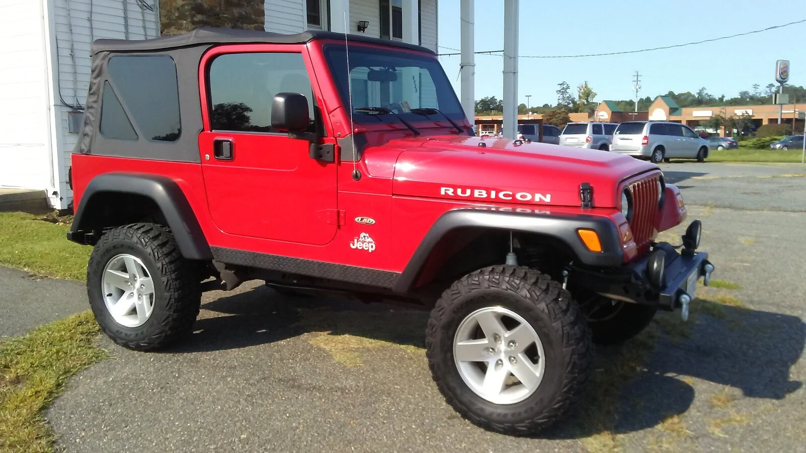

I had 31s with a 4" lift for a few hours.

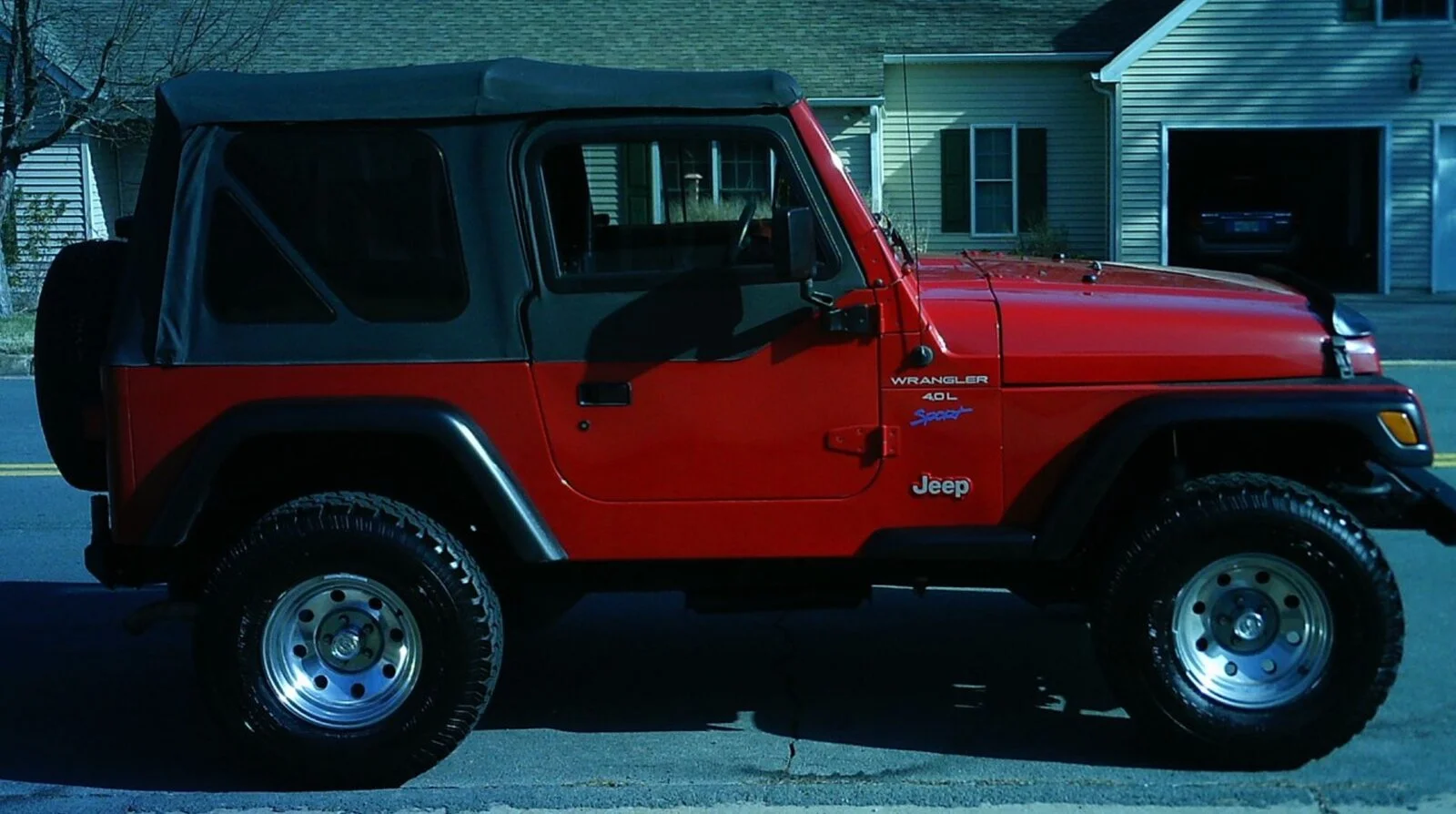

Tires for 16" wheels are usually E rated, stiff riding and cost more. Why not stick with your 15" wheels?
p.s. I had 32s on my old 98'.

They'll fit, but might rub without some wheel spacers. I've always used wheel spacers with stock wheels.
spacers probably reduce rollover risk ... although by the time you pay for spacers, may as well get wheels.
what wheels are those on your 98? i love that look.
