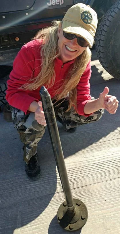

This is what happened to a friend while we were wheeling together, she was running 35's on her stock Dana 35. It took some time to get her back to camp and then someone had to drive at least 100 miles to bring a replacement axle shaft which we installed that night so she could drive home the next day.
