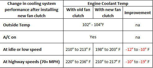

I've been closely following threads like this. I've never been happy with the fact that when the outside temp was above 60° F and at sustained highway speeds, my needle would move to the right edge of the zero in the 210 label on the gauge.
The radiator, hoses, water pump, thermostat, and radiator cap were all replaced new when a new long block was installed two years ago. Temperatures were not erratic, indicating neither a bad sensor nor air in the system. I'm running a Stant 18lb radiator cap, but swapping caps made no difference. Coolant is fresh and of the proper type and 50/50 mix. Coolant level was stable in the bottle with no boiling or gurgling when hot. The only thing that wasn't new was the fan clutch. When I would slow down, the needle would fall down to the center mark, so I assumed the fan clutch was working as it should. It wasn't overheating, just running hotter than maybe it should.
However, the repeated statements by many here that a properly functioning system should keep the needle close to the center mark bugged me, so I bought an OBDII reader and downloaded the Torque OBD app and started monitoring.
In checking the dash gauge to the reality of what the sensor was reporting through the OBD, what I found was that the temperature range indicated by the my dash gauge is about 195° F when the needle is on the left edge of the "2" and was at about 230° F when the needle was at the right edge of the "0". Needle dead center is 212° F.
Then I kept reading @Jerry Bransford posts where he recommends trying to spin the fan when the engine is hot (but not running!) OK, I could move it pretty easily, but it didn't "spin." So I checked it with the engine cold and found about the same resistance to movement. Concluding that this probably just wasn't right, I bought a new fan clutch and spent 45 minutes changing it.
What a difference.
The temp gauge needle now rarely moves above dead center unless I'm hauling it down the highway in really hot temps. I went off-roading the day I changed the fan clutch and the needle never even got to center point even though it was all slow-crawling and idling in 102° F heat.

Glad you posted this, some people claim a bad fan clutch has no effect on the highway and obviously in your case it did. In fact at highways speeds it seems to have had a larger impact on temperature.
I puzzled through that with the clue being there should be significant resistance to spinning the fan by hand when the engine is hot. That makes me think that when it's in early stages of failure, it free-wheels just enough to affect both the slow and highway speeds some, while highway-speed air flowing through the radiator is still able to keep the engine from over heating. If it was worse, I'm sure there would have been over heating at idle or when going slow.

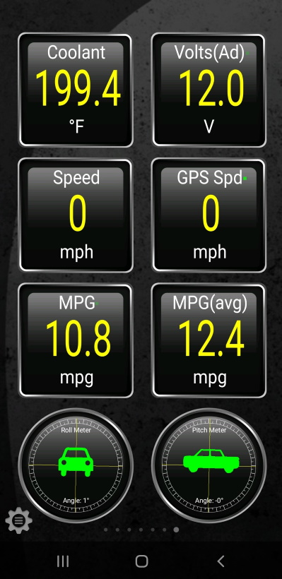

Screenshot sitting in the drive after a 12 mile run up the interstate at 75 mph. I live less than a mile from where I get off the highway. It dropped from it's high of 213.8 to this temp in that distance. Outside temp is 91 F.
