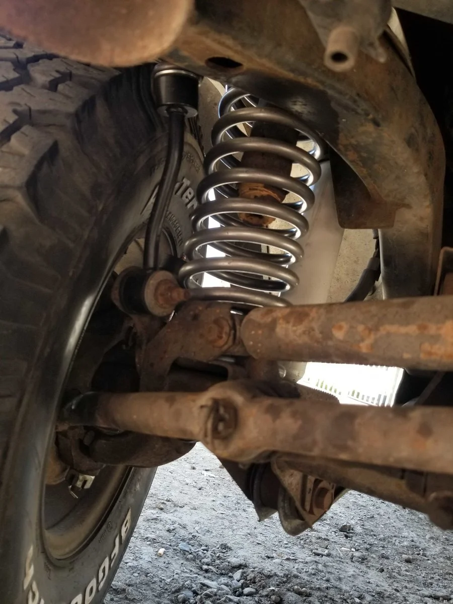

What are the tires rubbing? If it's the suspension, you could probably get away with a washer or two on the steering stops.
If it's the body, you got something else going on.

The washers are fine. They simply reduce how far the wheels can turn left or right by a few degrees. Only difference is your turning radius will increase slightly, probably not even enough to notice.
What would be unsafe is removing the steering stops altogether to decrease turning radius.

The wheels are stock as far as I am aware... Here's a picture of where the tire rubs the swaybar link
