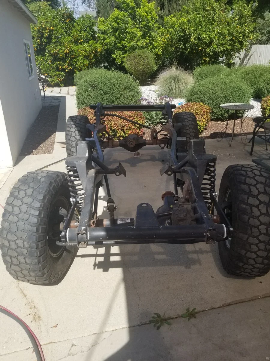

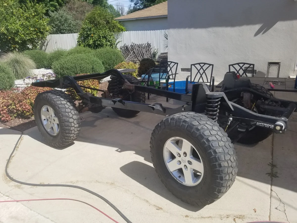

I'm starting a scratch build that will be a TJ from the frame down. The body will be the CJ-6 in my avatar picture. I'd like to know some opinions on modifications and upgrades that maybe you went half way the first time around, spent the $$, then realized you should have gone with $$$$ dollar part, or even the extra man hours to get right. Budget is a concern so if like to follow the 90%/10% rule. Also things that will be way easier working on without the body on the frame. Goal is a reliable Jeep to take the family camping, fishing and run the Rubicon with minimal chance of breakage. It will not be a daily driver, but needs to be able to be highway stable for trips from LA to Sacramento/Rubicon.
Current build/parts list include:
HP 30, 8.8 combo. ARB in both
Currie 4 inch with Antirock
Rancho 5000x ?
2014+ gm 4.3 and 6l80, NV 241
35 inch tire 4.5" back spacing.
101"-103" wheelbase
I picked up a rolling chassis with Currie 4 inch lift for a great deal which is in the pictures.
That about covers stage 1. I want to run that for awhile and consider the Savvy mid arm later. I'm looking to maximize stage 1 though.
Any thoughts, opinions, tips and tricks are welcome.
