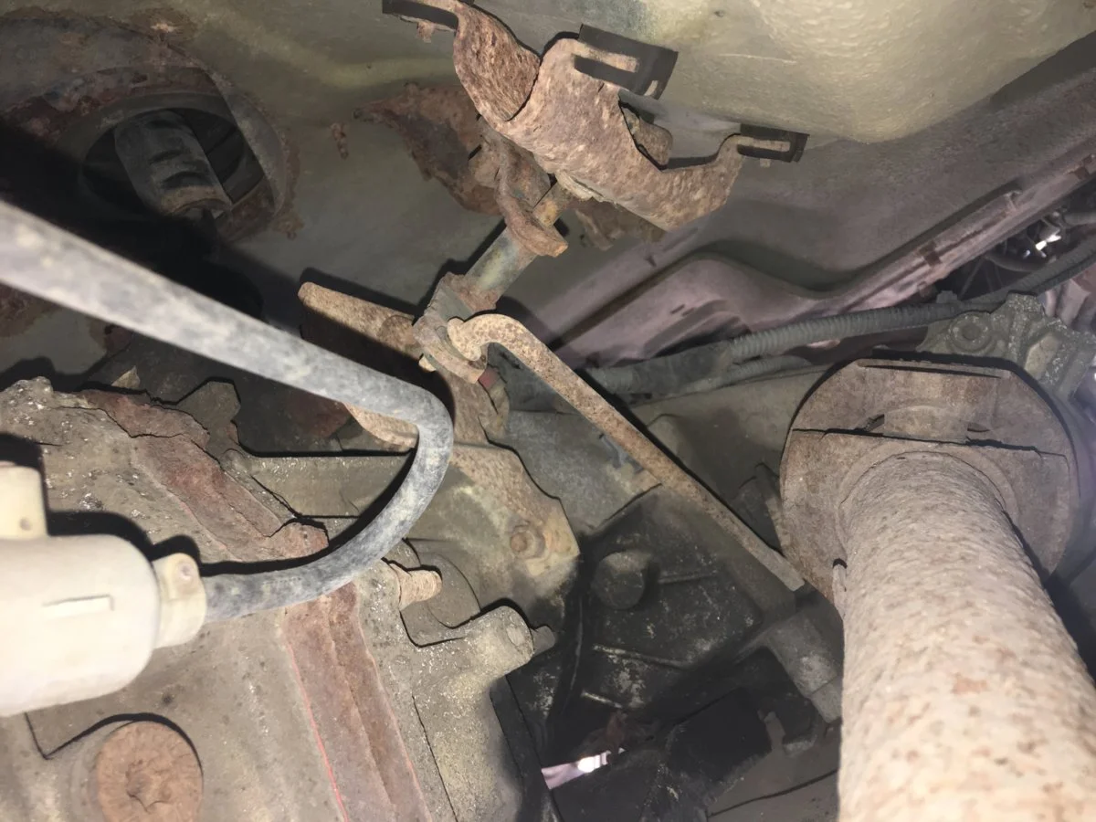

second, will the transfer case cable replace the linkage in the pic?

And yes as for your question about the T-case shifter cable. It replaces the OEM linkage completely. Most here will recommend Savvy. There is another common shifter cable as well, but I can’t remember the manufacturer name. It is very similar to the Savvy cable shifter.

Novak also makes a shifter cable. That's what I have in my TJ. Works way better than the linkage setup.

The Savvy cable shifter is a huge upgrade from that rattletrap monstrosity of rods and plastic bushings some 'engineer' @ Jeep dreamed up while smoking pot. And I'd rank the Spiderwebshade or equivalent up near the top of the must have list, right next to GraBar grab handles, things every Jeeper would get a lot of use out of.
