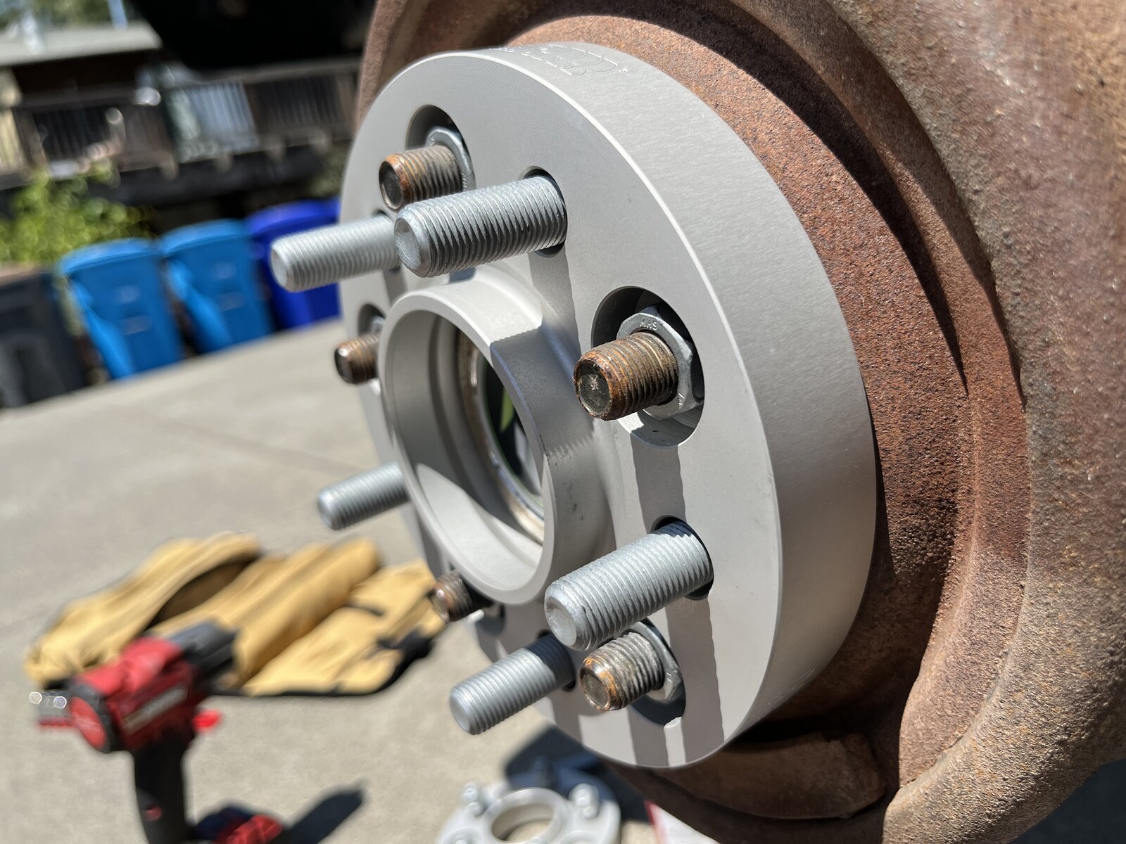

Since I recently switched to Moab wheels I began looking for thinner spacers (was using Spidertrax 1.25in). After some searching (turns out there are few options thinner than 1.25) I bought a set of titan 1” spacers for $114 and change for all four.

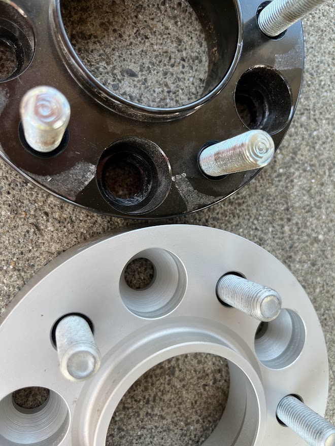

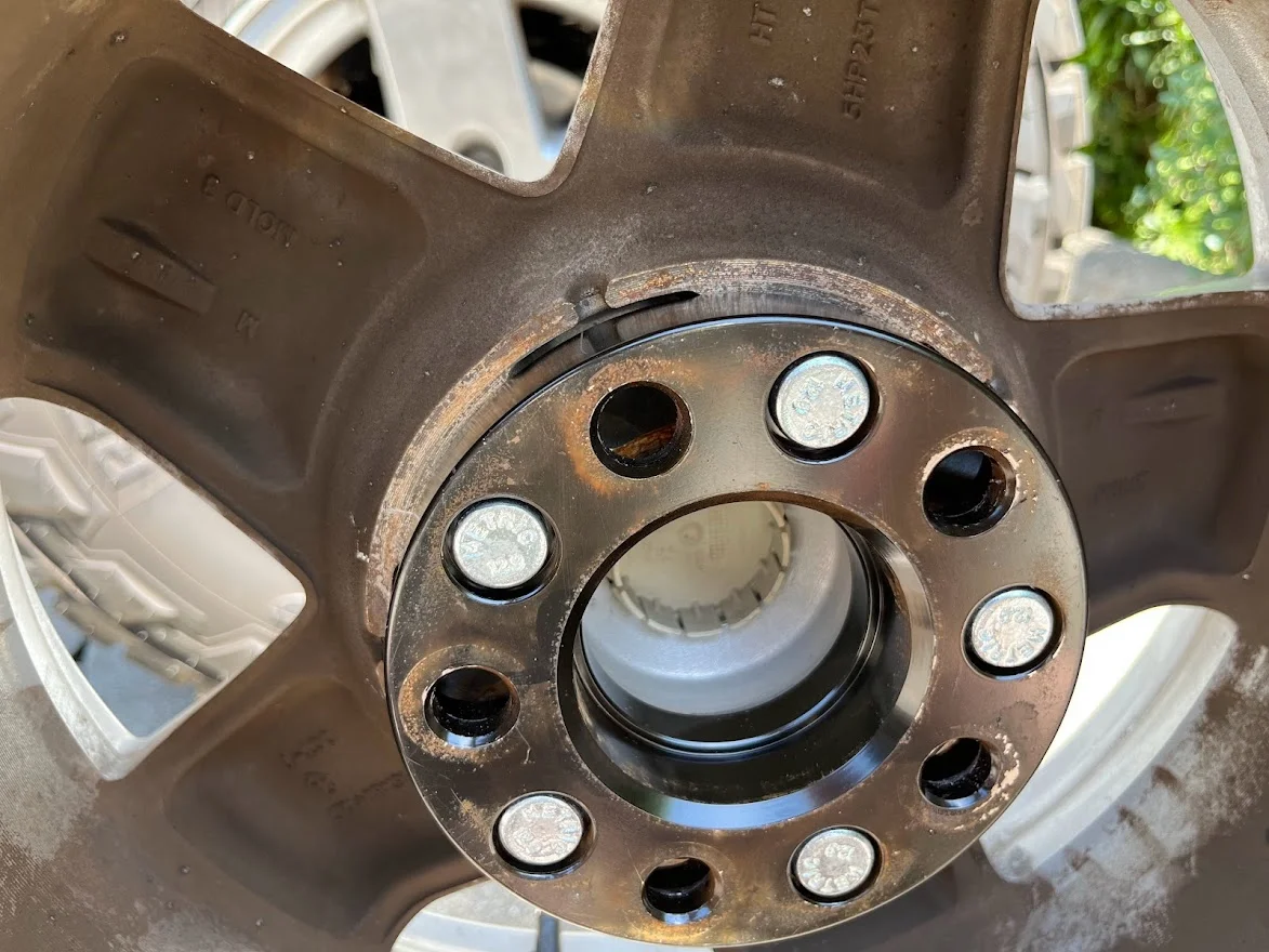

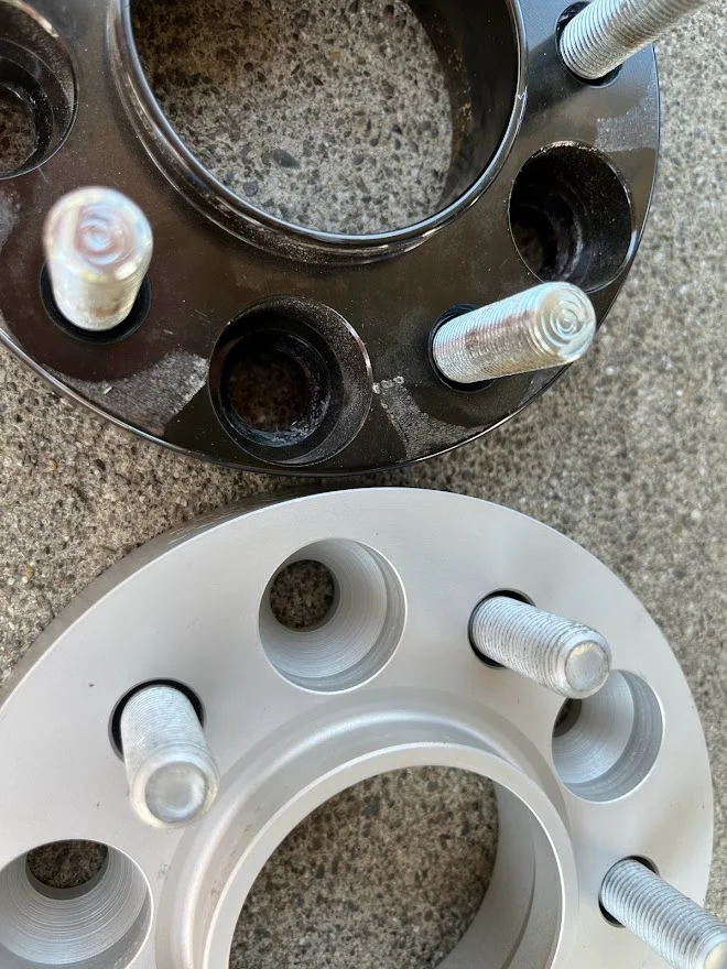

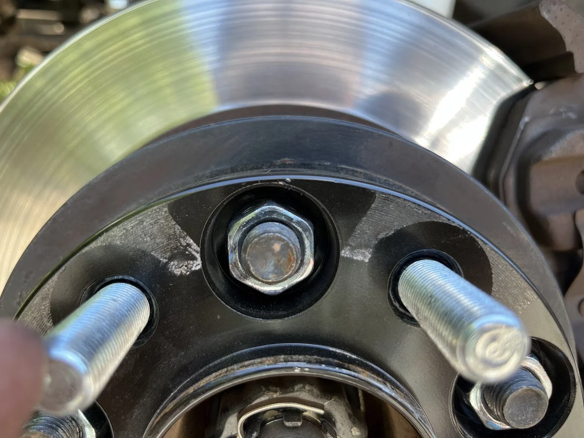

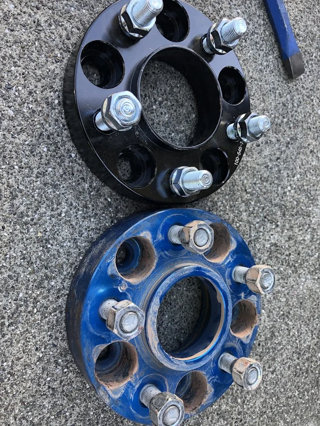

While installing them I couldn’t help but notice differences between the spidertrax (blue) and titan (black). For example the hub center on the spidertrax was significantly thicker, and the overall diameter was nearly .200 bigger. What really did it for me though was after I checked the titan wheel spacers after 50ish miles of driving, I noticed that the outside diameter had deformed slightly and was no longer concentric—due to the absurdly thin sections between the outside diameter and the lug holes. Scary.
I’ll let everyone make their own conclusions on these findings but for me it was enough to start looking hard for another option. Luckily, H&R makes spacers and were considerate enough to include 5x4.5(114.3mm) with a 71.5mm hub center in their lineup. I purchased the 25mm version (just a hair under 1”) and the total price for four shipped was $310 (close to 3x the cost).

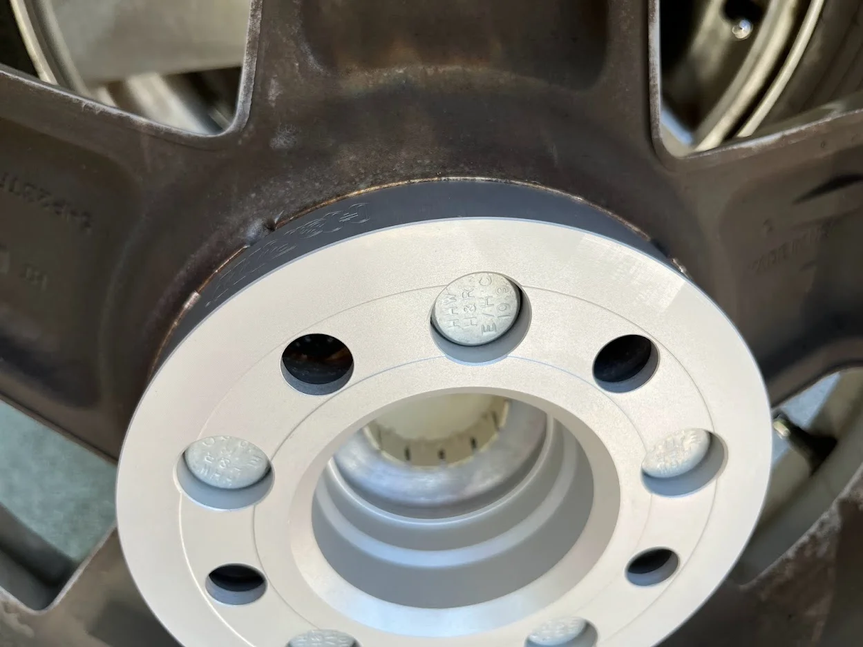

Like the spidertrax, the fit and finish of the H&R spacers is top notch and there is a generous amount of material thickness in the center hub section. Most surprising though is the overall diameter of the H&R. It is large enough for the inside wheel surface to make full and complete contact with the spacer. The same can’t be said for any other spacers I am aware of.
