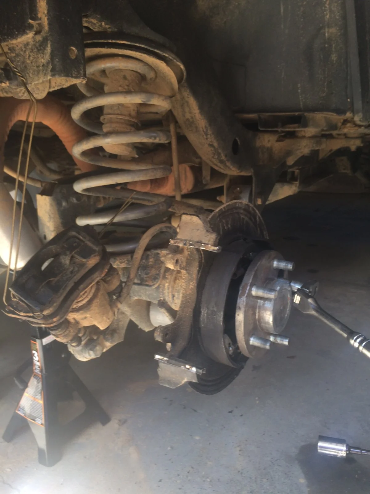

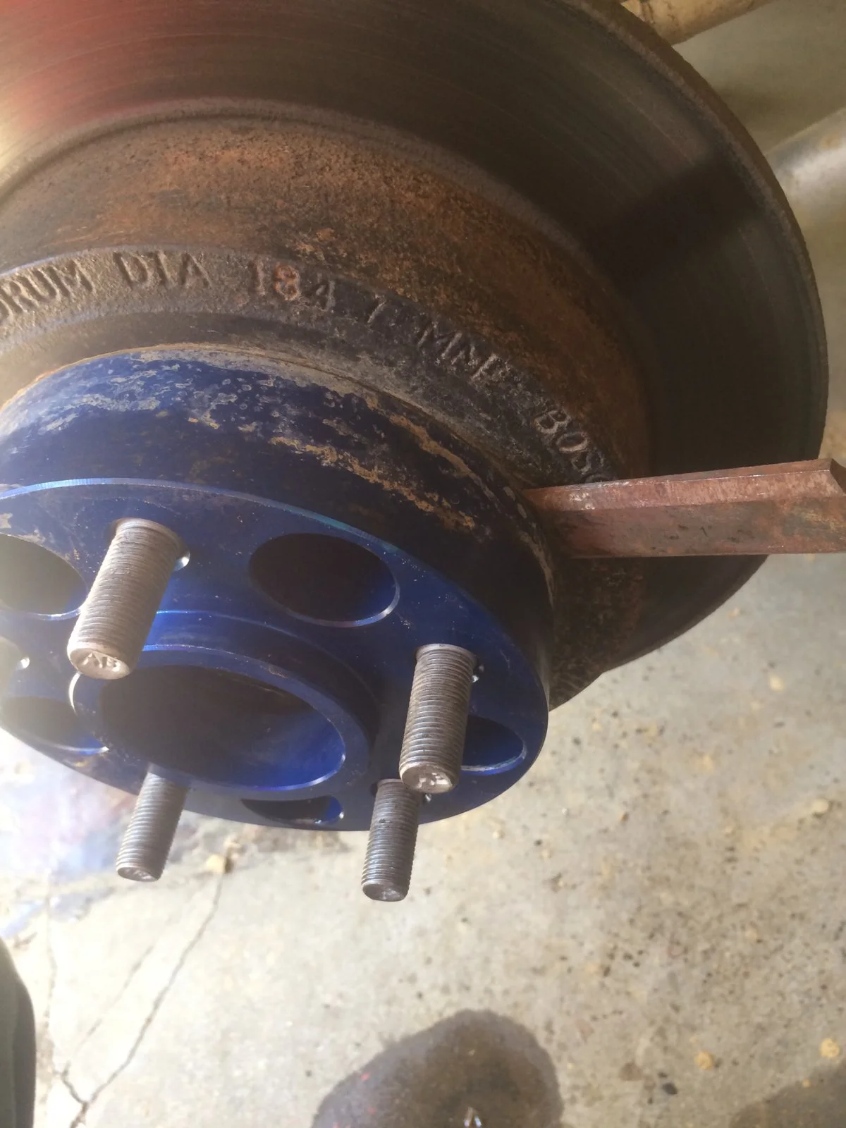

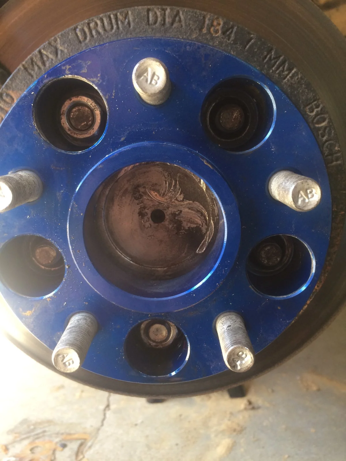

Hey all, ive got a 2003 Rubicon and I've been reading up on changing my passenger side rear axle seal on my Dana 44. When I got down to start I noticed the PO put on some spacers and used loctite to secure the spacer to the studs. When I went to remove them I could only get three off while the other 2 spin anytime I take the bar or impact to it. I called the local 4x4 but they won't have availability till next Monday to do anything about it.
Other than torch and pry bar to try and create leverage on the nuts/studs does anyone have any tips?

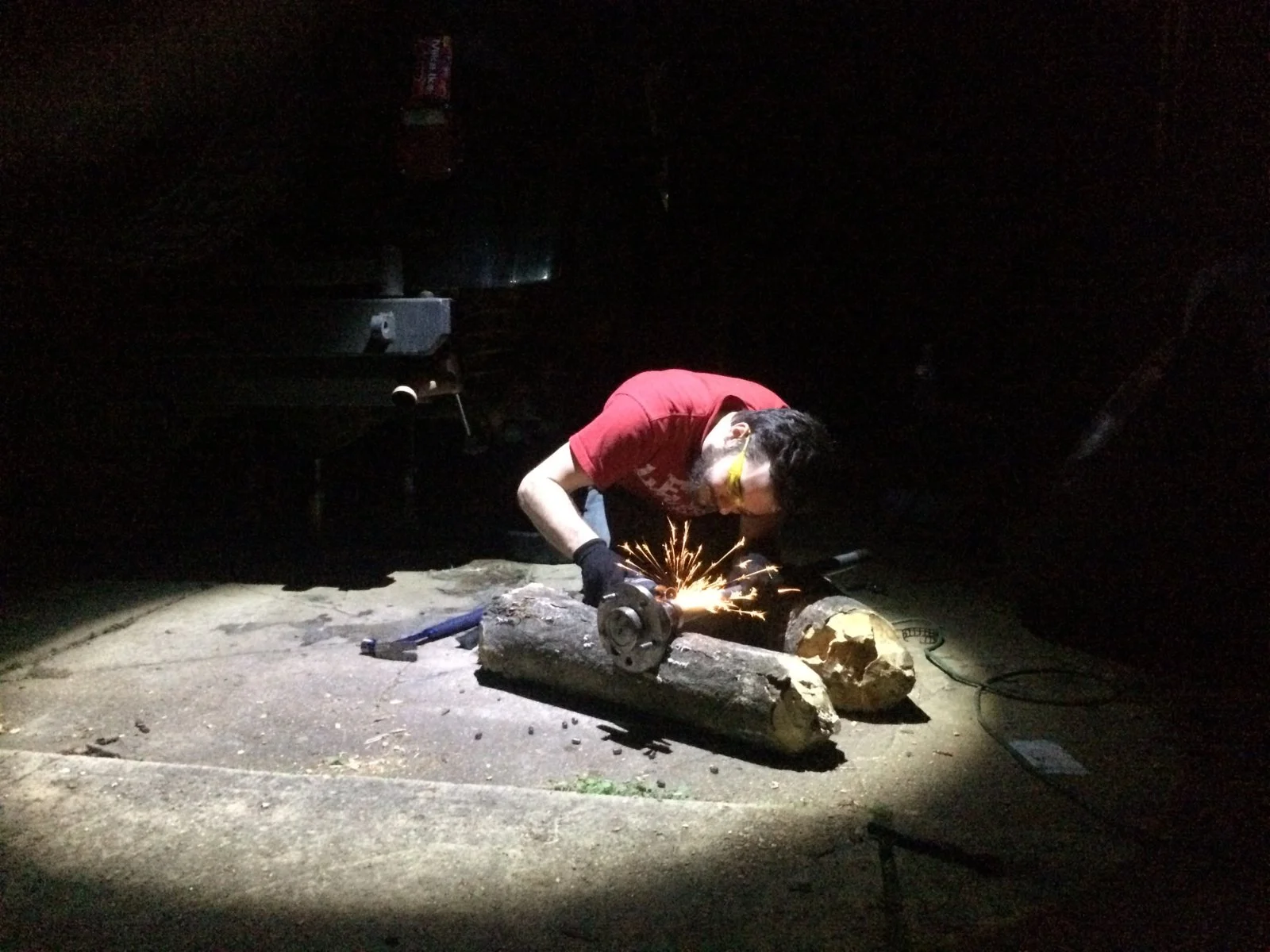

At this point I'm considering buying an angle grinder and tearing into the spacer and just replace it. Any tips or guides for something like that? This isn't all to common and the other idea wasn't working. Thanks everyone!
Alright I ended up using a crowbar and the impact to get the last one out. The chisels were not cutting it. Spacer is out and I’ve pulled the axle and I’m now going to have to press in new studs as well as change the seal and press back on the new bearings. I’ll try to post pictures as I get going for anyone else.

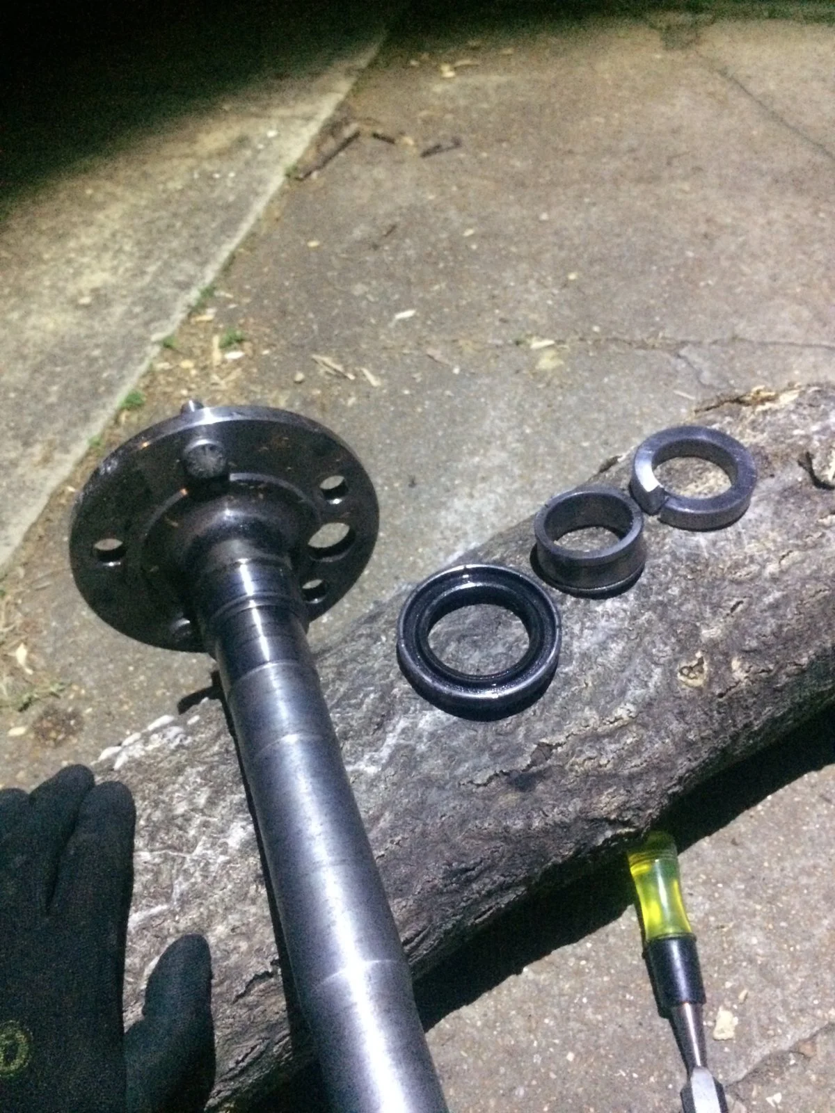

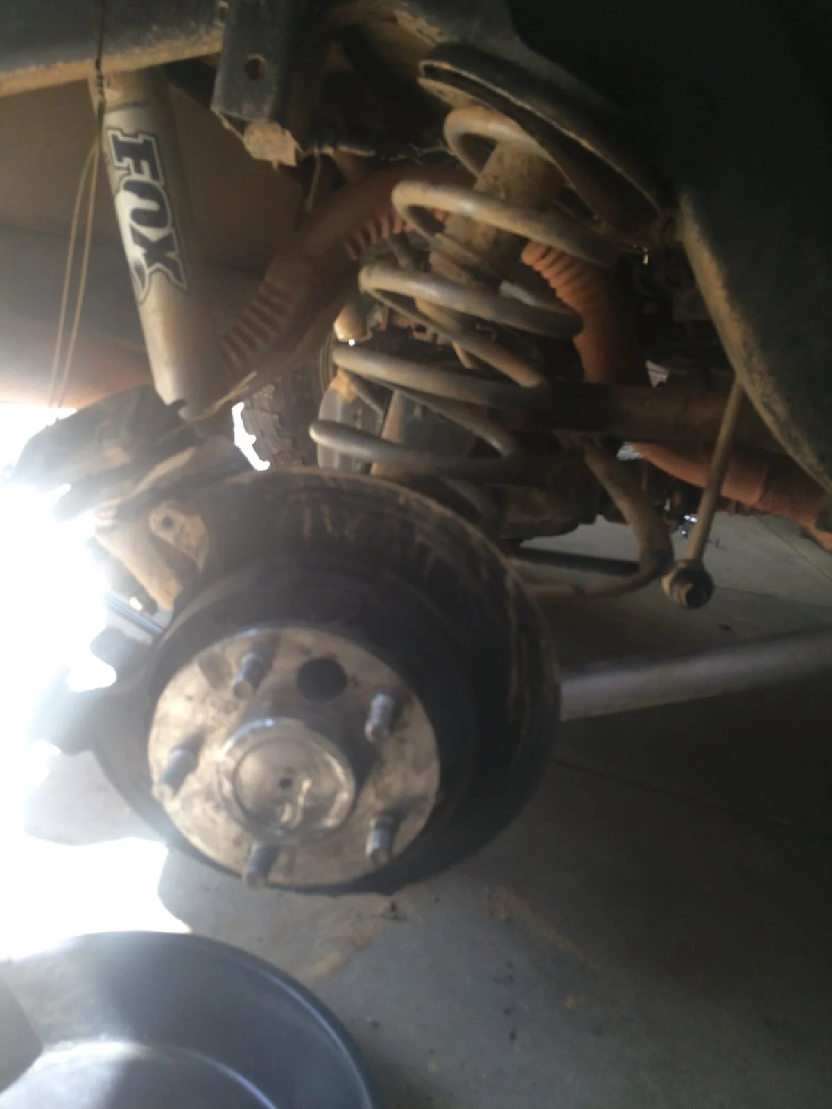

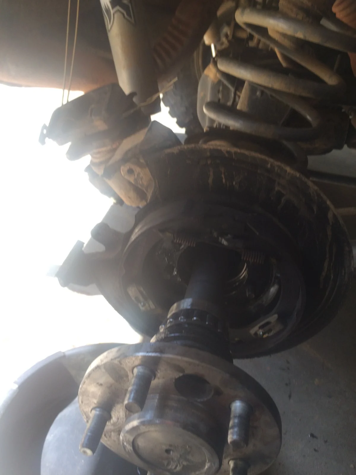

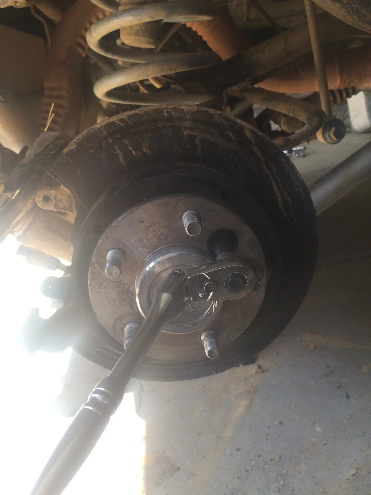

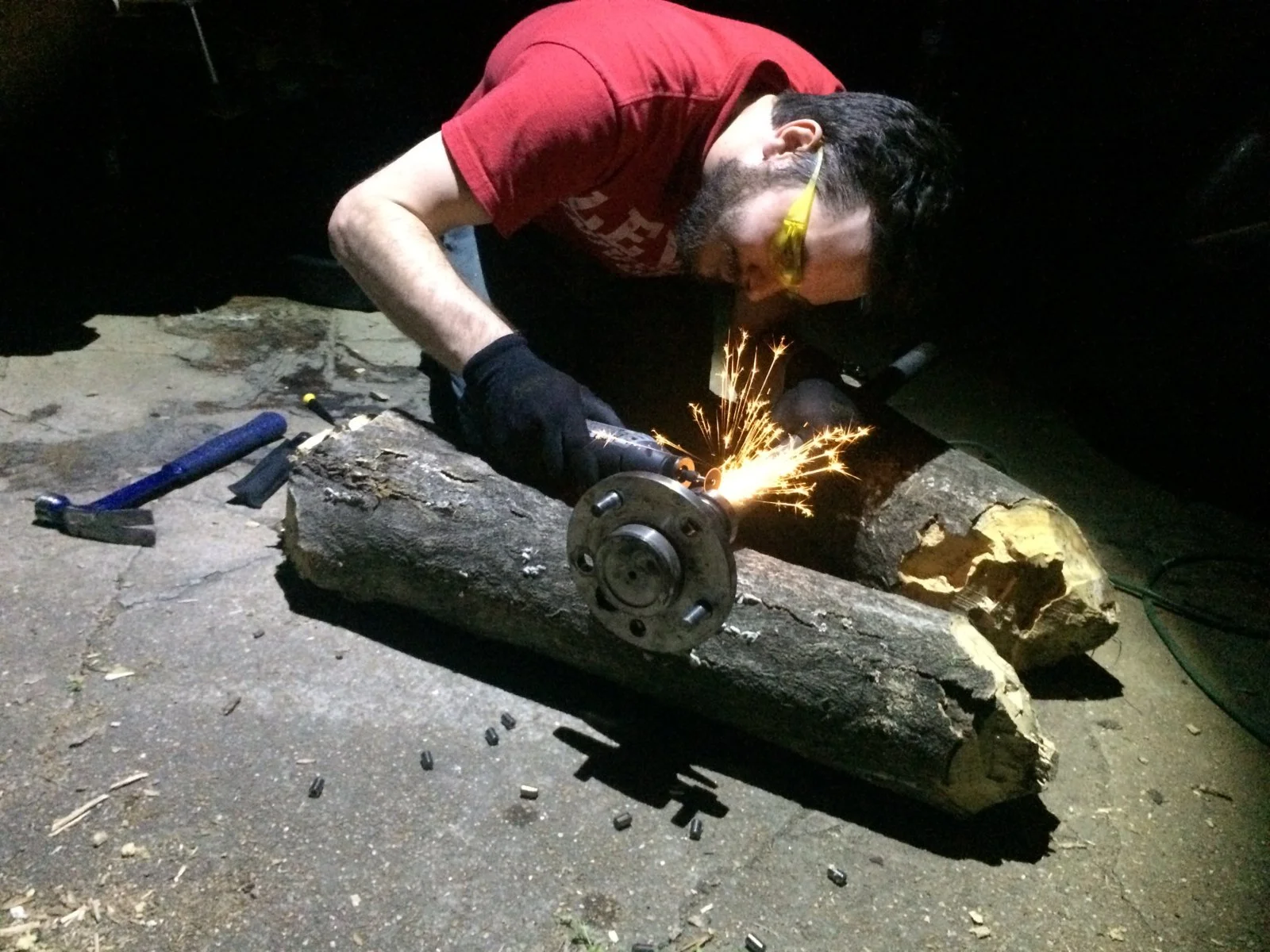

Update. I have finally gotten some new studs to replace the old ones. These were a little longer than the ones I already had but they were small enough that they didn't stick out of the spacer. I've taken off the retaining ring, bearing and seal at this point but it got a little dark out so I've saved all the pressing and re installation for tomorrow. Here are some pics I managed snap (when I remembered to)

Rich, this goes to show you how much "love" we invest into our rigs.
Working overnight, proper tools on a dino TJ work bench, no coffee break, no per diem, no overtime pay....no complaints, just one light is good enough, for the love of the jeep!
You deserve a "pat-in-the-back".
Hahaha thanks guys! I was actually in the back of my duplex inside my garage. I hung a flashlight from the garage door so I had some light. You cracked me up though! I found out the retaining plate was a little warped tho so I'm looking around town to see if I don't have to order it. I want this all put back together today!
ha you are totally right! It was my big scene, moment of triumph, the completion of disassembly.

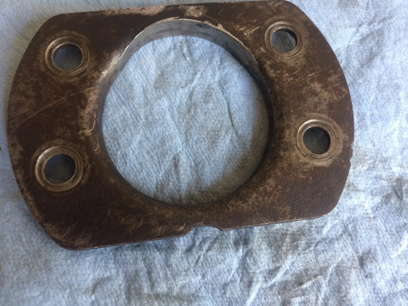

Well like I said that axle retainer was warped and I've searched all over. Local shops don't have it and the only ones I can find I'm weary of.

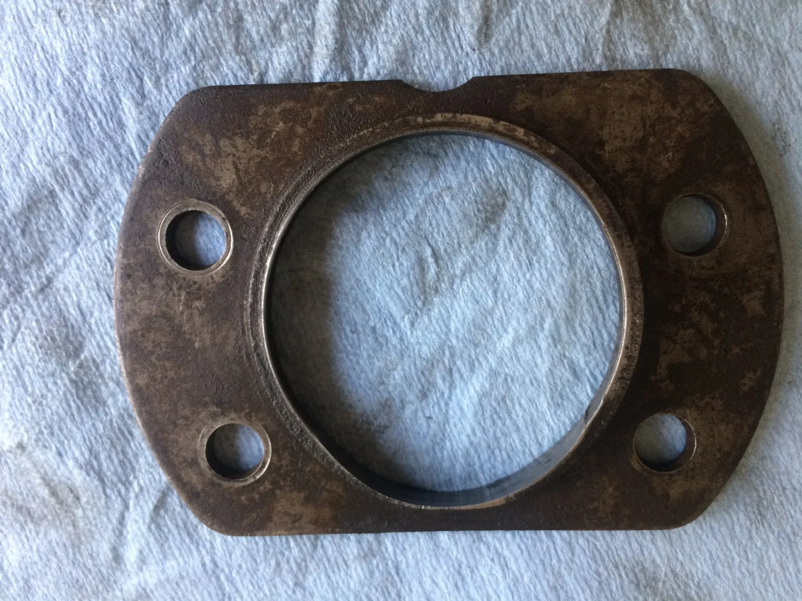

Lastly. It looks like this seal is not only warped a little bit ground down. What else should I be considering in regards to cause and effect. What caused this and what else may need attention? Thanks!
The wear at the top of the bearing retainer is due to the axle shaft rubbing on it from the bearing failing or losing preload and the play in the tapered bearings letting the axle move up. However, that should have caused a massive oil leak and I don't see evidence of that. You should replace the retainer due to the wear, not the warp. They warp on purpose to put preload on the bearing and prevent the axle from walking out.

Thanks for the info! Yea I'm definitely replacing and it and there was a little play in the bearings when I took it off but not a lot. The back of the wheel hub area was pretty covered in gunk, which is what prompted this whole endeavor. I don't have a pic of it though.

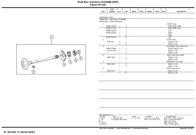

What's with the different shapes for the retainer plate? I've seen a few like the one I have overall rounder rectangle but I've seen others for the Dana 44 that are more diamond shaped. In the factory parts book it shows a diamond one for the Dana 44 axle.
