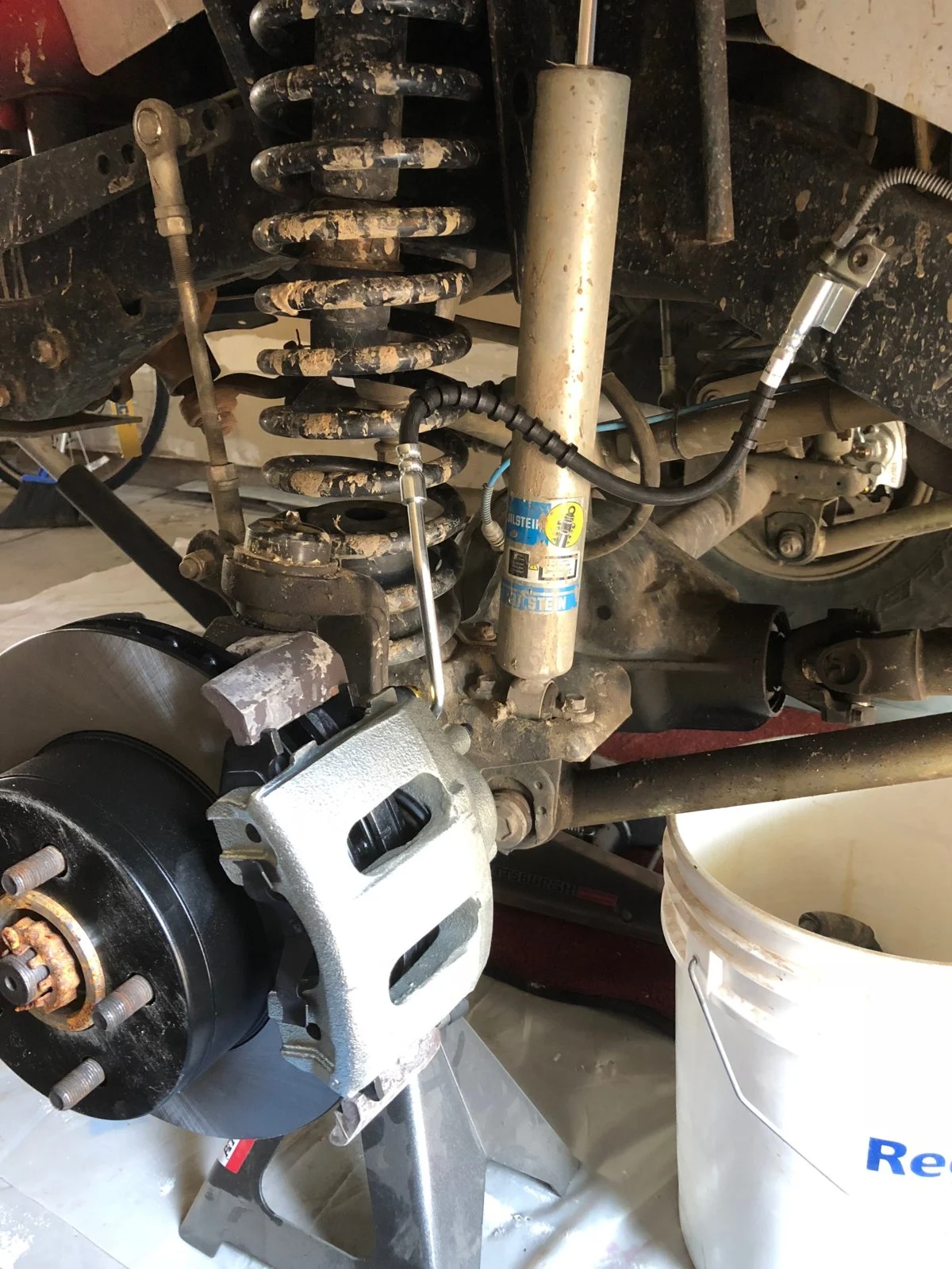

I have a front disc caliper that’s intermittently hanging up on my 98, only on longer drives so I’m thinking it might be the line instead of a corroded piston. There sure are a lot of options showing the line for purchase and I’d hate to buy a sketchy product. Who has replaced their passenger side line with a product they are happy with and where did you buy it?
Replaced mine with YJ lines. They are several inches longer and are a direct swap. I picked both up for $25

For the YJ lines the part numbers I used were BH38861 & BH 38862. Even came with copper washers.

Do you remember where you ordered them from? You're also running around 4" right, with no problems on line length?
I picked them up on Ebay. Cencalpartslingers was the seller. The brand is Raybestos. Yes, I am running 4" of lift, I have more than enough slack with these.
