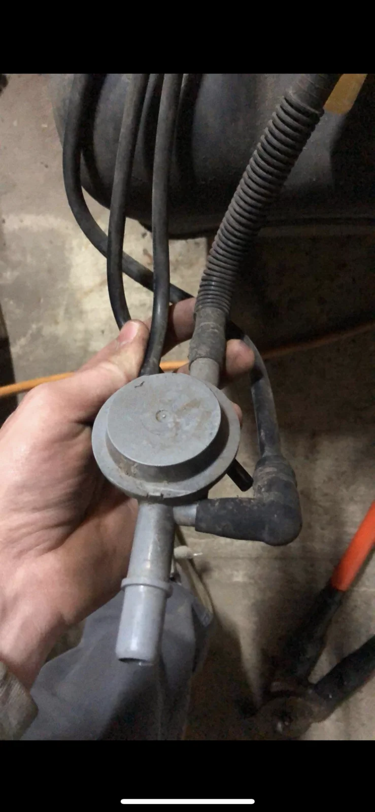

I broke what I believe is the fuel management valve while dropping my tank in my 04. Can’t find a new or used one anywhere. Does anybody have any leads or even one laying around they would part with. Picture attached of valve needed.
That thing is part of the whole spider that goes over the tank. You can find them on ebay. You might search car-part.com for a local salvage yard or call Daveys Jeep if nobody here has one. If you just broke a hard line you really should try to patch it with a rubber hose if you have two ends to work with. I don't think any of those lines are designed to be removed from the valve so if you just get the valve you're going to have to figure out how to re-attach everything anyway.
