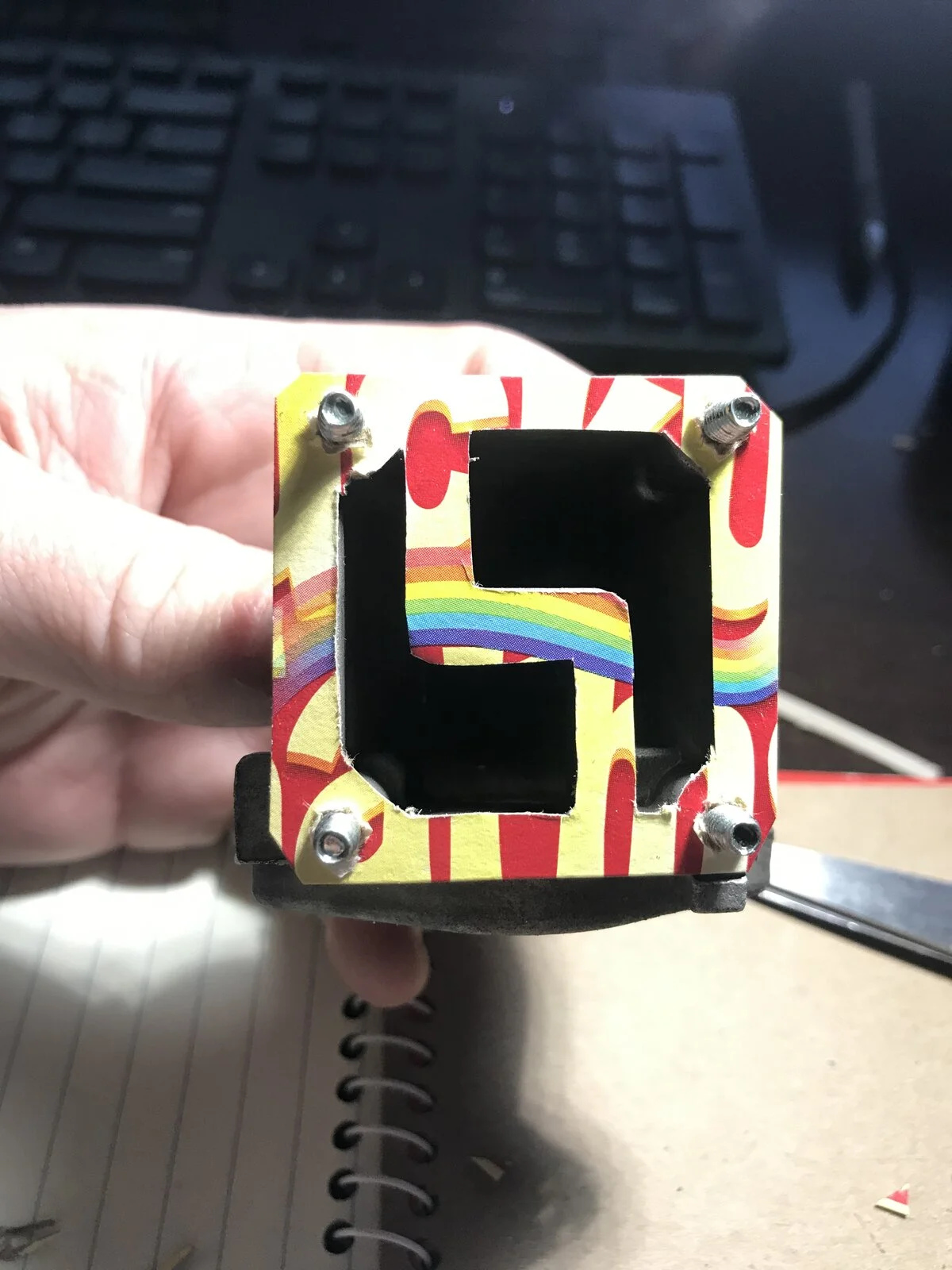

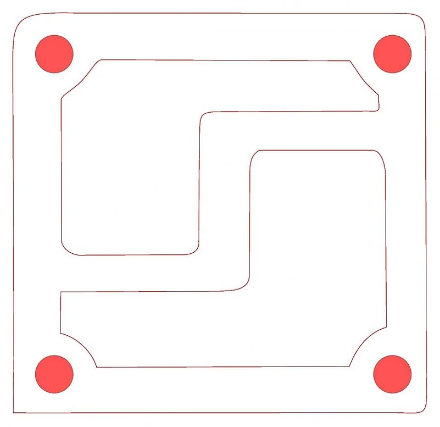

Go to any auto parts store and get yourself a sheet of cardboard gasket material. Then get a razor blade or Exacto knife and cut one out like shown below.
Punch the bolt holes then use the blade to trace against the openings and you'll have your gasket.
I'd definitely do this before I'd use RTV on that particular part.
This is what it'll look like when you're done.

That's the plan, I'll run over in the morning and buy some gasket material...... Still surprised no one else has run into this?

Welp, fixed the gasket. Cost me all of 5 bucks and I have plenty of extra gasket paper for next time. Also the jeep is idling at a stop just fine now. I'm still having the issue when I first start it like there's no fuel in the line. I think it's a bad fuel pump. I was going to hook my gauge up and test it, but there's not a port on the rail and I didn't have enough material to make a T to test with. Overall it was a very good day. I'll add another post with all the things I've done to the yellow lj I bought in October for my daughter. It's really coming together and I have most of the major items done. Right now she's driving my silver lj with me but I think we will have her ready for hers by summer.

Ha! That's great. My wife learned to make sandals and have a leather hole punching tool. Guess whos's using it to make paper gaskets?
