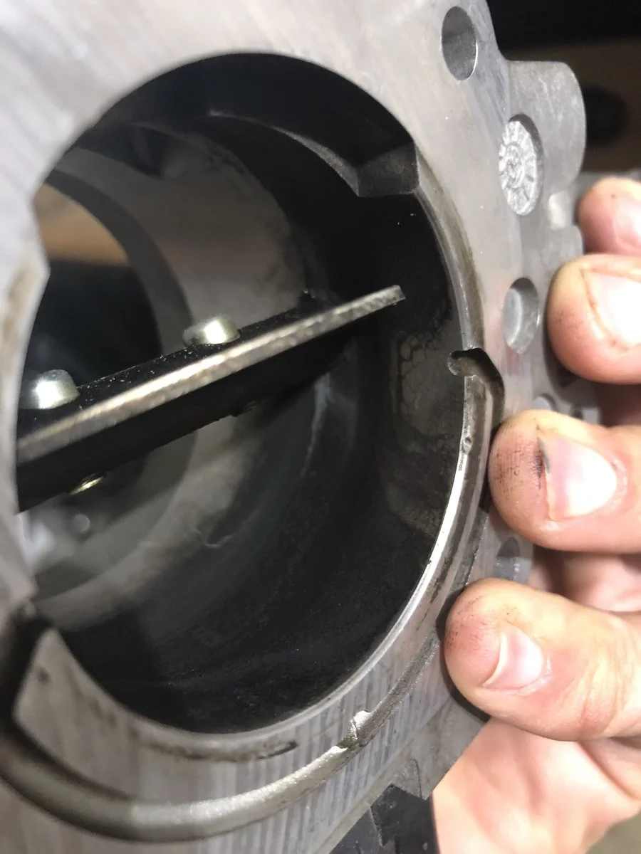

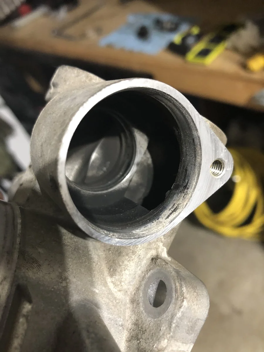

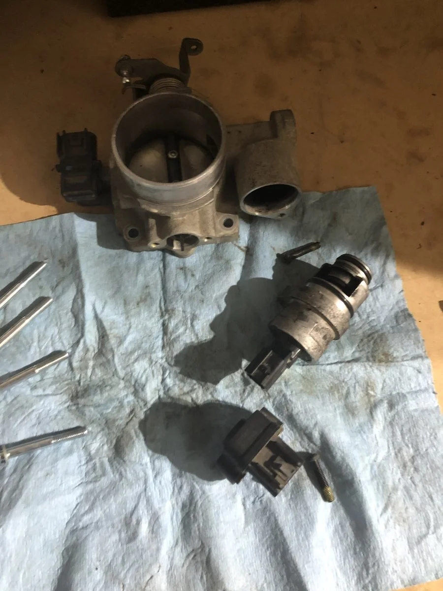

I guess mine was idling a little rough but it ever since I bought it it just seemed that way, so I never really thought about it. Took it all apart and saw that it was in need of much cleaning! Maybe acceleration will be a little a little better now after it's all cleaned up....MTF. 05' 4.0L with 110k.

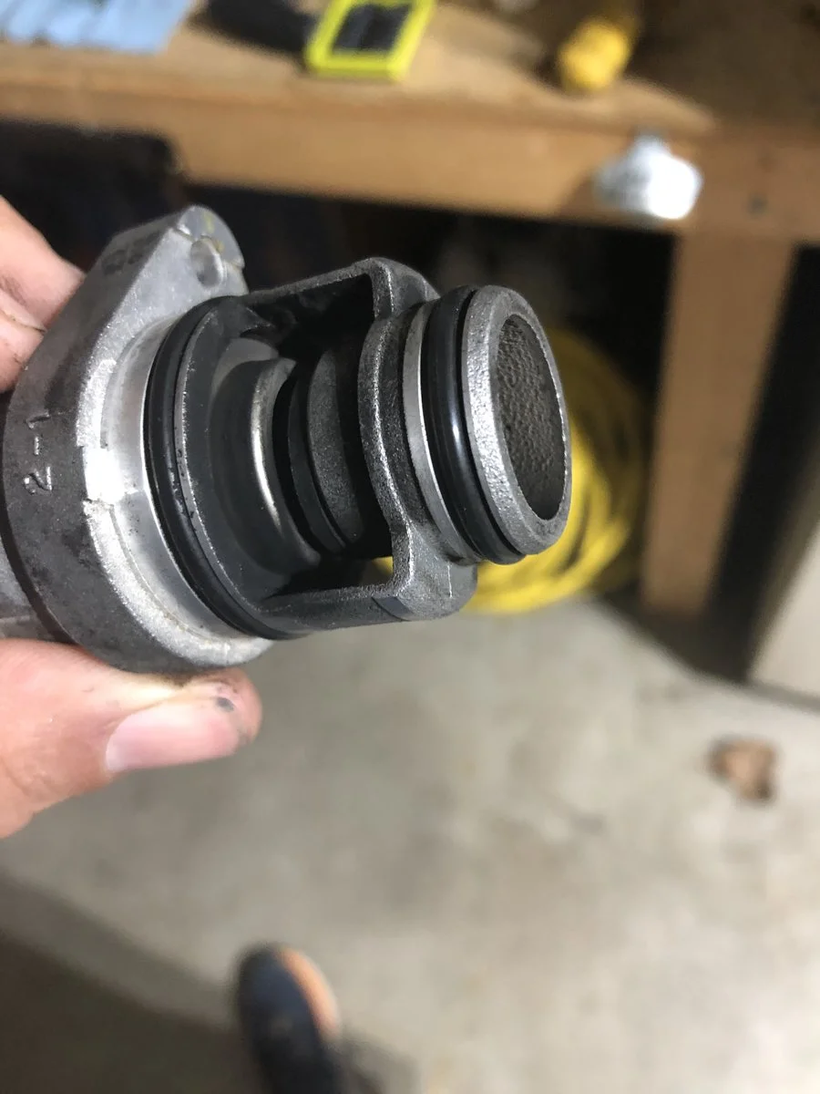

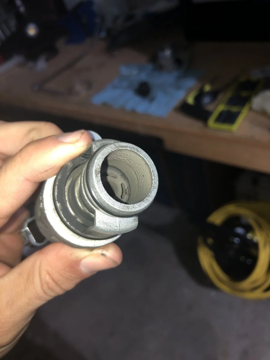

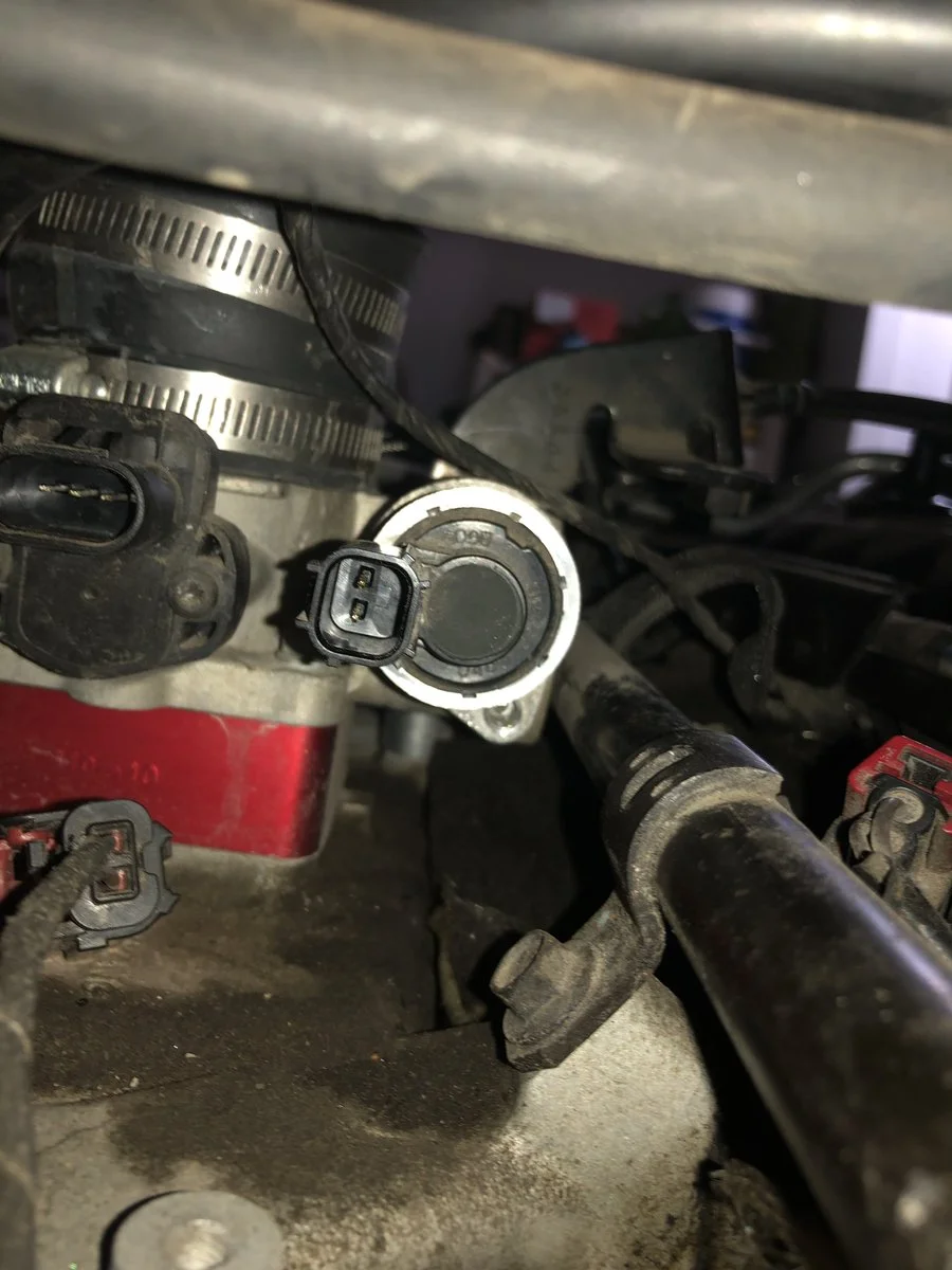

So, this hasn't gone well for me haha. Ever since I installed the IAC and TB back together the jeep wants to stall after turning over....unless I give it gas for a while and even after that it wants to idle rough until I drive it around for a while. I chipped the slightest little piece on the IAC thinking it was a plunger or something that came apart. It apparently does NOT come apart! Probably need to grab another one now. '05 4.0L
^ Update: I read somewhere that only IACs with a plunger can be cleaned. This doesn’t suit the 05-06 models if that’s true. Replaced the old one with a cheap version on rock auto and it fired right up with no issues. Anyone heard of this “only plunger type IACs can be cleaned and reinstalled?” Either way, glad to be back on the road without air/fuel ratio problems now

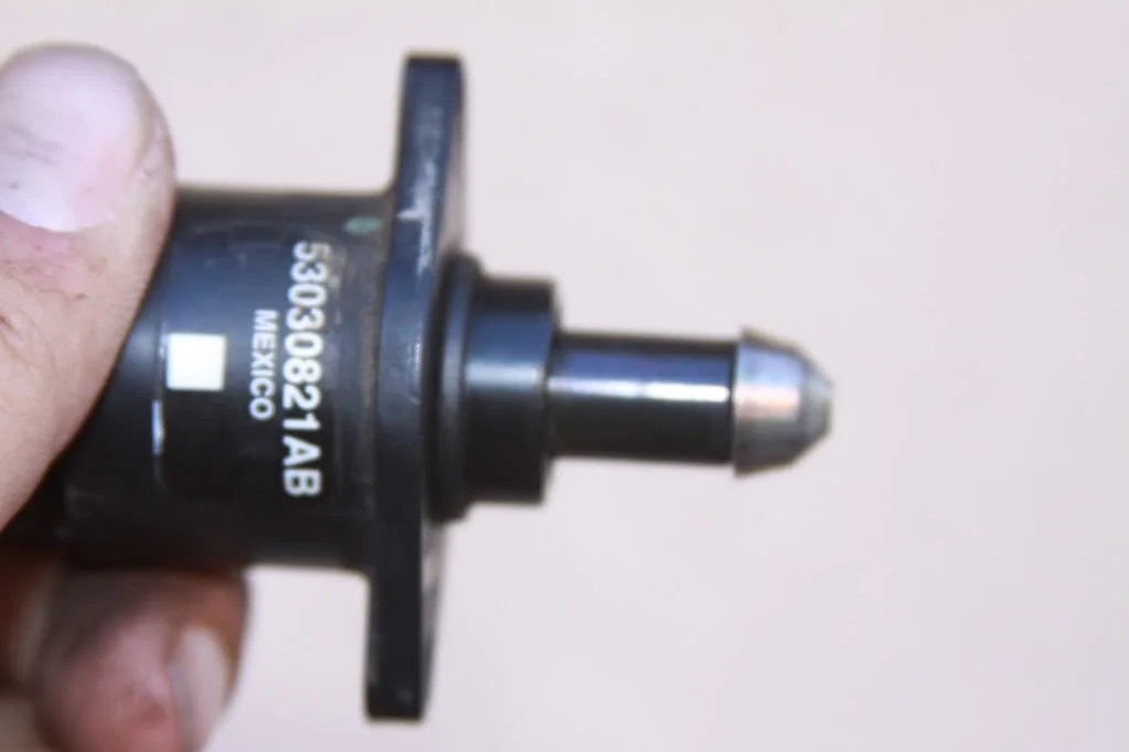

Take your IAC off (it's held on by two small torx screws). Clean it with your throttle body cleaner, this is what it will look like before and after.

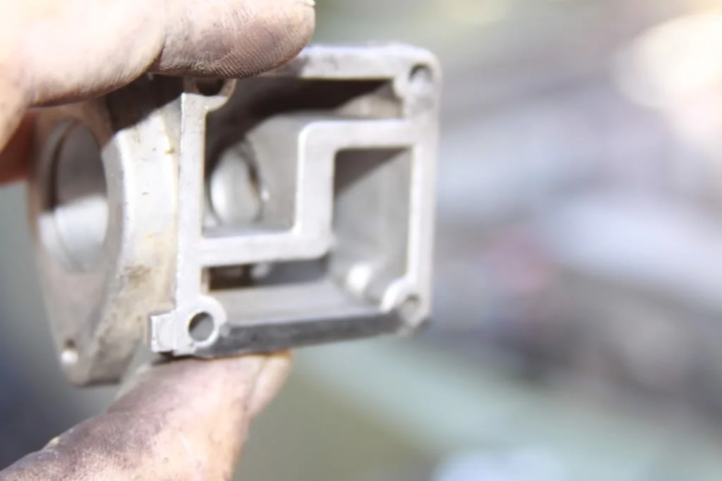

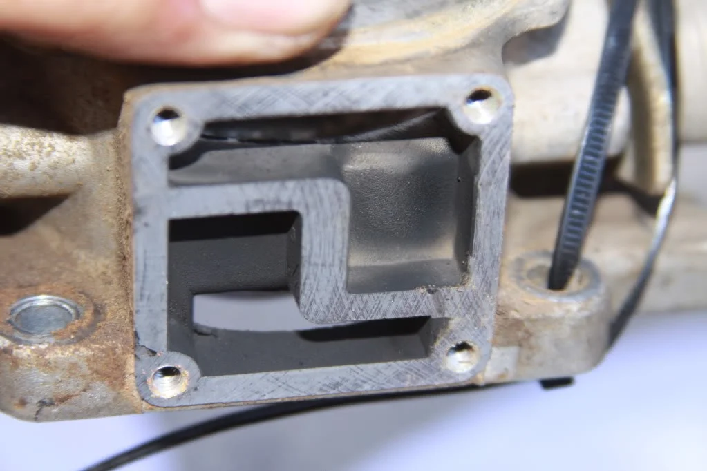

Then take off the IAC housing and both sides (house and throttle body). clean that too. before and after...
