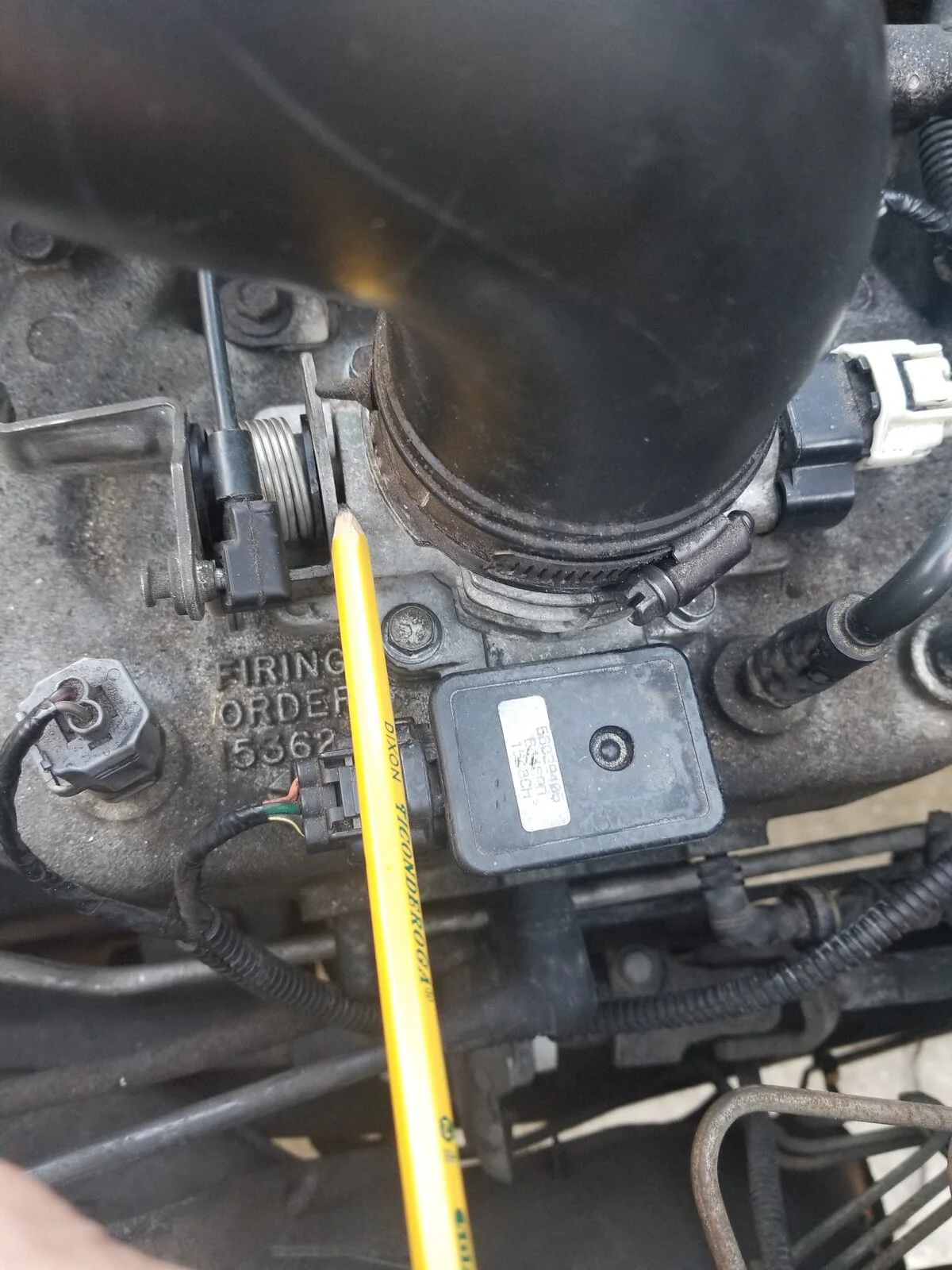

Older thread, but this worked perfectly. Only difference, mine has a square opening Vs the slit shown here. Not sure why, 2005, who knows.
Either way I got shots in without killing the engine, then hit it harder to kill it and start it back up. Not sure I did a full 1/3 can, but did it for a while. Idles like a champ mid 660’s to 710 ish on the Trail Dash. Idles smooth now.

I was wondering if this worked with the 2005 iac sensor, its a bit different than the previous years. Going to try this tomorrow.
