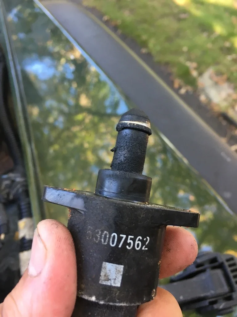

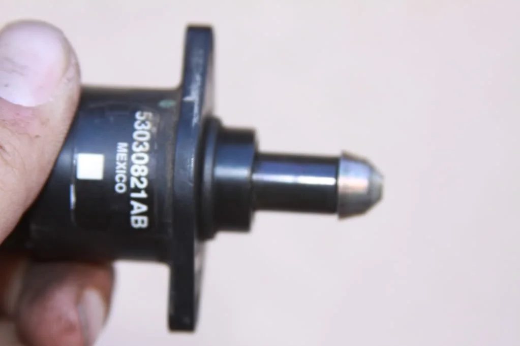

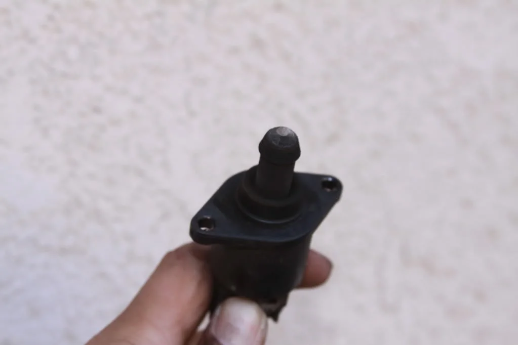

Take your IAC off (it's held on by two small torx screws). Clean it with your throttle body cleaner, this is what it will look like before and after.

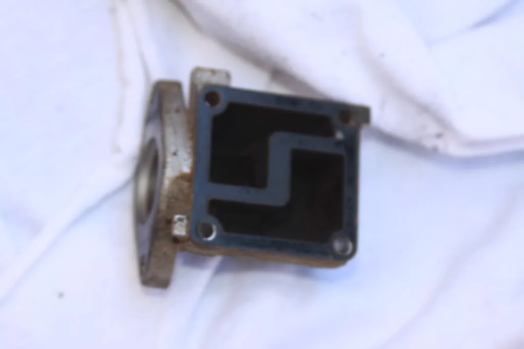

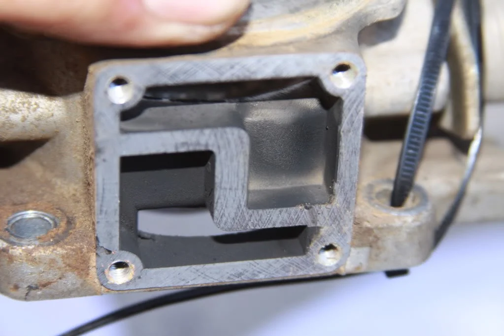

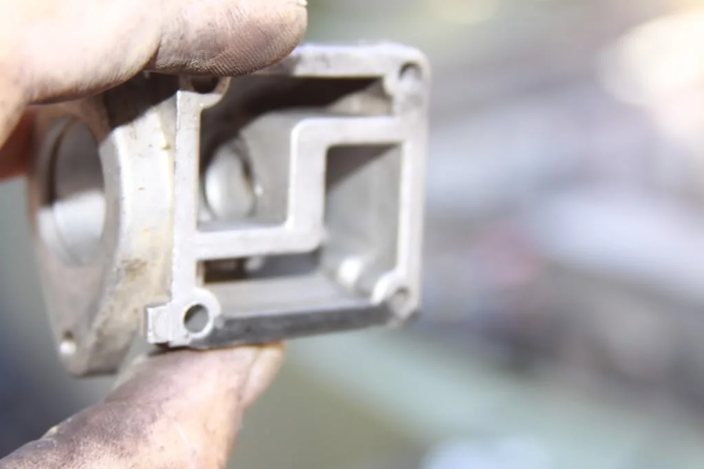

Then take off the IAC housing and both sides (house and throttle body). clean that too. before and after...
Put it all back together and you're good to go. Very, very simple. It doesn't get any easier than this!

Thanks for the heads up chris. Fun little Sunday project. Didn't really notice poor idle, but this baby is mighty gunked up.
