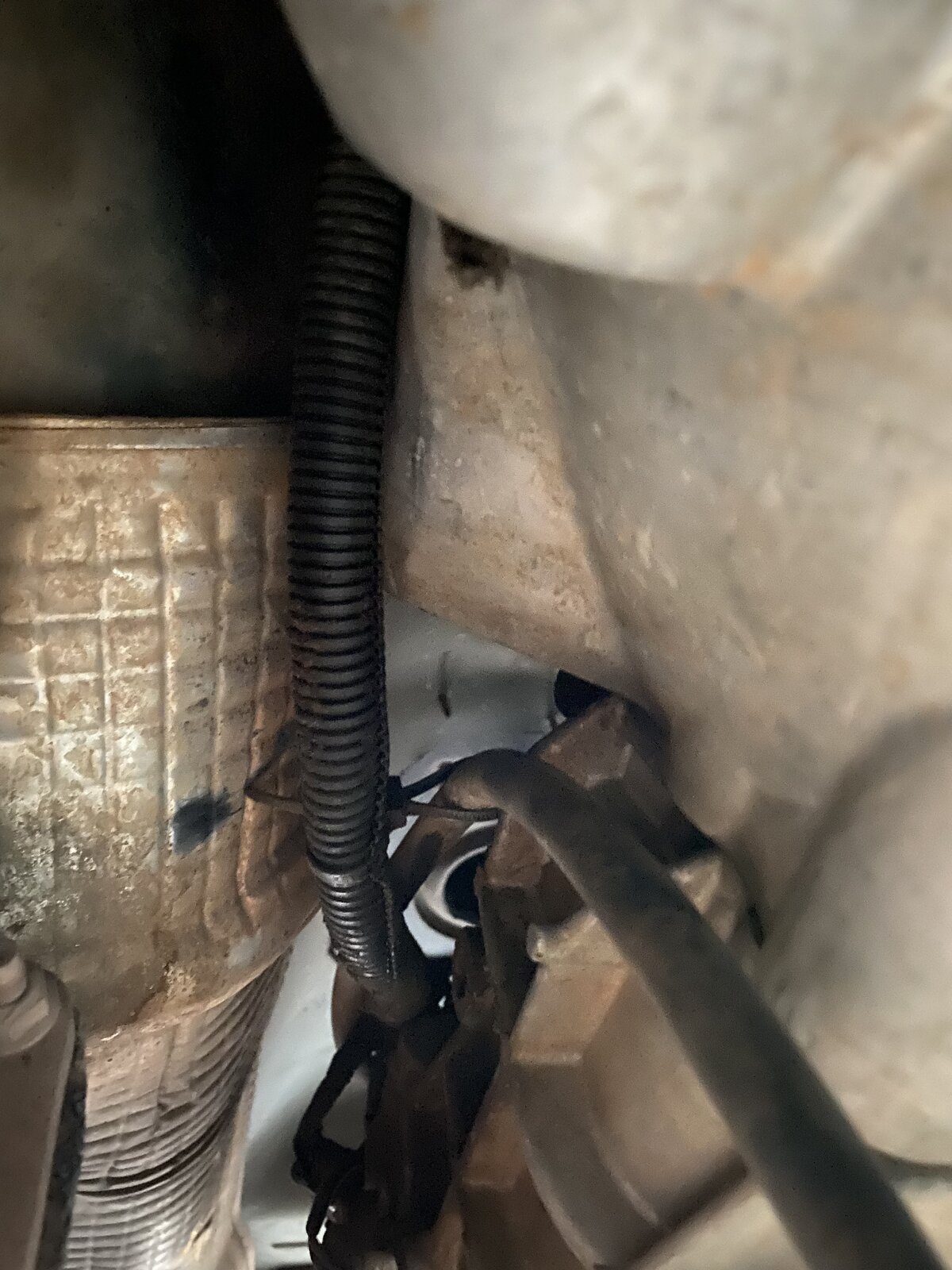

John’o TJ Enthusiast Original poster Supporting Member Joined Oct 17, 2021 Messages 142 Location Tucson AZ May 10, 2022 #1 Comes from the back of the transmission fwd. small opening, stretches to the oil filter. Saw it dangling down today. Thought Ken the Jeep saw a Barbie Jeep.

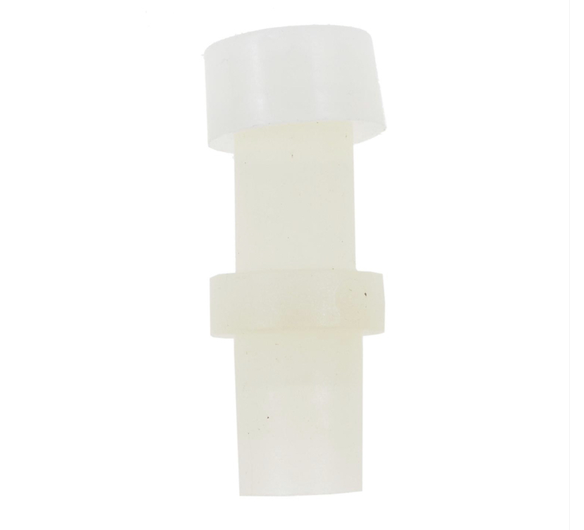

MichaelGH Hemi ‘97 Supporting Member Lifetime Supporting Member Joined Jan 19, 2021 Messages 1,023 Location OHIIIIIIO May 10, 2022 #2 Looks like a vent hose with the vent cap broken off/missing. For either the transfer case or the transmission… Reactions: John’o and Matt131
MichaelGH Hemi ‘97 Supporting Member Lifetime Supporting Member Joined Jan 19, 2021 Messages 1,023 Location OHIIIIIIO May 10, 2022 #3 Example…
AndyG Because some other guys are perverts Lifetime Supporting Member Joined Jul 30, 2018 Messages 18,902 Location Alabama May 10, 2022 #4 Where it goes is up if that is the intake end - shows us where it comes from Reactions: John’o

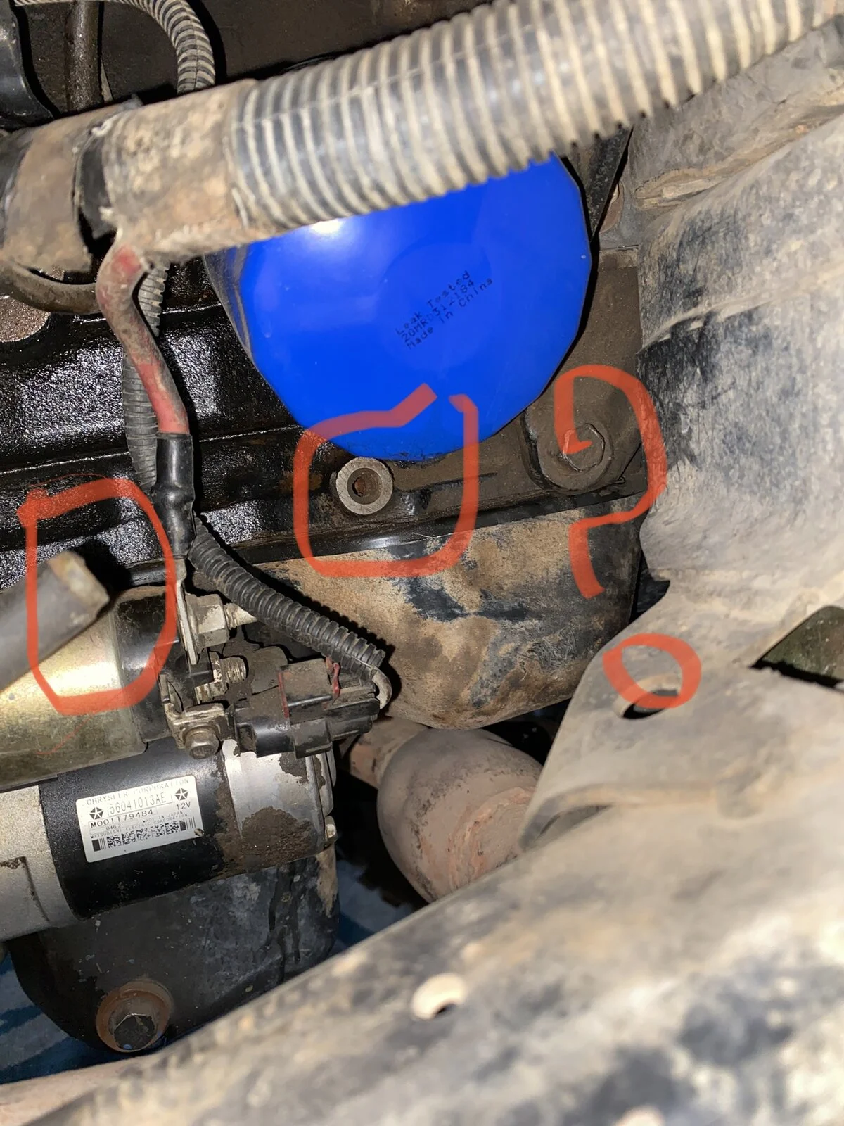

TJ4Jim TJ Expert Lifetime Supporting Member Joined Dec 9, 2015 Messages 4,280 Location Brookings, Oregon May 10, 2022 #5 Look at the bell housing to engine bolts above the hose, the original steel loop may still be there. Reactions: John’o

John’o TJ Enthusiast Original poster Supporting Member Joined Oct 17, 2021 Messages 142 Location Tucson AZ May 10, 2022 #7 Looking more sycboi said: Example… View attachment 329622 Click to expand... I have one on order. Thanks for the help Reactions: AndyG and MichaelGH
