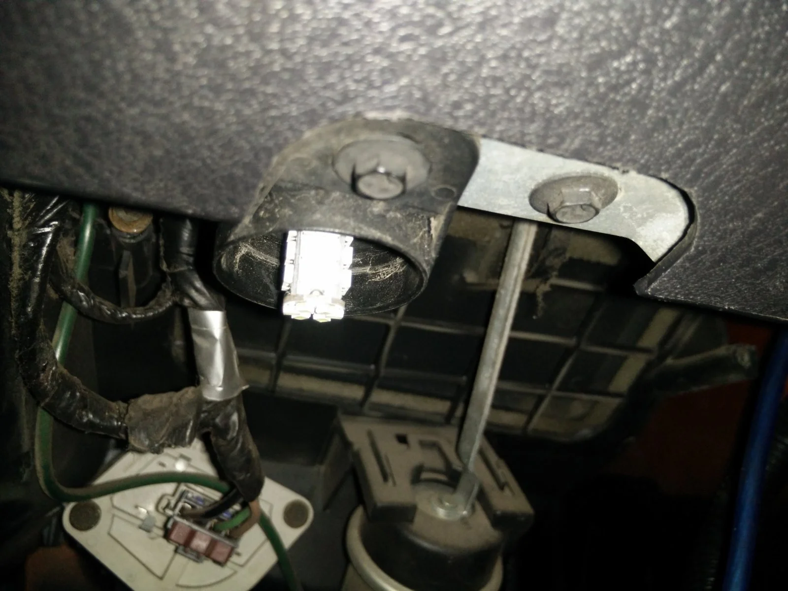

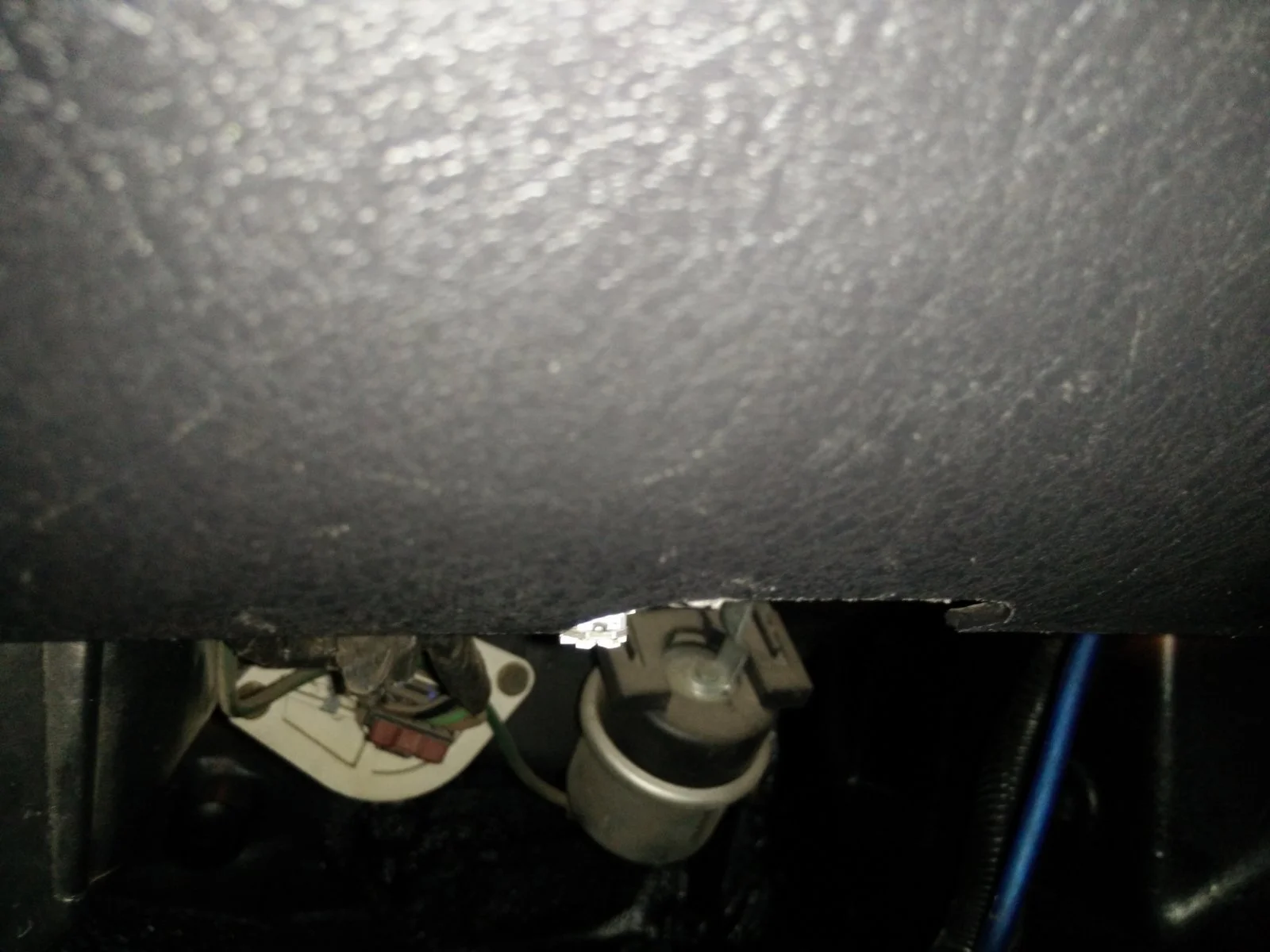

Where is the passenger side footwell light located?

I found this out the hard way..changed most of my lights in the cab and external after installing LED head and taillight kits. Front turn and markers are the devil. After multiple attempts at various combinations in the front, I ended going back to incandescents for both. Couldn’t make LED work well in either turn or marker. Weird thing, when I was changing my footwell lights actually removed the assy to take a closer look at the socket. When I did, the right side front and rear turn signals acted up, to the point that the right turn indicator on the was on constant, and the blink from the right side was hardly noticeable . So finally changed out for LED in the footwell and things are back to normal.
