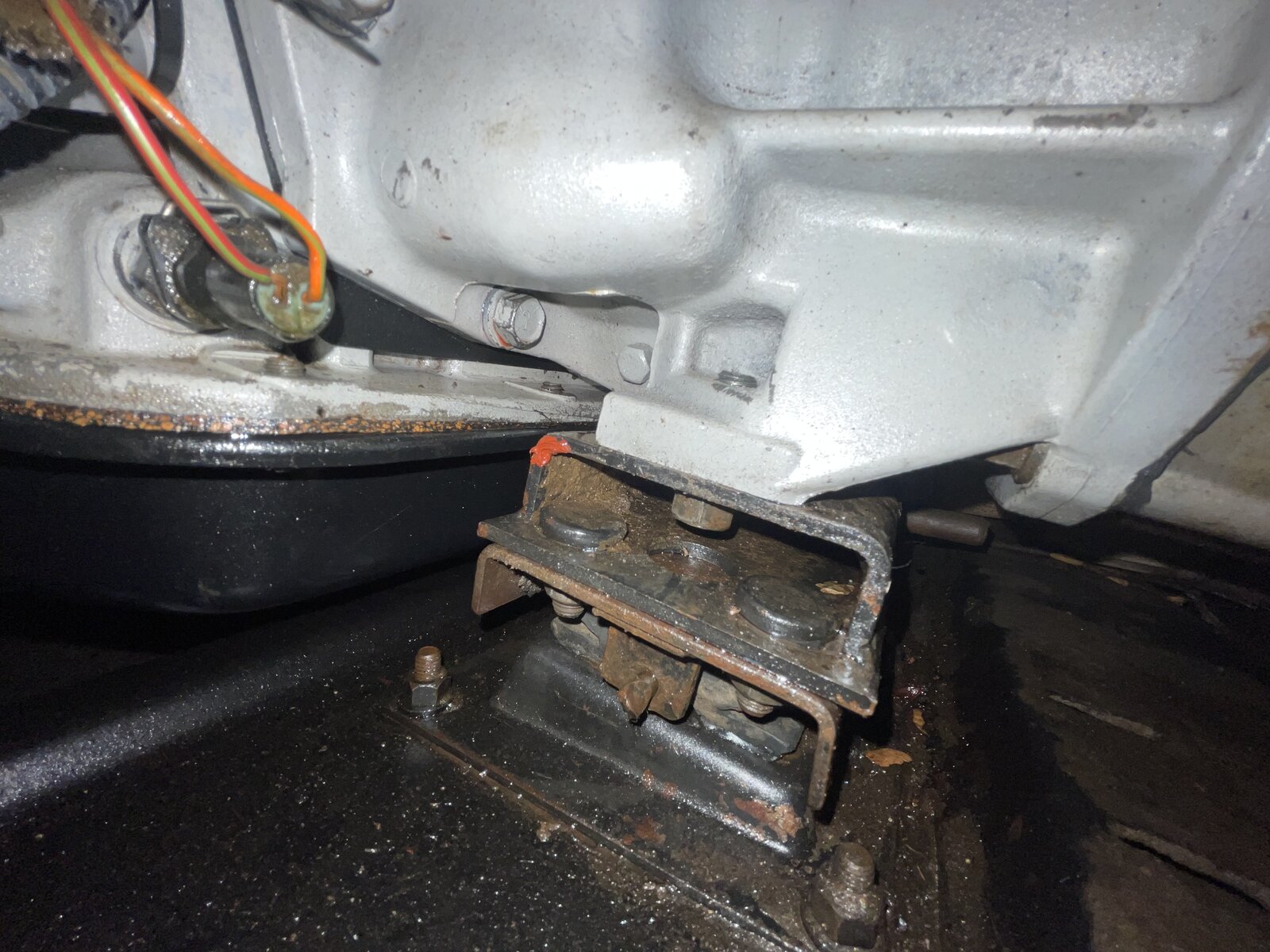

Skid plate was covered and it had started to drip to the floor. Only happens when driving or on certain angles as far as I can tell. Cleaned it up and had cardboard under it for a few days while replacing an axle seal and have seen nothing. Started taking it up and down the road a couple of times today and it looks like the damn bolts are leaking where the trans body bolts to the output shaft housing...
they didn't have a whole drop formed but really looked like they were almost weeping fluid.
I cleaned it up againwith some paper towels and got it on ramps in the garage now with cardboard under it to see if i can replicate.

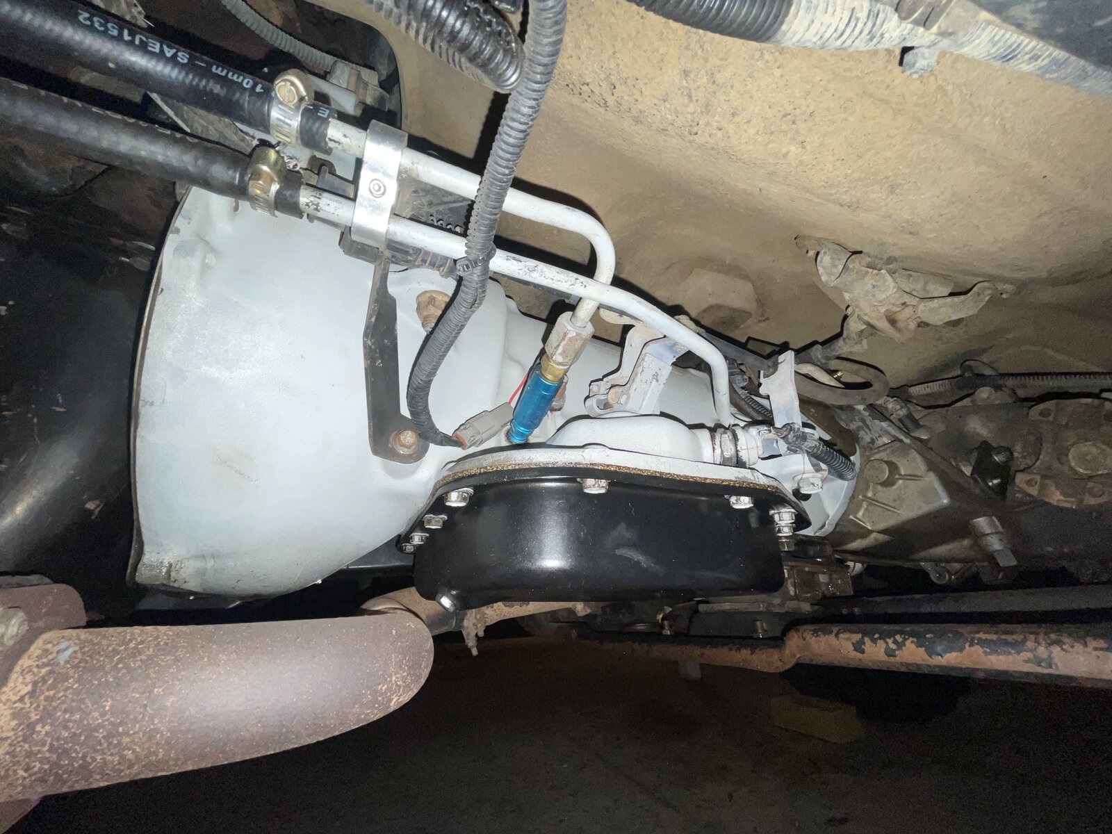

I'll be following as my Apex developed a leak in this tranny as well. I took a quick look, and it appears to be coming from the drivers side, maybe where the cable (I think its a cable) enters the transmission. My skid is covered as well. Please let us know when you find it!

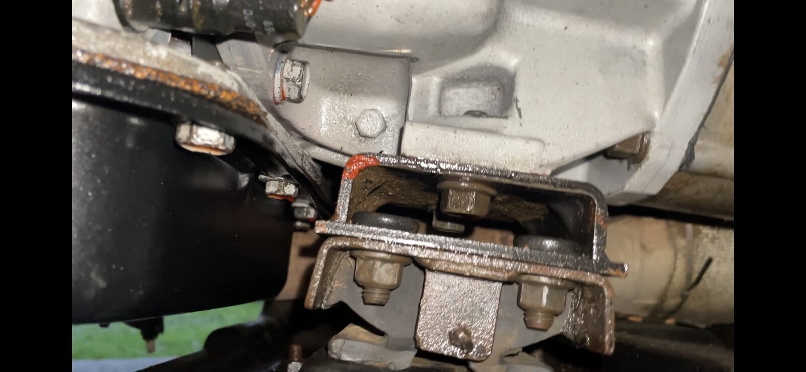

different lighting but im positive additional fluid is present now.

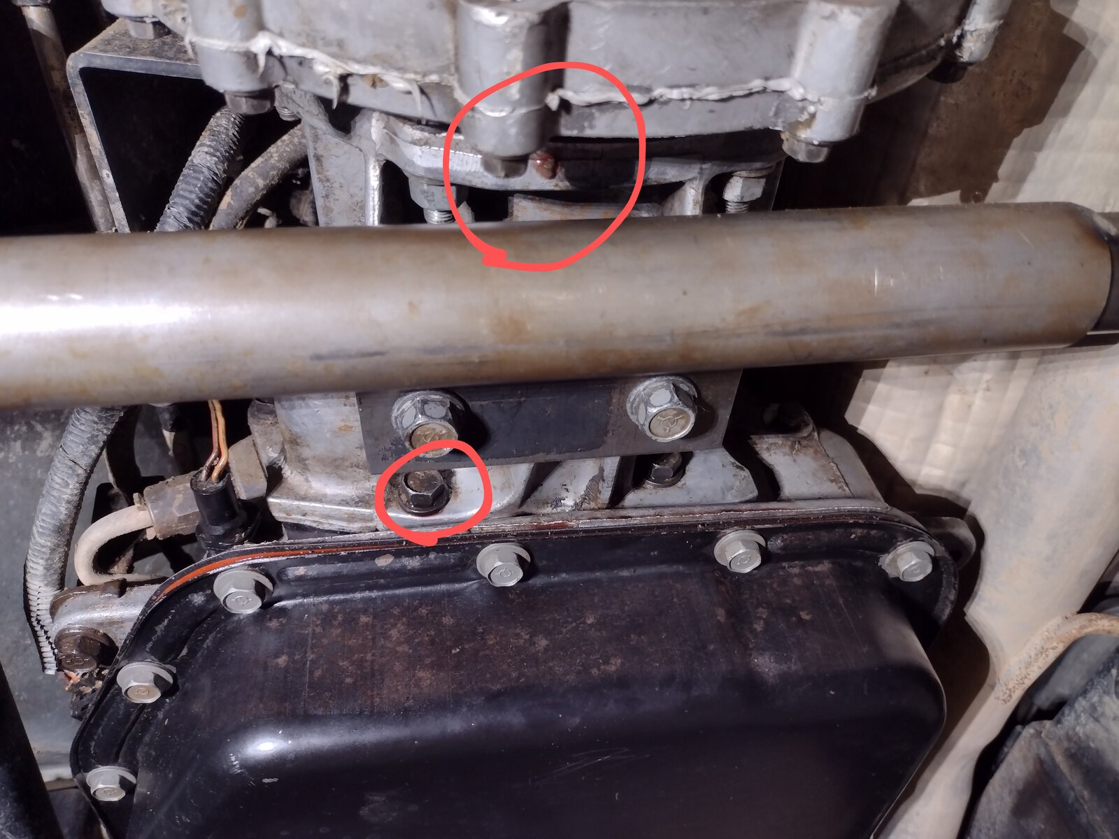

New drop formed on the front of the 241 mating surface. Also additional collection on the bottom left bolt that connects the front and back half of the tranny.
Connection on left side of tranny looks wet but cant be sure that isn't left over from before I cleaned it up.
Has anyone had this trans separated into two pieces? I believe I have 2 issues. (1) the extended seal that allows the 32rh to mate with the np241 is letting fluid past, and (2) the seal between the front and back half of the transmission is letting fluid seep out the mating surface, showing itself on the bolt by filling the bolt hole and weeping out on the bolt itself.
Thoughts?

Ended up being the seal on the tail shaft housing. Gotta pull the whole thing off and reinstall it on the back of the transmission. I thought I had it stopped for a while and now it's back...

I’m now thinking the previous owner swapped in the transfer case from another tj with the ax-15. I wont know for sure until i crack it open. But if that is the case what are my options?
You can either get the seal extender, swap cases to one with the longer input, or get the planetary with the longer input and swap that into the case. Last option is to convert to a manual trans to match the t-case.
