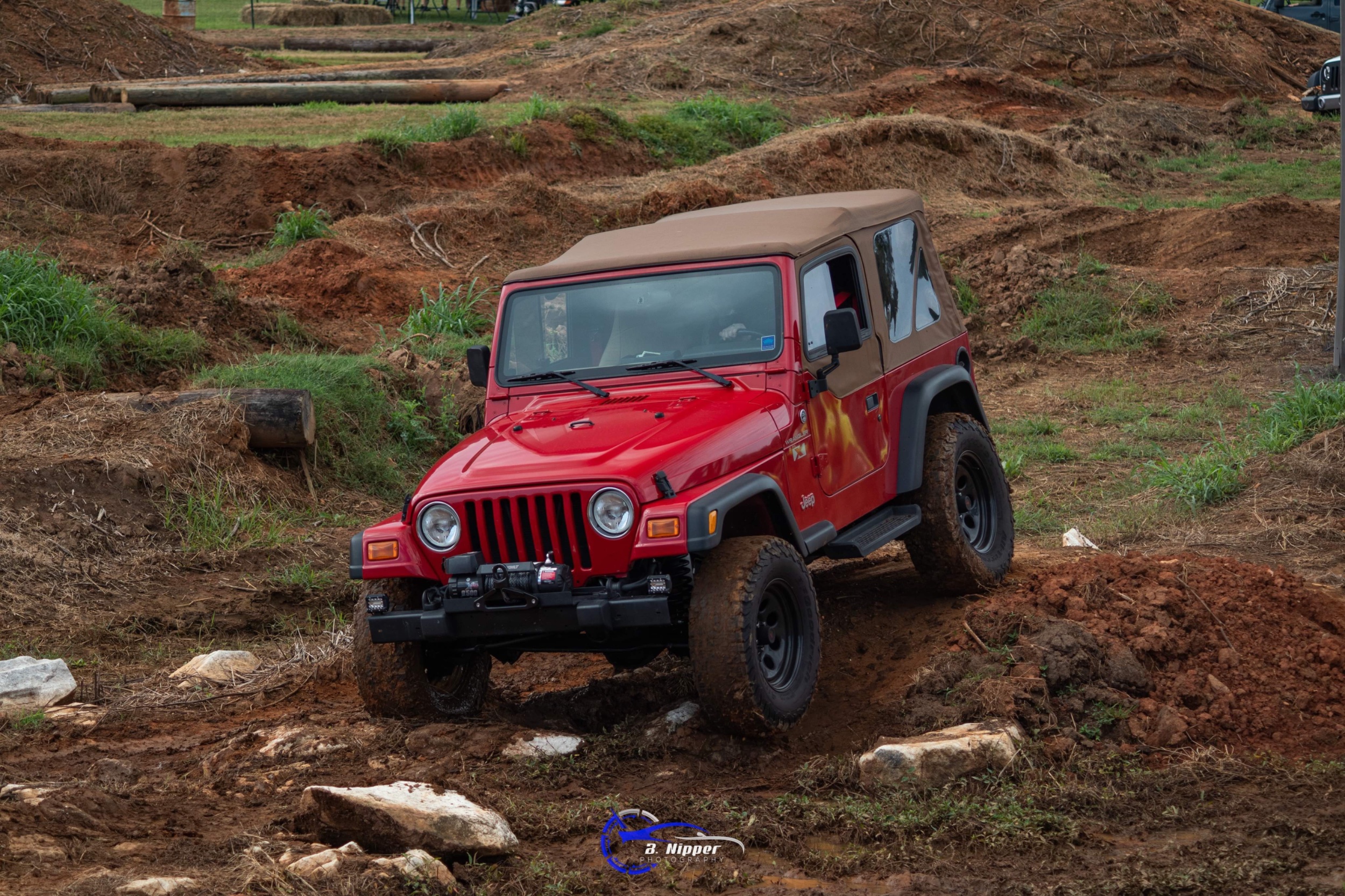

Here are a couple of pictures as requested. I expect that is the cleanest it will ever be while I own it.
The tires are a little long in the tooth, but good enough to get me started. I will be seeking tire suggestions very soon. They are 35 12.50 15 and I will stay with that size.

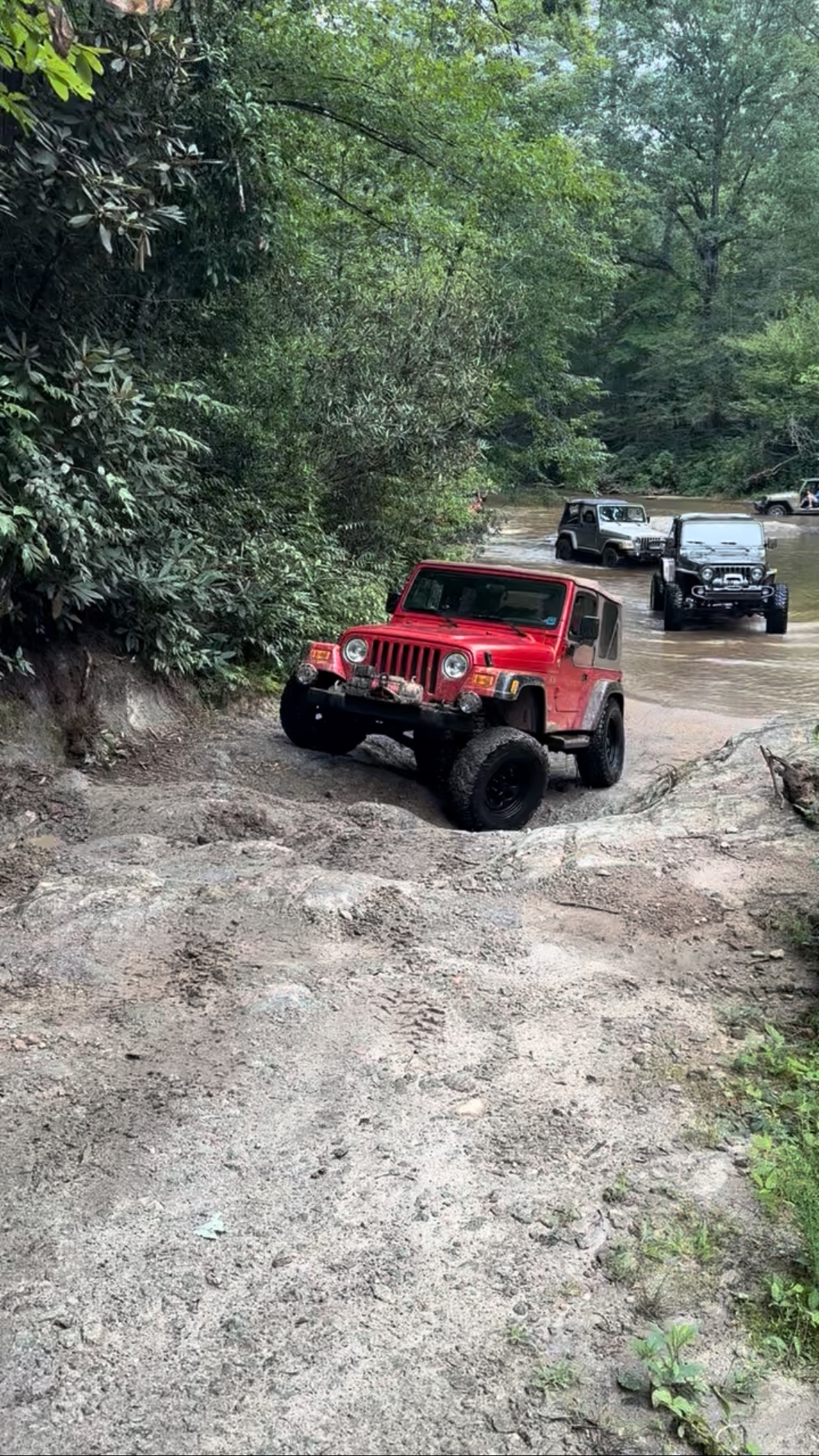

Not much of a picture, but I got it dirty today. Went to Barnwell Mountain.
I wish there would have been someone to document some of my obstacle conquering with pictures. This Jeep does incredible things. The I6 has really wonderful torque. The torque and the lockers pulled me over stuff really well. It and the lockers almost worked too well when going over some big rocks and it wheelies up from a bounce and the grip from the rear wheels pulled up the front in the air just about before I could get off the throttle. At least that is how it seemed. The manual transmission was fun and worked well for me.
