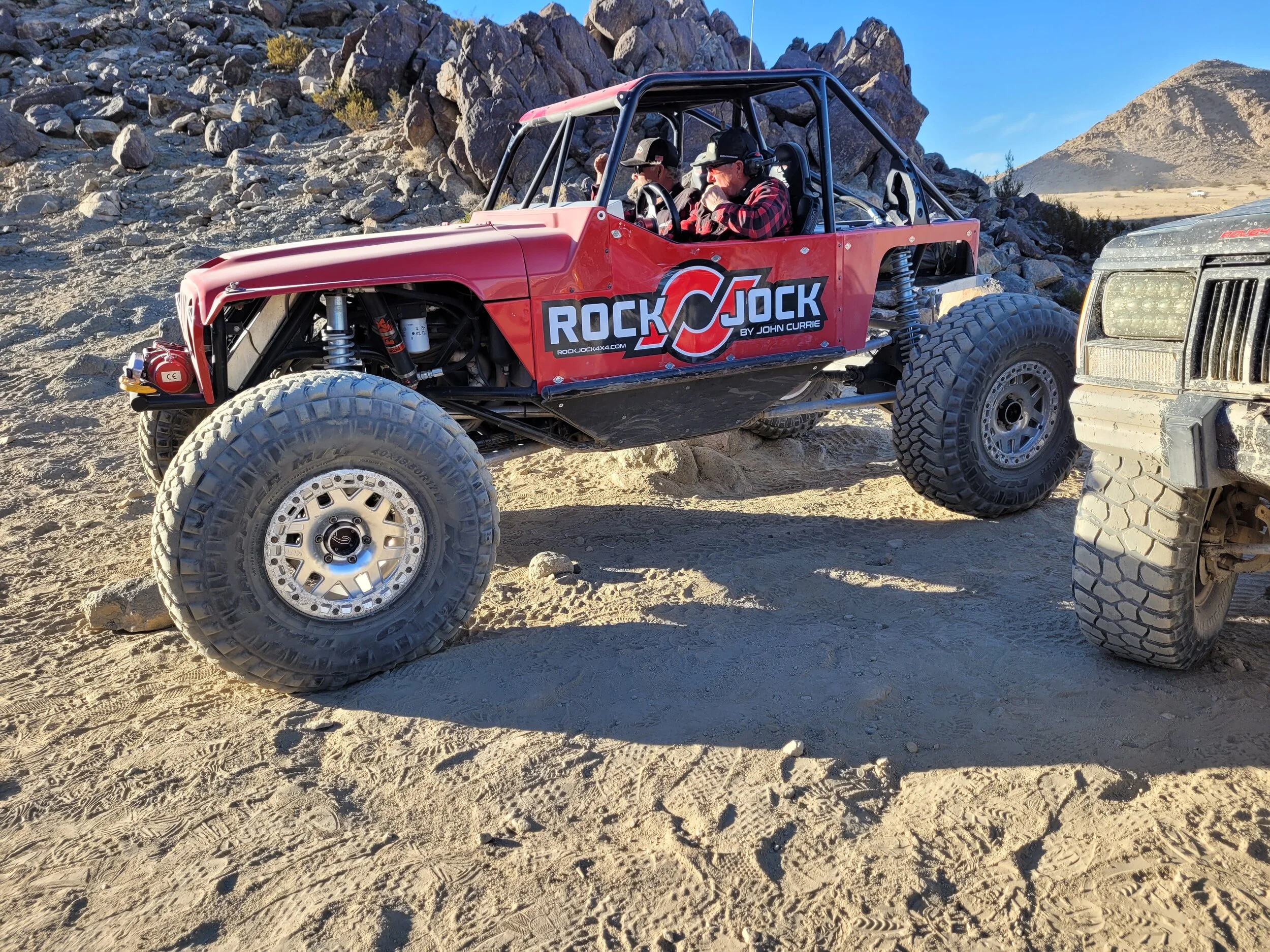

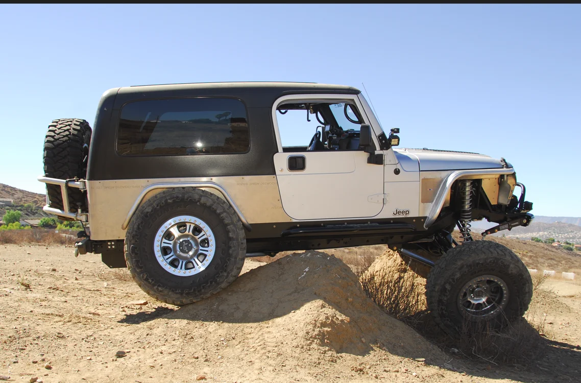

This is what is being referred to as a "subframe" in this thread. Yeah, that style - to which the links get attached, with a "ramp" on the sides, with all the talk that comes with discussing that style of suspension.
