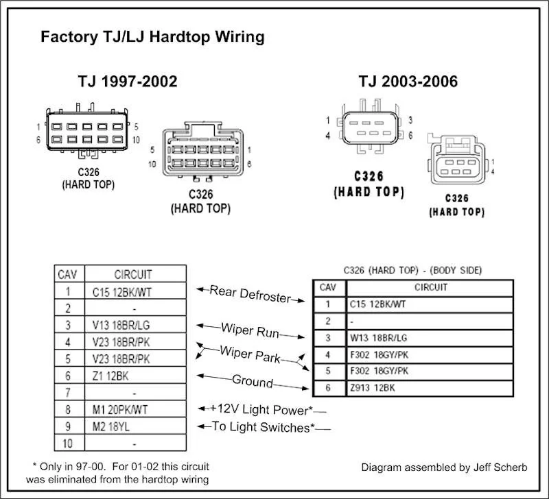

If OP's Jeep is a factory hard top model and wants functional rear wiper/washer and/or defrost, he'll have to buy or make a conversion pigtail harness. If OP's Jeep isn't a hard top model and he wants full-features, he'll need the washer solvent jug w/ dual pumps, body harness from pumps to switches, to back of tub, pigtail harness, and the switch bank. OP might be able to find a Mopar retrofit kit, otherwise it's finding used parts.
