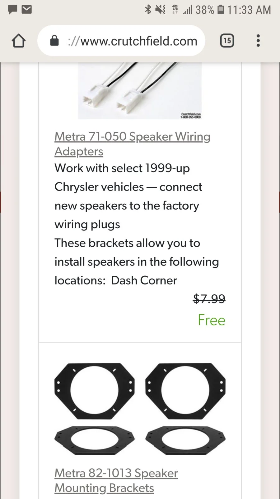

Any reason you do not want to order from crutchfield? They have free shipping for orders over $35, and they send you free mounting brackets (for the 5.25") and wire adapters. Also, same price and good customer service.
I would order from crutchfield but I already have the adapters and i was ordering other stuff from Amazon, so i thought it would be easier to get everything from the same place
makes sense, but free brackets and harnesses can be sold to other people so you may be able to make a couple bucks back and reduce your overall cost. I sounds like a Crutchfield salesperson!!!
