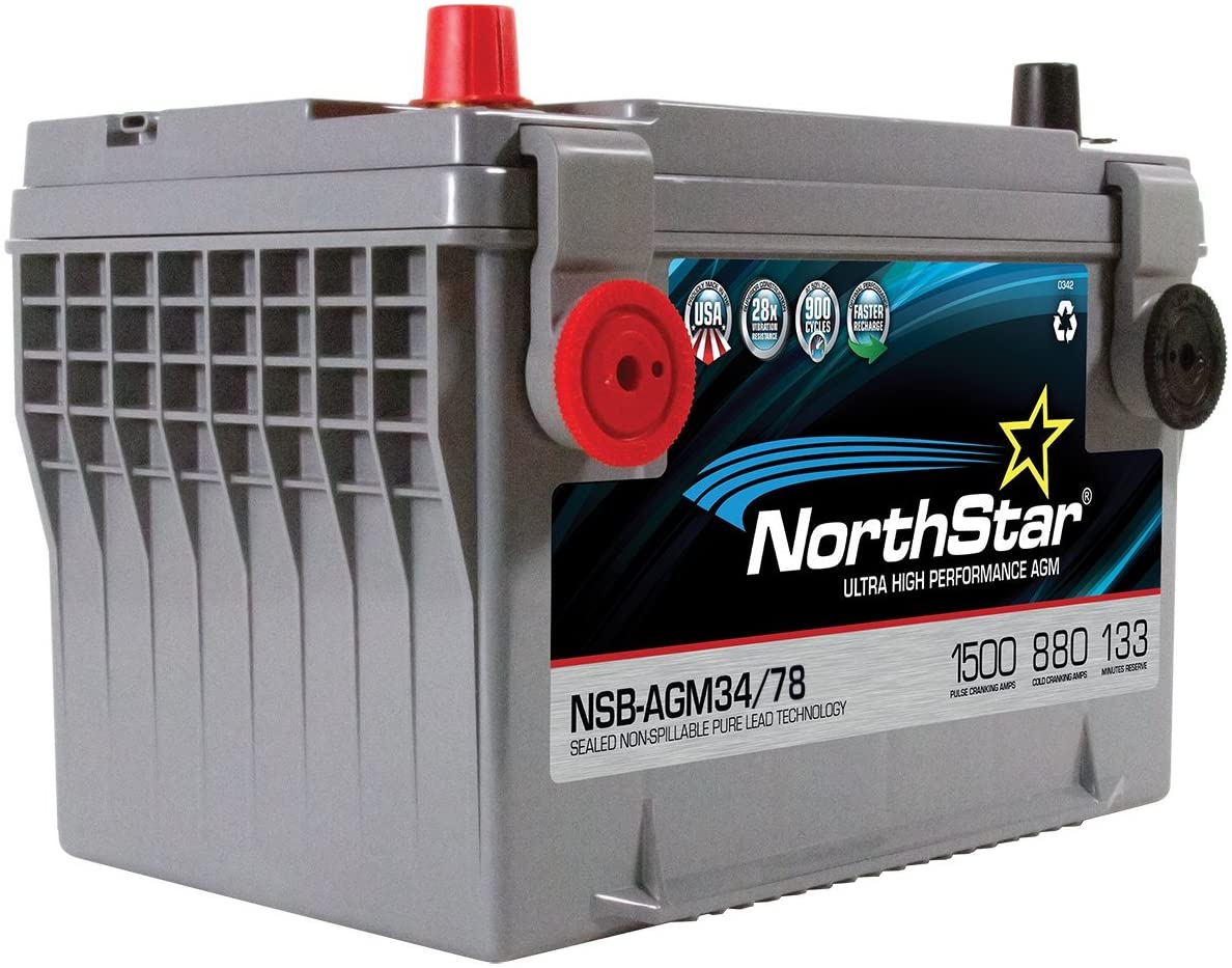

Find room to attach directly to the battery. There are many different clamp styles that allow multiple attachments.
Some batteries also come with multiple terminals.
A common one you’ll see is the Group 34/78, which has terminals in the top and on the side.
I prefer the Group 24, which has higher capacity and can be bought with additional marine terminals:

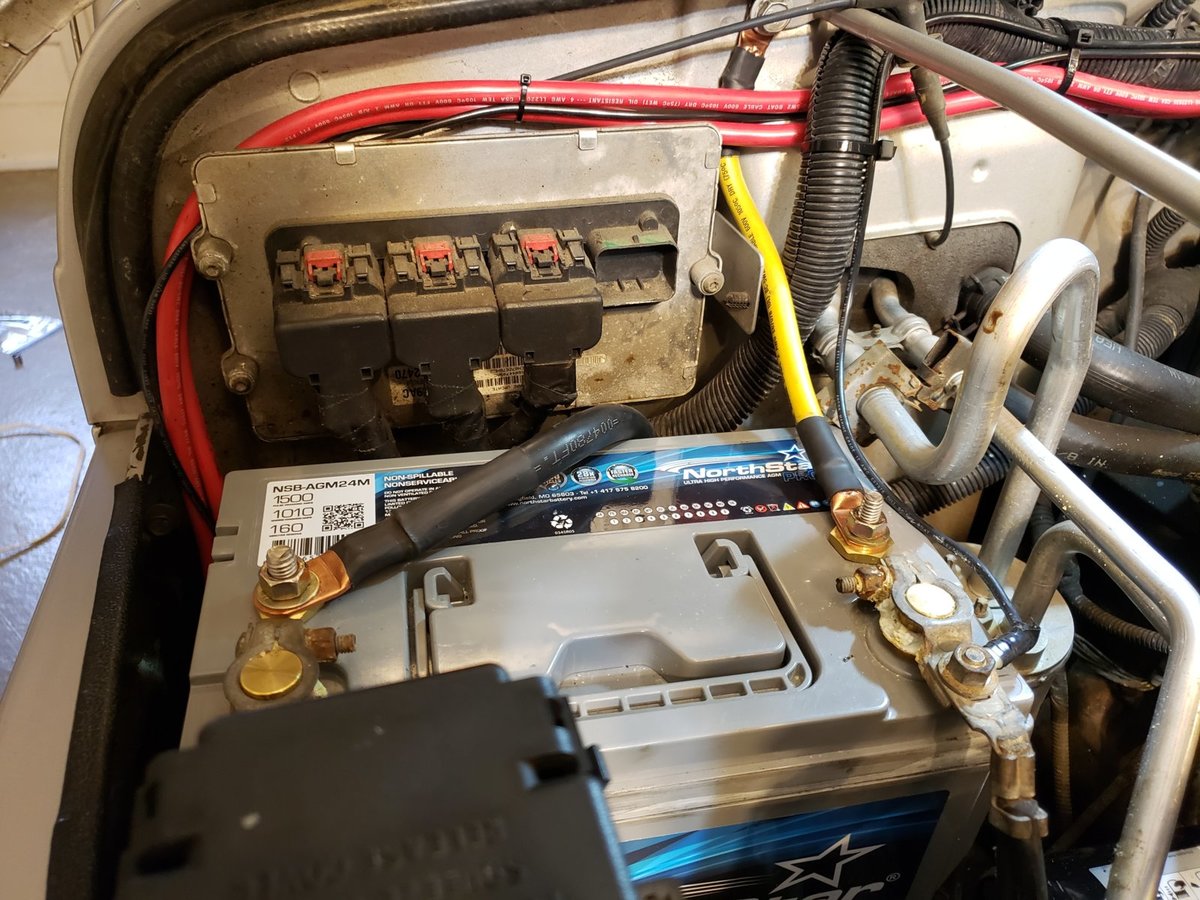

I used a ~10 inch piece of 2 AWG from the battery negative post to the back of one of the radiator supports, as seen in this photo: (yellow wire)
As for your other electronics, I don’t think you need to yet, but it would be a good idea. An LED light bar usually draws 30 amps or less. A starter around 150-200 amps. A winch near its stall speed can draw in excess of 500 amps. So if you choose to ground the winch to the frame, you will absolutely need to upgrade the grounds to the body and the frame. Otherwise you should be fine for now.
