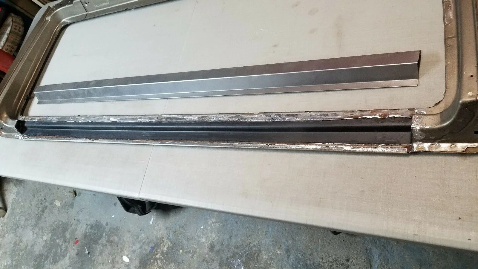

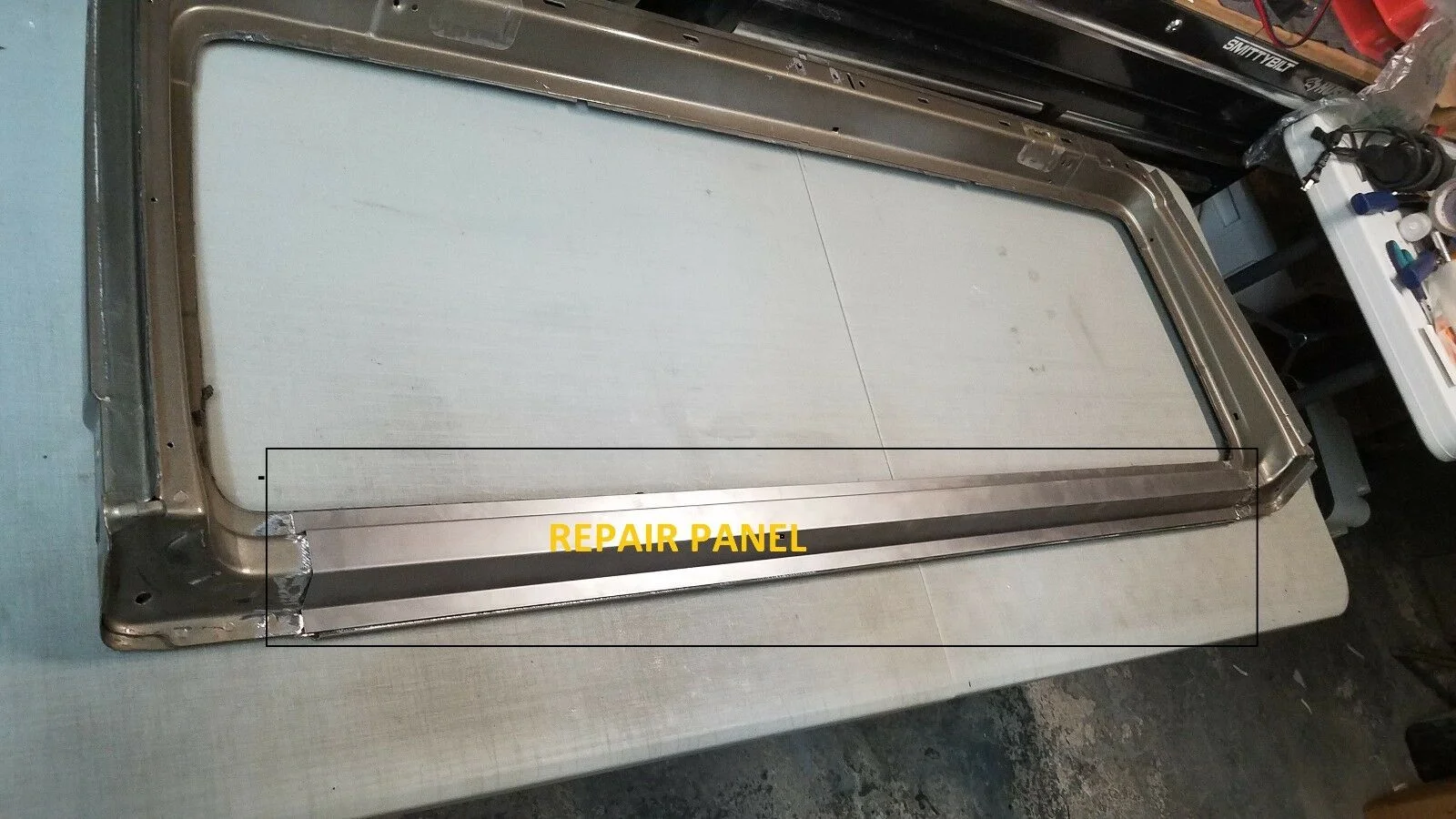

First I cut out the bad spots, then I bought a repair panel for $70 bucks on Ebay, problem solved.
Some cut out the whole bottom, I kept the solid parts after treating those areas. Below are photos of what others did.

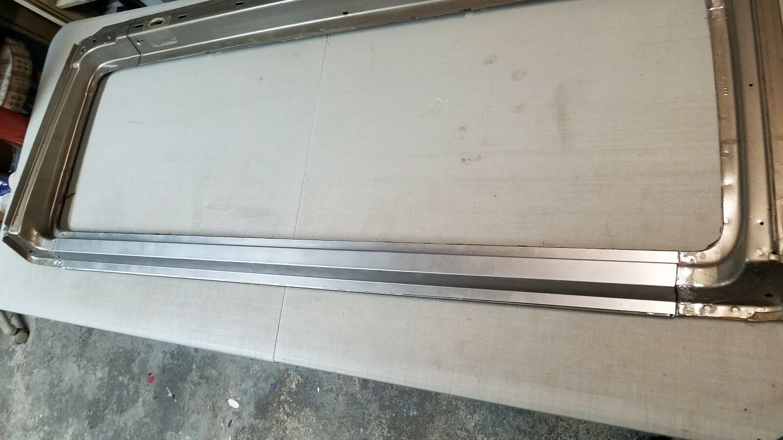

Wow dude what a solid idea. My rust looks minimal and I’m sure this is the route I should take. Do you have the link for this part or model #? If I can find one - you’re a life saver.

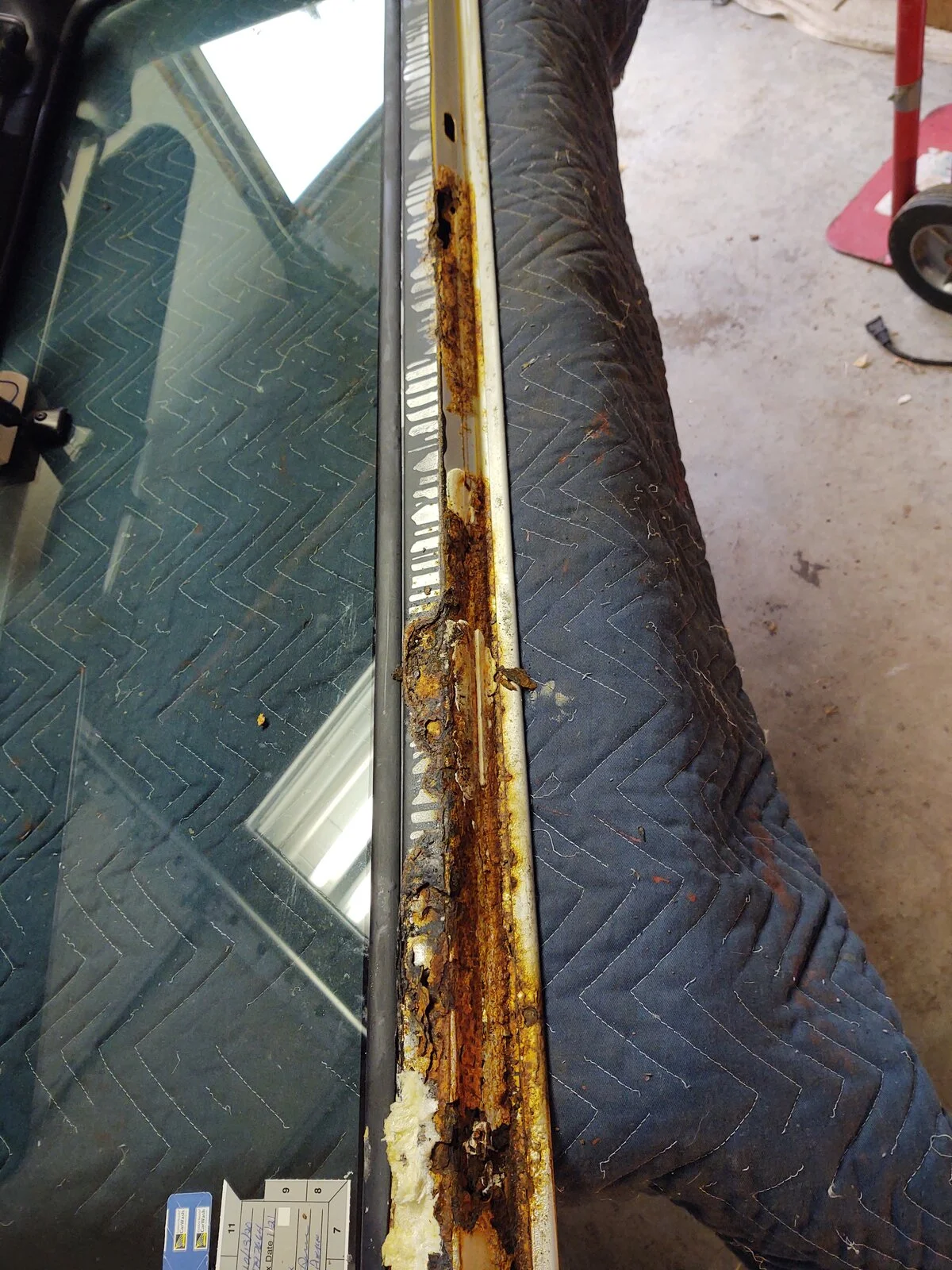

As an example of how bad it can be, here’s a pic of my 04
