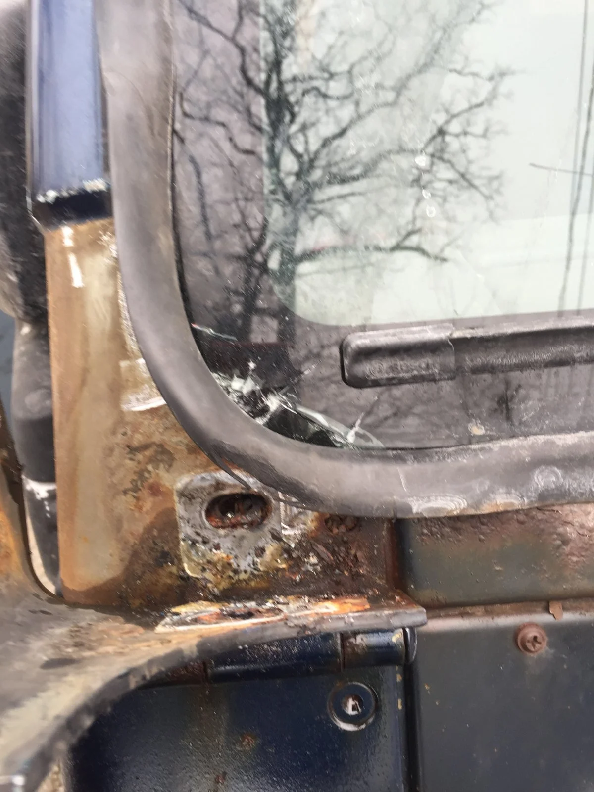

I’m putting a whole new frame in so maybe I’ll just completely drill them out...damaging the old frame and get new hinges.

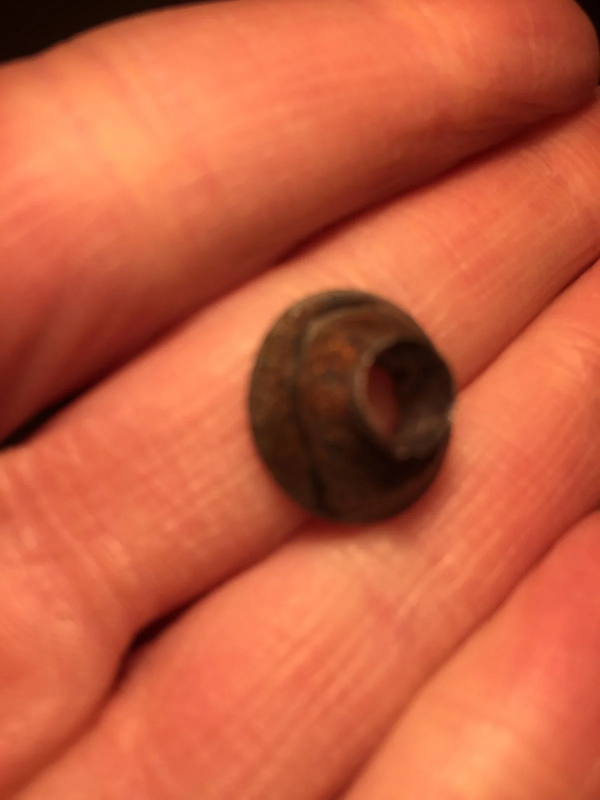

I heated them again today. Nothing. Broke an easy out into one of them. And the impact driver still didn’t budge them. So because I am replacing the entire windshield frame any way I just drilled them completely out. Many thanks to everyone’s suggestions. I will be trying those when I attempt to replace the hinges and the tailgate.
Some picture of how badly rusted the Torx heads were and the awful state of my old frame and windshield.

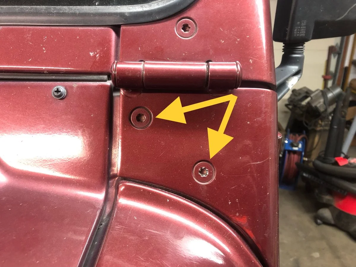

This may sounds silly but I had the same issue and rather than screw up the paint by using a torch I took a high heat soldering iron and held it in the torx bolt recessed area for about 5 minutes. It melted the locking agent and the spun the bolt out easily after it was good and hot.
Reactions: Tray Burge and SGTJ
