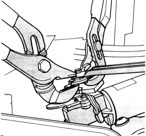

I removed the cowl panel and looked at the wiper motor. the arm on trhe motor has a synthetic ball on it. the arm on the wiper transmission has a socket. The wipers must have been restricted when I turned on the key causing the socket to pop off of the ball. I cleaned and greased things and snapped it together.
