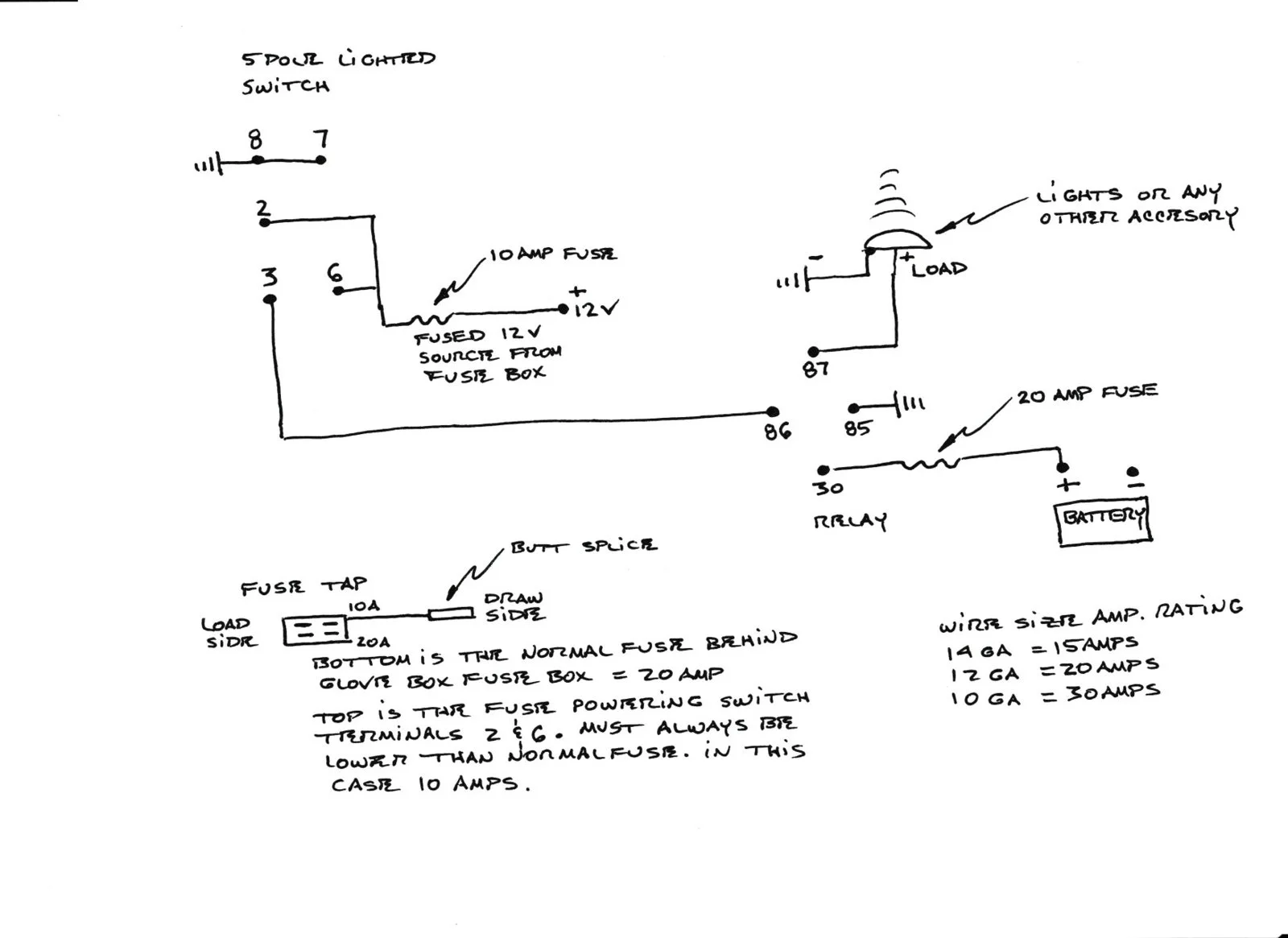

Wiring a five terminal lighted switch
chino1969
Apr 14, 2019
1,217
Oxford, PA
Here is how to wire a 5 terminal toggle switch for driving lights, aux. fan, etc.. Not for heavy draw like a winch. As brought to my attention by another electrically savvy individual it is a 5 terminal switch and not the 5 pole switch I printed at the top of my dwg..
