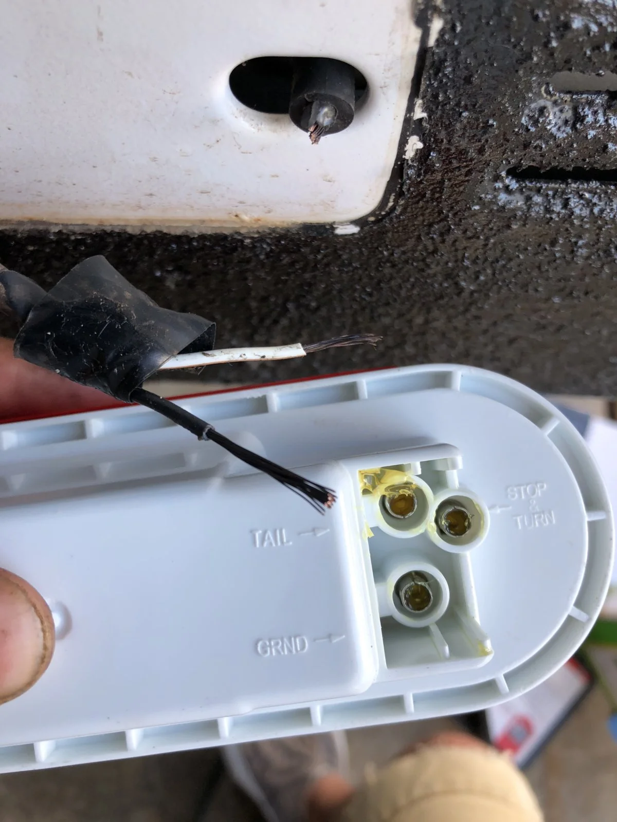

I’m not good with wiring but PO delted the third brake light which I need to pass the Recon inspection in Honolulu, could anyone tell me how to wire this thing up so I can register my jeep?
I have one of those for a third, you don't need the super bright. You can just use "GRND" and "TAIL" to light it up. Just use a voltmeter to check for power when you have a friend press the brakes and use them that have power to make light. Probably black for "GND" and white for "TAIL." You don't need the "STOP&TURN" unless you want super bright, then use "GRND" and "S&T"
Reactions: ScottyD
And if that doesn't work, reverse the colors. It won't harm the light.
Also, you can use crimp-on bullet connectors for that light or just buy the correct pigtail for it.
