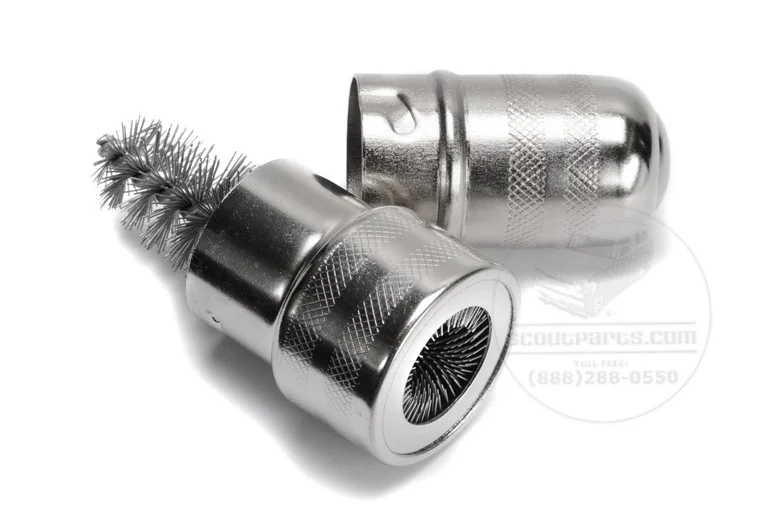

Since it started with a jump start, the starter wasn't getting enough power from the battery. Thing I'd do is physically remove both battery connections and wire brush the battery posts and the inside of the battery connectors. A $4 battery brush like below does that job in seconds.
And make sure when you replace the connectors to get the nut tight enough so you can't move the connectors around the battery posts with even considerable hand pressure. If you can't get them tight enough by just tightening the nut, the connectors or battery post has just worn. There's a free fix for that I can give you if you need it.
NO, don't just look at the battery connectors and think they look ok. Battery connectors can be clean and look pristine yet still cause the problem you just had. Get the energy and physically remove and clean them thoroughly with a wire brush. Don't spray anything on the connectors or posts while they're off.
