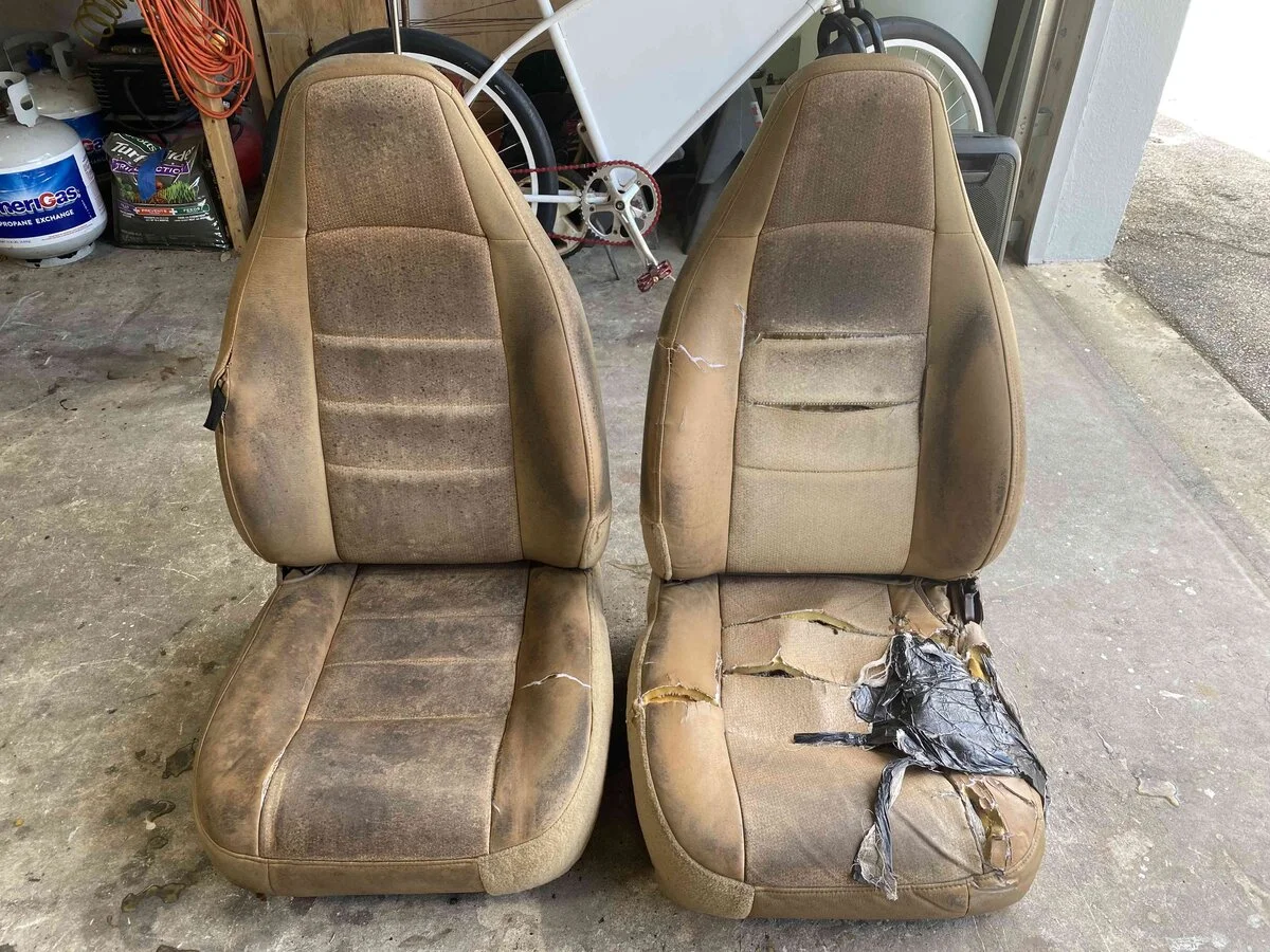

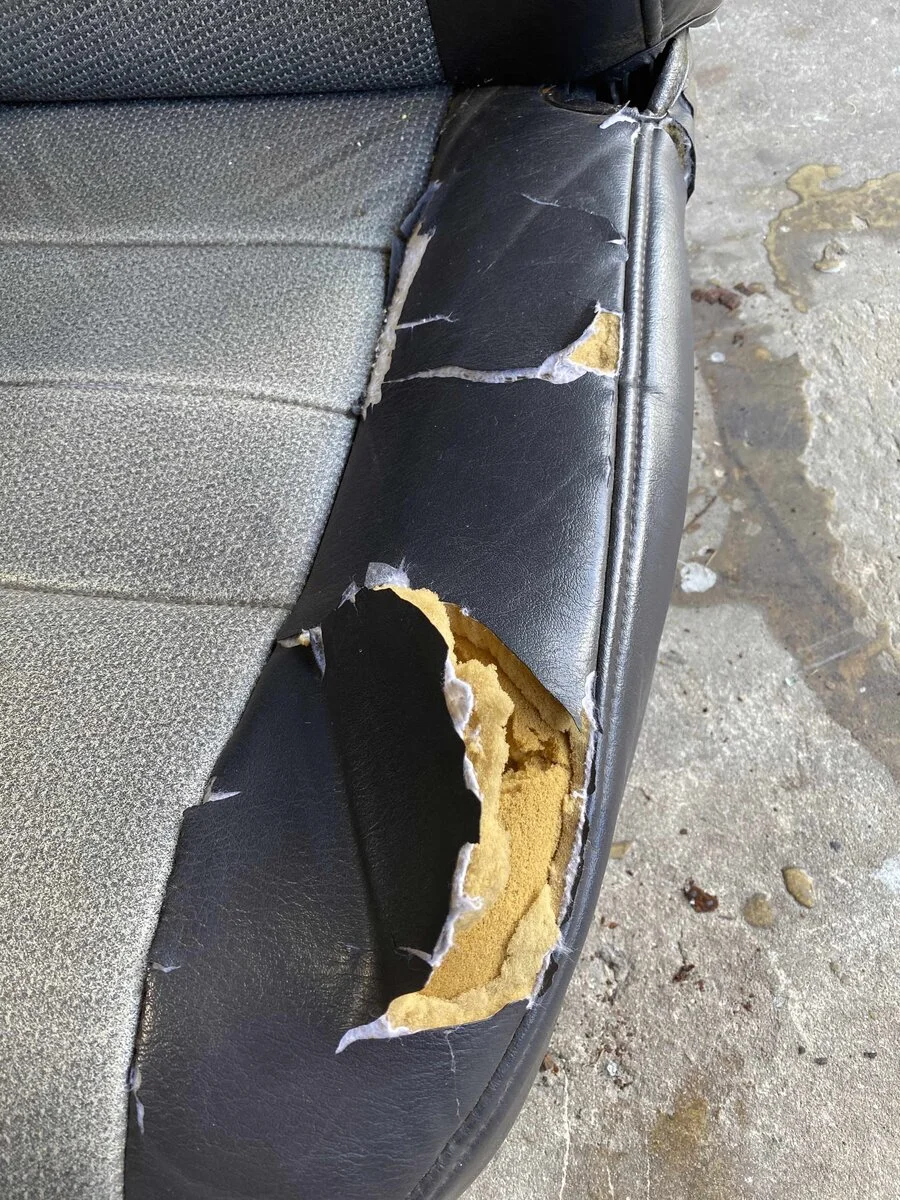

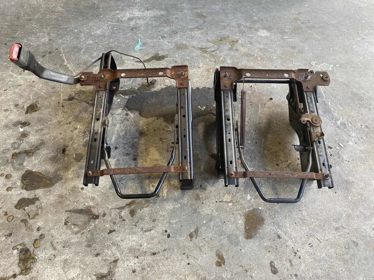

Hello friends. I could use your feedback. I am working on a 1998 Jeep Wrangler with my sons. We are replacing the seats. They are trashed (see below). I bought some other seats (2005 Wrangler) off of OfferUp. My plan is to:
  1. Clean up "new" seats
  2. Attach to old seat brackets
  3. Cover with these new neoprene seat covers from Rough Country.

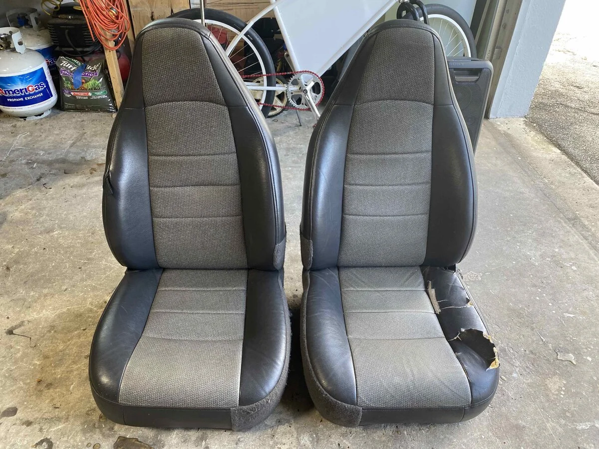

  • As you can see from the driver's side seat that I bought, it has a tear on the side. I got two different quotes to repair that before I cover the seats. They quoted me about $130 for the repair. This is too much money, in my mind, to just cover these seats afterward. Do you agree or am I wrong? What is a DIY alternative to patching this section of the seat before I cover it?
  • Should I be concerned about the rust on the seat mount brackets? If so, what would you do to treat them?

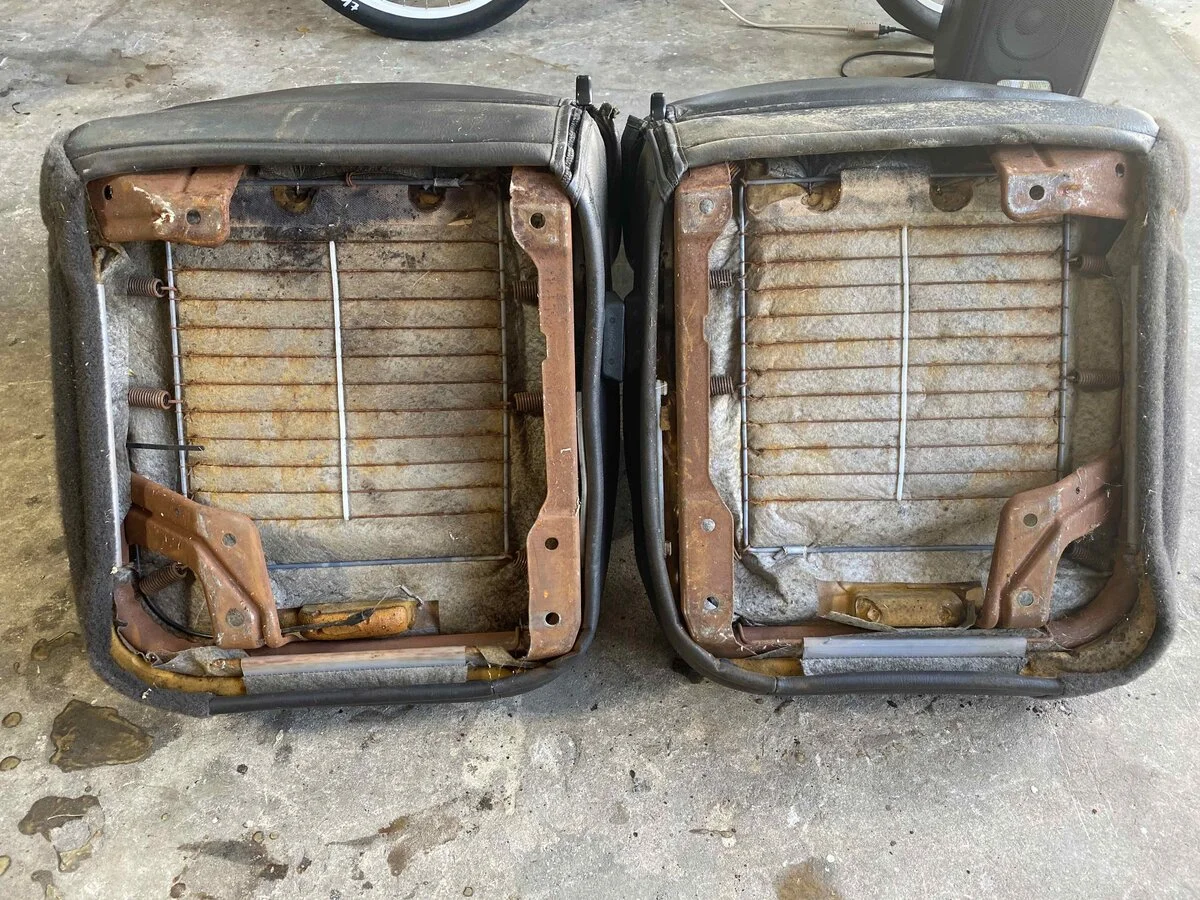

  • Should I be concerned about the rusty thin seat cables underneath the "new" seats? The old seats were missing most of them because they were so rusted out.
Personally I would do it. They also repair the seat itself, which means they’ll fix the padding where the split is. Leaving the padding the way it currently is will cause it to deteriorate even more, causing more rips and tears in the seats. IMO $130 doesn’t seem like a bad price.
By the way, those are early-style TJ seats from a 97-00, which isn’t a bad thing. The early TJ bucket seats are extremely comfortable.
It’s just surface rust. In terms of integrity they’re fine, but if you’re OCD just hit them with a wire wheel and spray paint them.
That’s something you’ll have to determine. As long as they aren’t exposed to crazy amounts of moisture and they’re holding now I’m sure they’ll be fine. My guess is they sat outside in the weather. This is something an upholstery shop could fix for you as well.

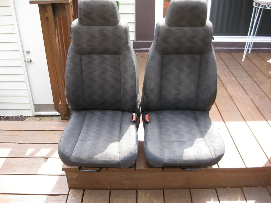

There are a variety of seats that fit. Hyundai Tiburon seats are a relatively easy mod, and XJ, ZJ and WJ Cherokee seats also fit the TJ brackets, (or maybe XJ and WJ seat brackets fit the TJ floor, I can’t remember). I really like the XJ seats and they’re plentiful in wrecking yards, at least they are here.
https://wranglertjforum.com/threads/how-to-install-hyundai-tiburon-seats-in-a-jeep-wrangler-tj.2997/
Again, if you keep the seats you just got, you need to have the foam repaired or it will spread through the seat like cancer.

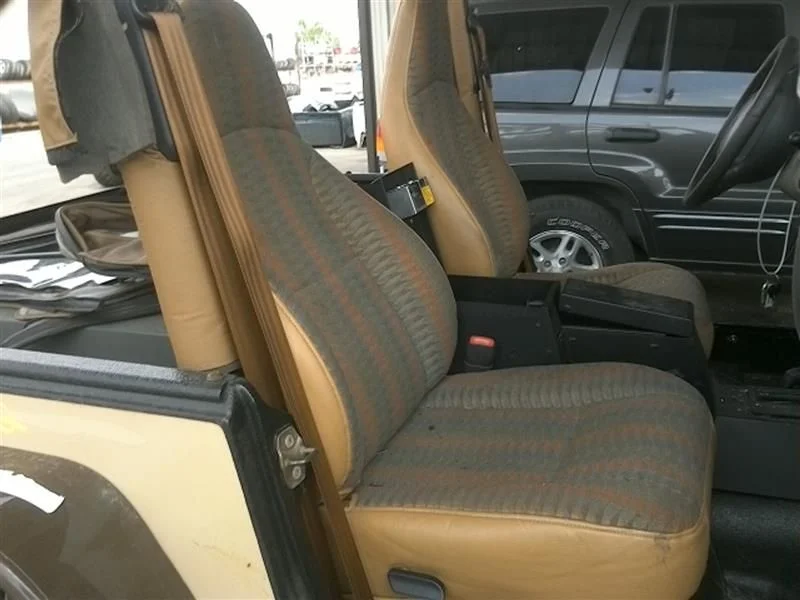

Those aren't seats out of a 2005. 03-06 seats look far more modern. And are far more comfortable IMHO. These are 03-06 seats. They're a direct bolt in (even on a 97-02 or a 03-06.) if you use the 03-06 brackets.

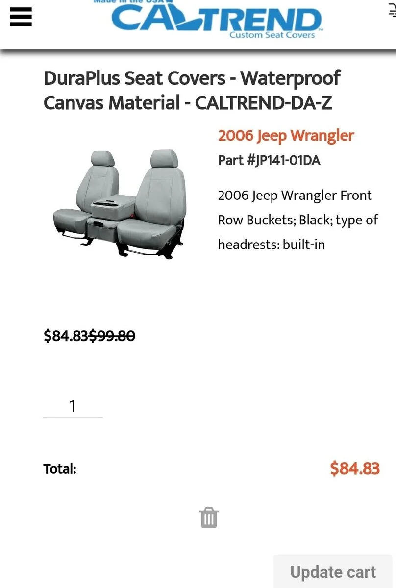

https://www.carid.com/caltrend/ I don't know why this link says security check. It's a direct link to the Caltrend seat covers we've all been talking about in other threads. Weird. @Chris ?
I wouldn't spend my money on repairing those. You can get a set of nice ones for $125 or whatever you said the repair was going to be.
Must have been different options for seats. I have an 06 LJ and my seats don't look like this. They look closer to the black and gray above.

Go to a later model seat or get some Hyundai from salvage.
I popped (with cutting and welding) some late model manual BMW leather buckets w/ adjustable bolsters for a $120(for both). They are still on the market and the Atlanta dealership lists them at over $2k each!
I would just put some good Duct tape on that tape and add the seat cover. Looks to be surface rust. Hit with a wire wheel and then some paint. Good to go. I wouldn't use neoprene covers. A good nylon or poly will last longer and look better.

Also, if you get the vinyl repaired vs. covered, or go with the gray seats w/o covering them and don't want to get worse, or don't want it to get worse under the cover, I would get something to help you take any extra "butt drag" off the seat edge when getting in and out. I have a 2" lift and my nerf bar side step is so close to the rocker panel it's useless for getting in and out. After 19 years, there is finally a split in the vinyl and I think it's from all the "butt drag" of getting in and out of a Jeep with a lift without using a step or grab handle to take some weight/drag off.

Eric — let me tell you what I would do if I was in your situation with my Jeep to give you some ideas:
On the gray seats, after getting that $120 quote, I would probably think "I don't want to pay $120 AND pay for seat covers, I'll be covering the repair anyway."
Then I would get some gaff tape also known as gaffer's tape, it's the stuff used to tape down cables on movie sets and events and it leaves no sticky residue even when it gets hot. I've been using it on various stuff for years. It's kind of pricey, but you will find multiple uses for it. It's almost like a woven fabric, but tears easily to get it off the roll, but it's super durable. Great stuff. Then I'd do a really good job taping over the tears being sure to tape across in both directions, going plenty past them for support, etc. Really go ham on it. Be sure to clean the vinyl down and then rub it down with alcohol to make sure you get the best stick. Oh, and if a piece of gaf tap sticks sticky side to sticky side, toss that piece, you will never get it apart. lol
On the seat bottoms, I wouldn't be worried about the rusty wire supports. I would probably get the surface rust off the large parts that mount to the bracket that mounts to the floor, clean it down with 91% alcohol, then hit it with Rustoluem Rust Reformer then maybe a gloss black, but maybe not because no one will see it.
On the seat mounts, I would clean off the surface rust and do the same thing, but for sure spray it with a top coat of a gloss black if you want the factory look since you can see it. Painting is only as good as your prep work, and there are lots of threads here on painting things.

FYI: If you can't find what you want on CarID in the CalTrend lineup, go to the CalTrend site. They are running 15% off until June 30th. Discount prices in cart. Manufactured and ship in 7-10 days.

  • I decided to bite the bullet and get the seat professionally reupholstered. I did that because (1) I want the seats to be in good condition if we sell this Jeep to get another one, and (2) I was concerned about the foam breaking down further. The other ideas were attractive. Thanks Grumblebee for the recommendation on the gaffer's tape.

  • I placed the order for the CalTrend seat covers. Thanks Grumblebee for flagging the 15% discount on the CalTrend site. The CarID site inventory was limited so I didn't get it from them.

  • I have cleaned off a lot of the rust on the brackets underneath and will treat them per your guys instruction. I know it is a difference of opinion/personality but since I live in a Miami, I am trying to minimize the amount of corrosion I will have on it underneath.
