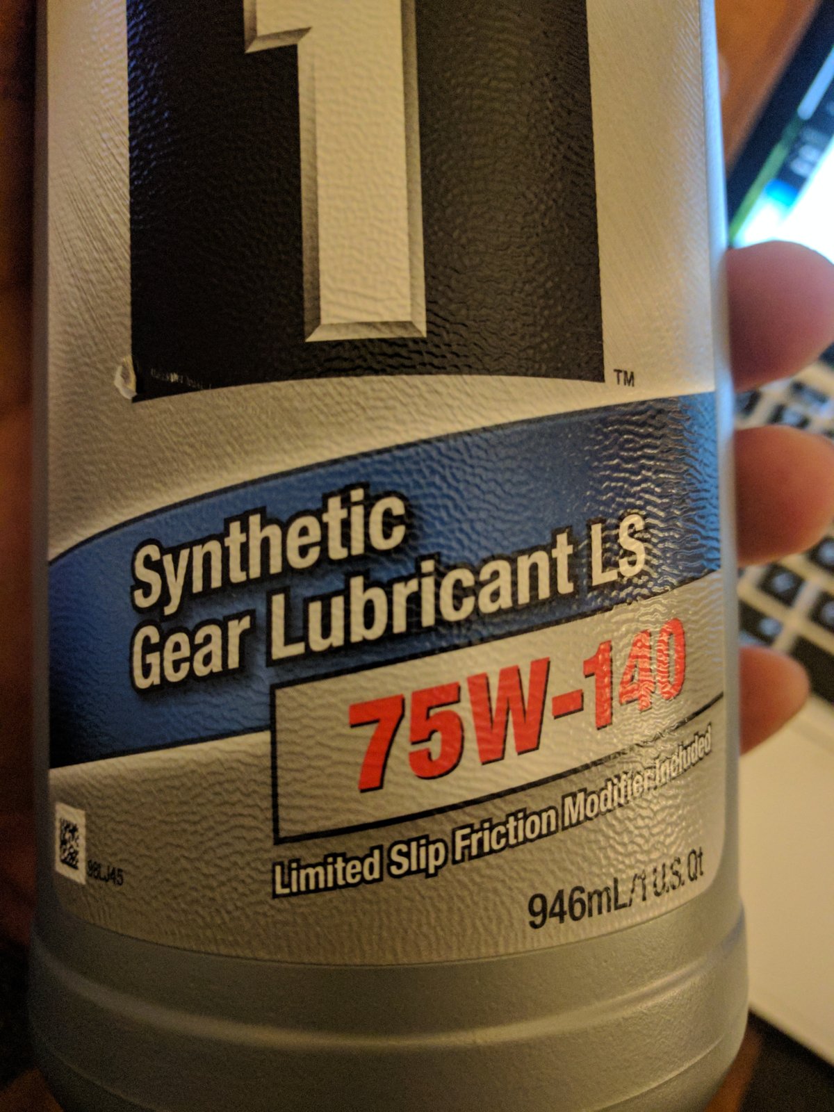

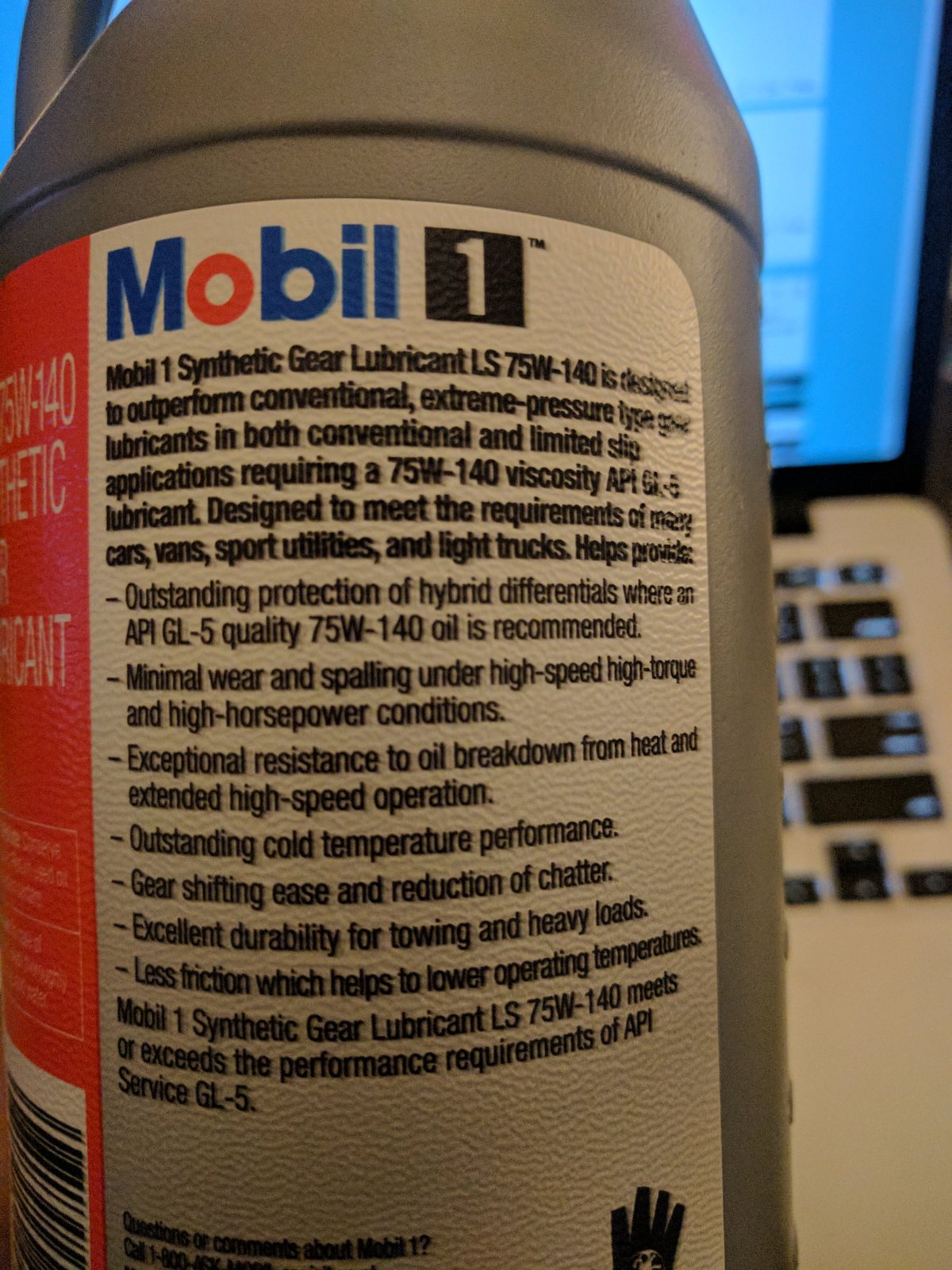

so question have a rubicon so it says friction modifier is not required. So i just click on the link to the Mobil 1 on Amazon and bought 4 quarts but i think they sent me the wrong thing which has Fiction Modifier included. Will it hurt anything if i use it? or should i return and get something else without it? has a different part number than what is listed on Amazon page
sorry for noob question. says works for conventional and LS. but first time changing diff fluid and don't want to put in the wrong thing

All 03-06 Rubis have a limited slip rear diff, in addition to the air lockers in both diffs. It does not require friction modifier, because it is a gear-based limited slip rather than clutch-based like the Trac-Lok available on other TJs. Doesn't hurt to use it if it's already in the oil, but no reason to pay extra to add it.
For those with a G2 DANA 44, they (G2) recommend 85W-140 GL5.
The exact viscosity doesn't really matter, they just picked one that would be easy to find that would cover most situations. Lower viscosities are fine for Jeeps that don't tow, higher viscosities are fine for Jeeps that tend to tow.
