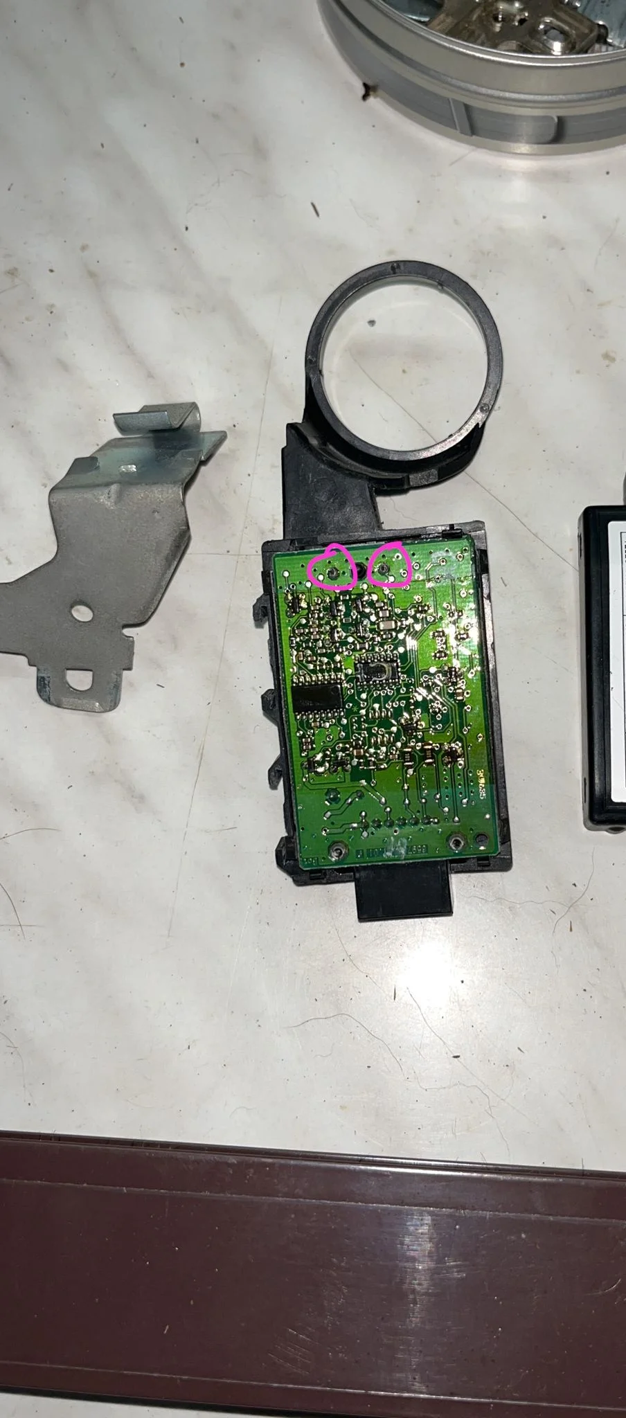

solved... the problem was another... base disconnected
