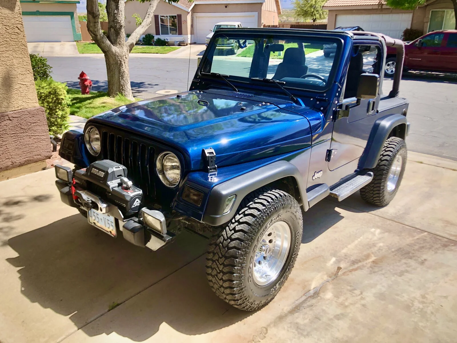

Would love to hear from those that have recently upgraded their stereos. Been researching for the past month, finding it overwhelming what one can do.
2001 TJ pretty much Stock. I do like to run without the top, not a lot of highway, mostly trail riding in the backcountry of southern Nevada & Utah.
Not looking for a "Wow" replacement, just a simple total upgrade with a $1000 budget.
1) Replace head unit with standard radio, playing tunes from a iPhone. No navigation, cameras, CD players required. I would like a volume knob though, those trails can get bumpy.
2) All front speakers & rear sound bar.
3) It did come with the sub in the counsel, but that was hacked out & missing from the previous owner. I would just like to place a simple powered self enclosed under the drivers seat.
4) Ive researched Crutchfields but having issues finding a self contained sub that will work, it says nothing is available for my model year.
I'm a bit confused on wether I need a separate amp or if the head unit I purchase would work...depending on what I get.
Thanks to those that take the time in responding with what you've done with yours.
