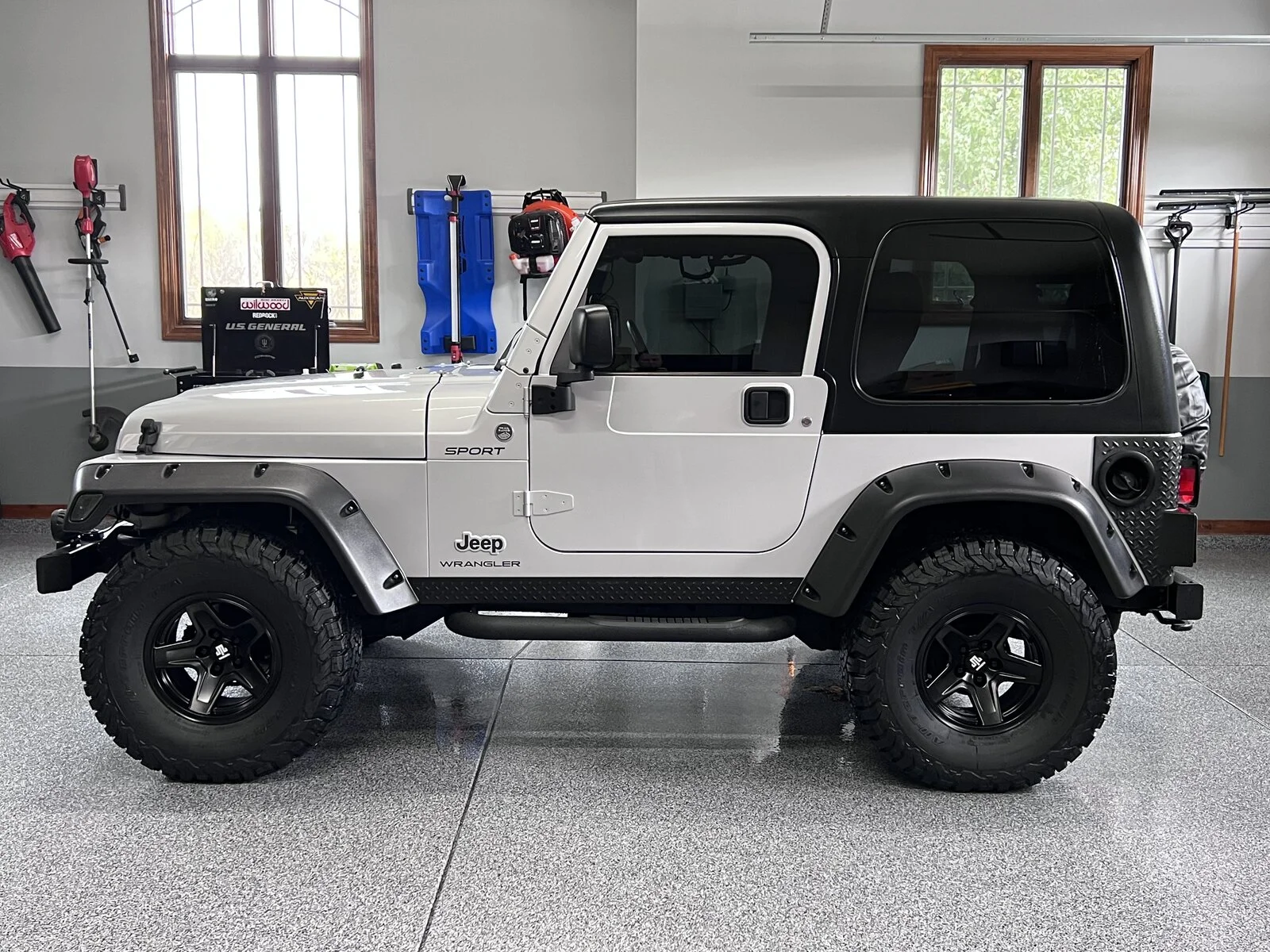

Sorry I can’t answer the stereo question. But I have to say it’s cool you’re allowed to park inside the house! I haven’t tried that since I got in trouble for wrenching on my Honda VFR 750 in the living room about 30 years ago😂.
edit: also, nice Jeep.

that garage is way too clean. you need more shit/tools. you only have enough when you cant get from one side to the other without tripping over something and its staked to the ceiling !
