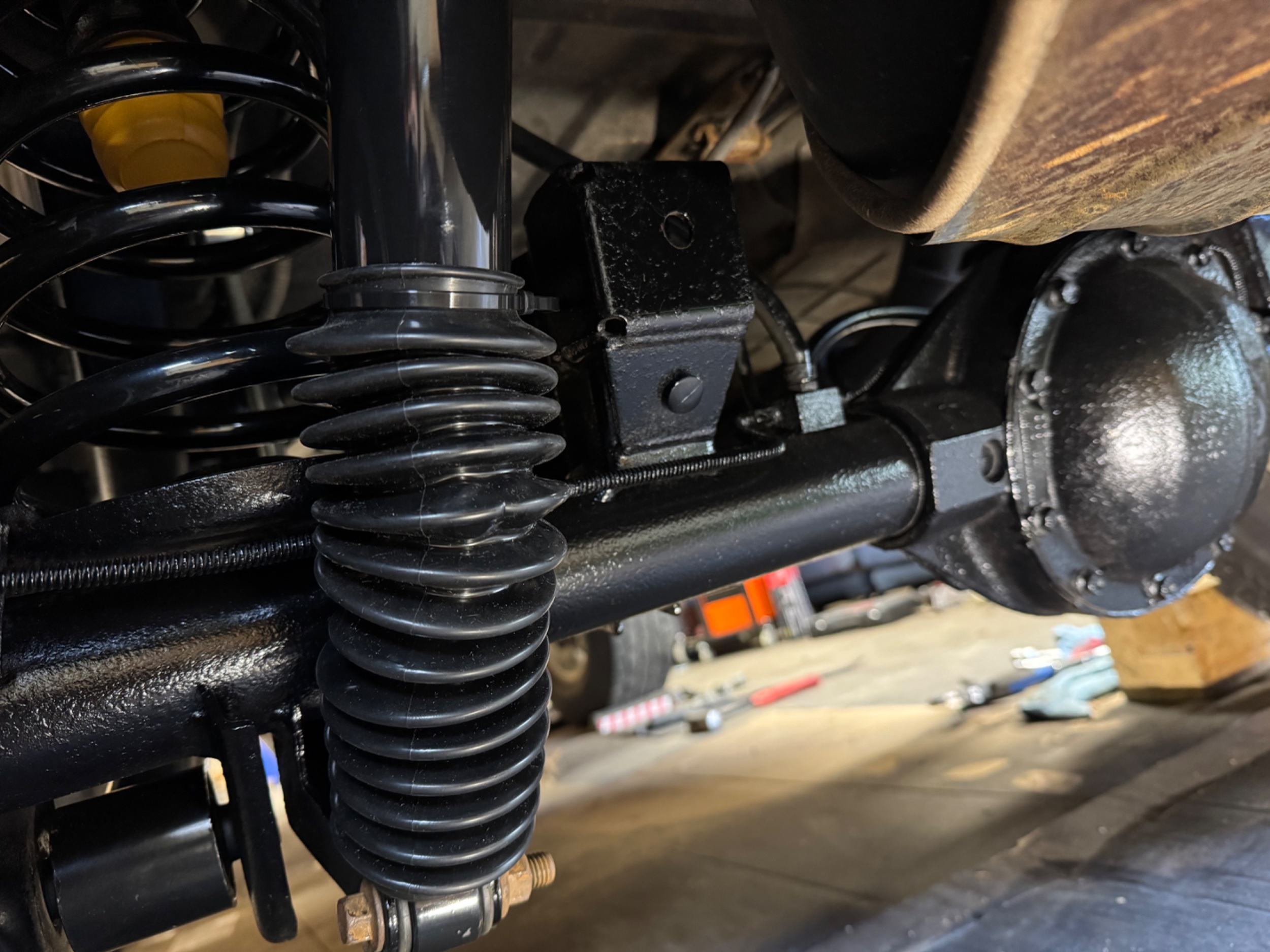

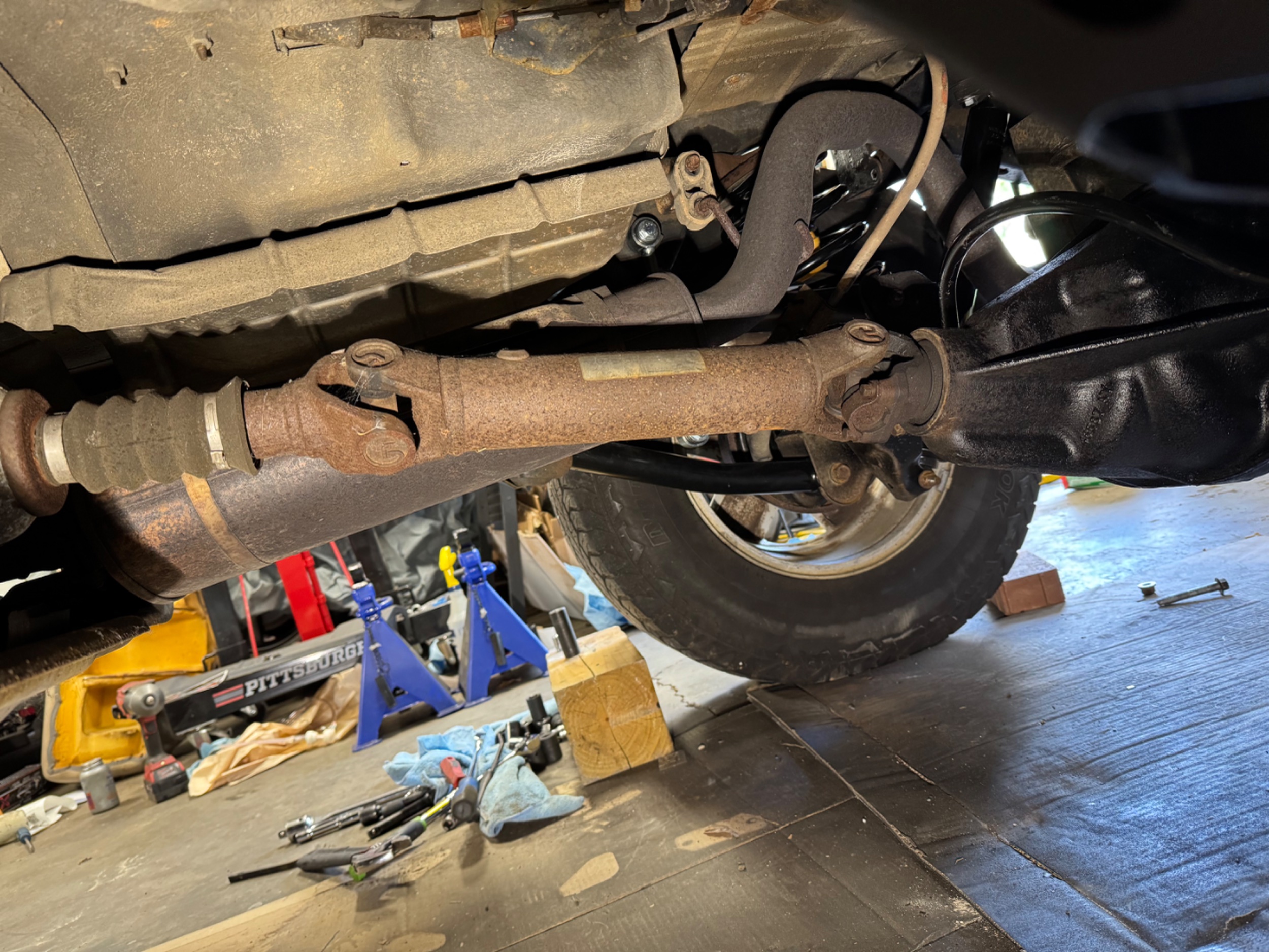

Okay here are a few pics. I spent the last 2 hours fiddling with that dang TC linkage. You know since I have the Savvy 1.25 body lift and the TC drop on top of it, no way was it fitting with the bracket they sent. I had to make up a mullet approved bracket to go with it. 😄

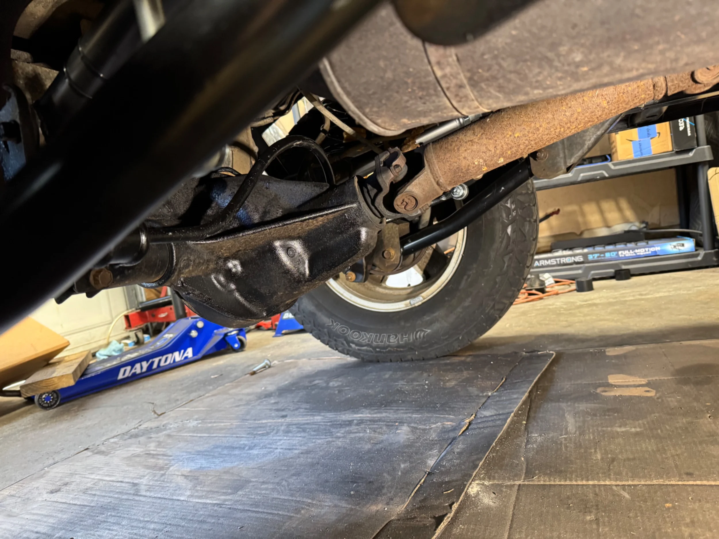

So….just an update on my progress. Didn’t get pics today. Got the JKS angled bracket installed. Did a test fit and it’s better but it would rub right on the tank skid. I ended up sawzalling the corner off to give clearance. I didn’t use the cut off wheel as I just didn’t have the Cahones. 😂
Didn’t get time to set it up, but I am about an 1/8 off on one side. So looks like ratchet strap in my future.

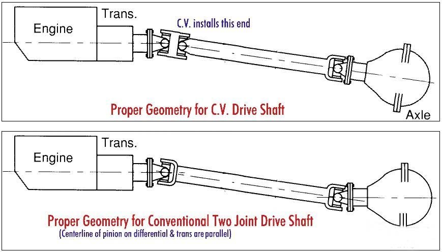

Still wondering why JKS has all over the instructions about not using that angled rear track bar mount on a stock slip yoke. Is there a chance the shaft will pogo stick out and hit a small child? What is the reasoning?
Because if you don't have an sye you need to keep ujoint angles equal. Ergo tilting the axle up is a bad idea without one.

So bad idea as in how? Wear out u-joints faster? Extra vibrations? Safety issue like I noted above where the shaft will fall out?
