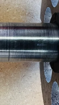

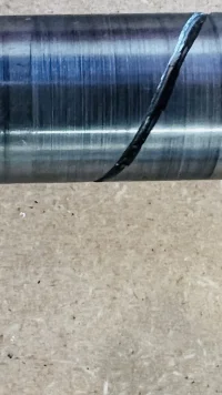

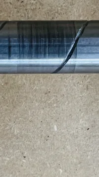

This is not good, Crown OPDA only 10K and shaft looks worst than the 100K it replaced.
